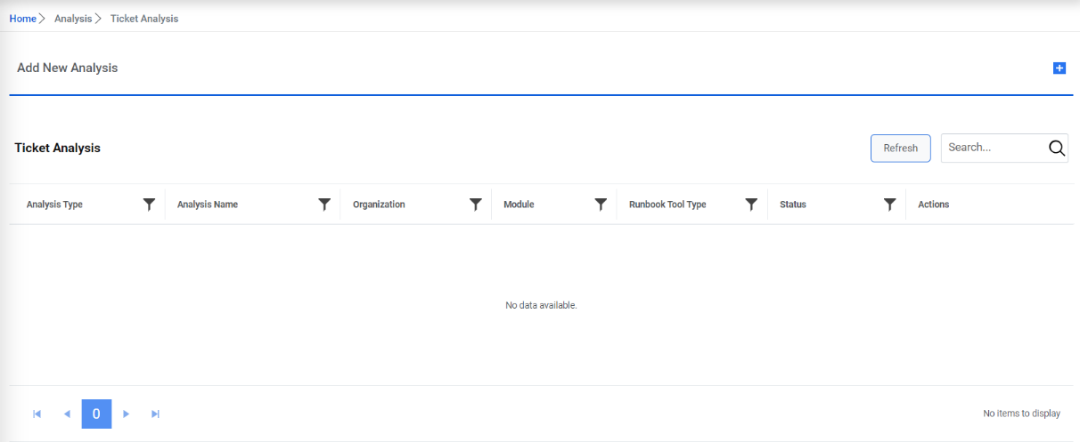

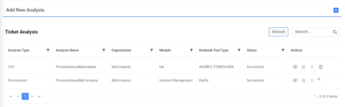

  1. On the main menu bar, click Analysis.
  2. Click Ticket Analysis. The Ticket Analysis page appears.
    Figure 1. Ticket Analysis
This lists the available analysis types in a tabular view and allows users to configure new analysis by using the icon, and view, build and approve, merge, or delete the existing analysis.

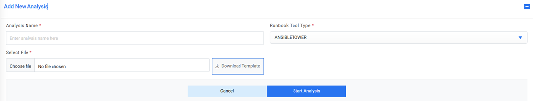

  3. Select the Runbook Tool Type on which analysis needs to be run.
  4. In the Analysis Name field, type the unique name for the analysis to be created.
  5. Click Download Template to download the CSV template for uploading analysis details.
  6. Fill the details in the downloaded template and click Choose Files to upload the updated CSV template.
  7. To start ticket analysis, click Start Analysis

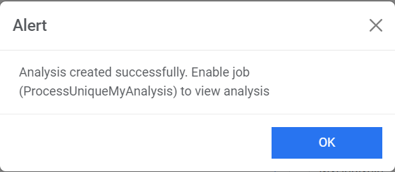

    On clicking Start Analysis, three new jobs are created. These are Unique Clustering, Unique Script, and Recommendation. The newly added analyses are listed in the Manage Jobs page.

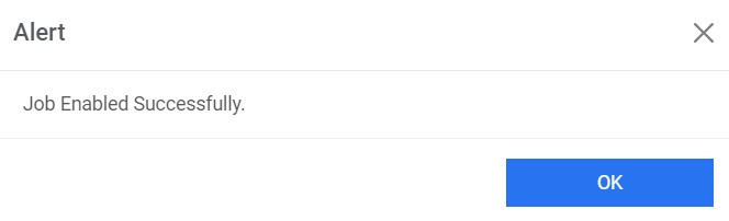

  8. To enable the job to view analysis, go to the Manage Jobs page.
  9. Select the newly added job for analysis with the status as Queued and then click Enable Jobs. The confirmation dialog box appears.
    Figure 4. Add New Analysis (Cont.)

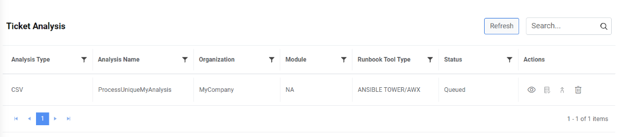

  10. This adds the analysis and lists it in a grid with the status as Queued.
    Figure 5. Add New Analysis (Cont.)

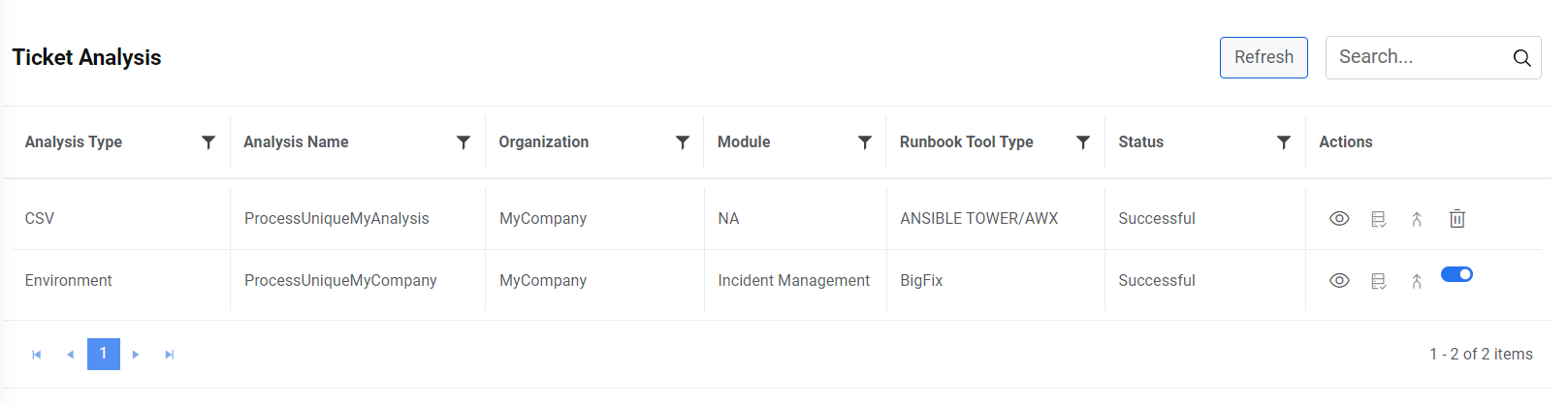

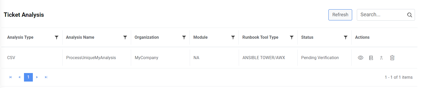

  11. Once the unique service starts processing the analysis, the status changes from Queued to Pending Verification.
    Figure 6. Add New Analysis (Cont.)
    An administrator user can delete any analysis from the list of ticket analysis by clicking next to the analysis type.
    User can only delete the CSV specific ticket analysis.

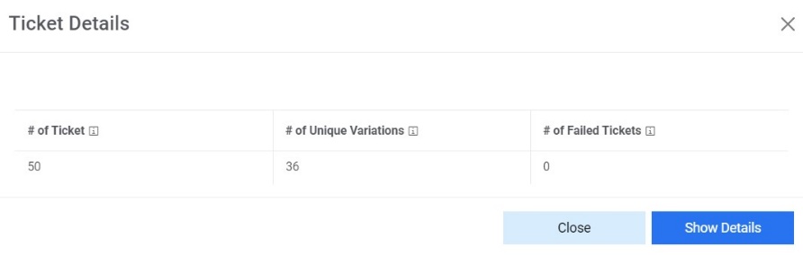

  2. The Ticket Details page appears where users can view the total number of tickets, the number of unique tickets, and the number of unprocessed tickets.
    Figure 8. View Ticket Analysis (Cont.)

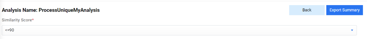

  3. Click Show Details and it prompts a window that shows the Similarity Score and the Canonical Summary for the selected ticket.
    Figure 9. View Ticket Analysis (Cont.)
    Use Export Summary to export the canonical summary of the ticket to your folder or click Back to go back to the previous screen.

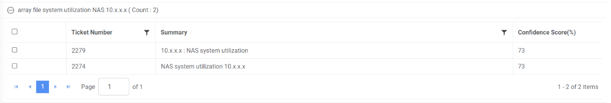

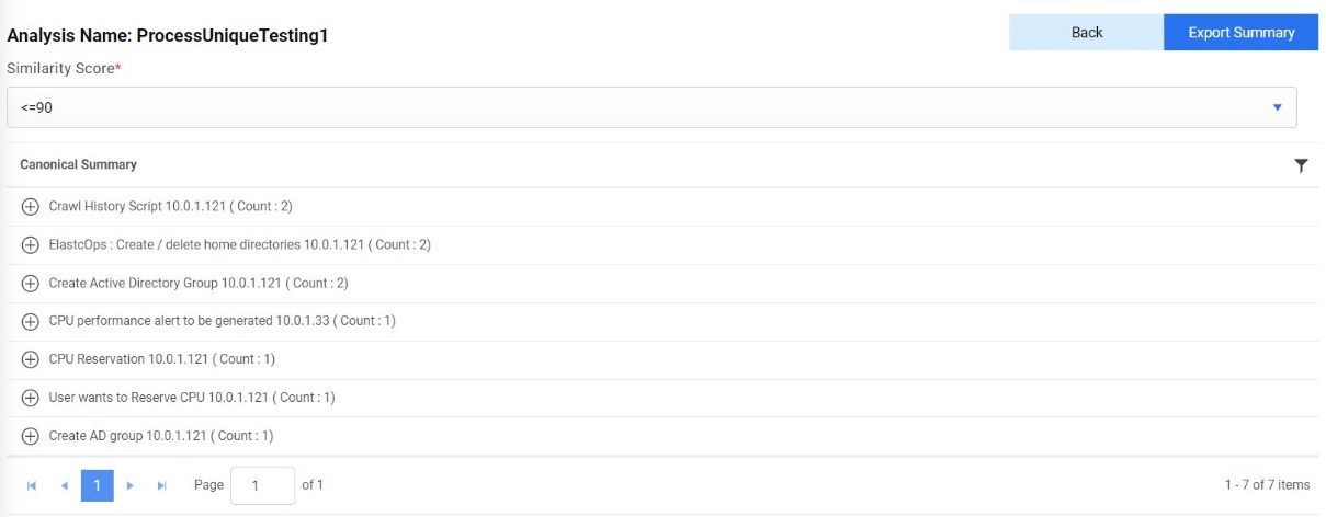

  2. On the View Ticket page, analysis appear in a tabular view under the Canonical Summary column, based on the selection of similarity score.
  3. Expand the selected Canonical Summary to see the tickets under the selected summary.
    Figure 11. Build/ Approve Single Analysis (Cont.)

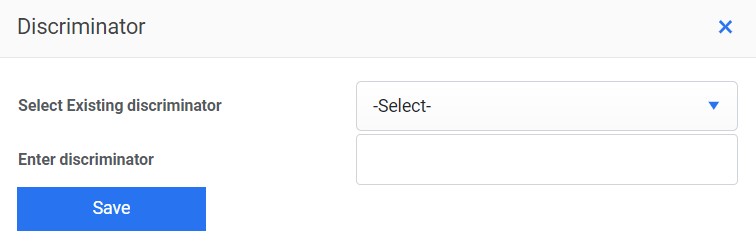

  4. To remove a ticket from the canonical summary, select a ticket or multiple tickets and then click Remove based on the discriminator.
  5. This prompts users to select the Existing discriminator , then type at least two comma separated discriminators to verify the uniqueness of the selected tickets, and then click Save.
    Figure 12. Build/ Approve Single Analysis (Cont.)
  6. This adds the new discriminator and lists it under the Discriminator column.

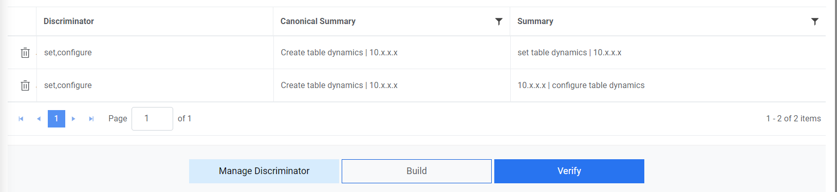

  7. To manage the added discriminator for analysis, select Manage Discriminator
  8. The Manage discriminator page appears and enables users to delete the discriminator by clicking.
    Figure 14. Build/ Approve Single Analysis (Cont.)

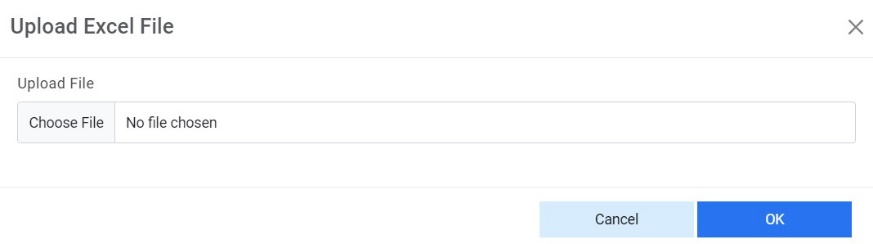

    2. Update the required details and then click Import and Build Analysis button.
    3. Click Choose file to upload the CSV file and then click OK.

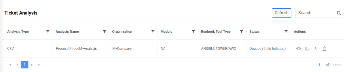

  10. After the discriminators are configured, click Build to restart the ticket analysis of the selected tickets cluster based on the newly added discriminator. This displays the Ticket Analysis screen where the ticket analysis status changes to Queued (Build Initiated).
    Figure 17. Build/ Approve Single Analysis (Cont.)

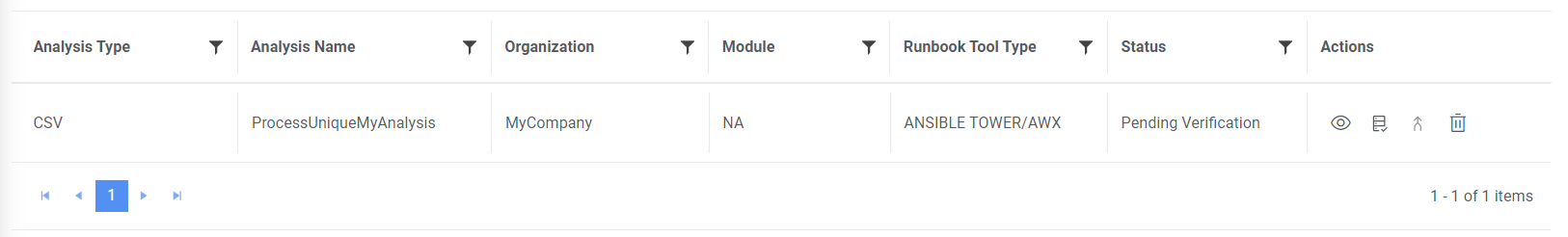

  11. After the analysis is complete, the status automatically changes to Pending Verification.
    Figure 18. Build/ Approve Single Analysis (Cont.)
  12. To verify the pending verification, click again next to the analysis you want to verify, and it will redirect you to theVerify page.

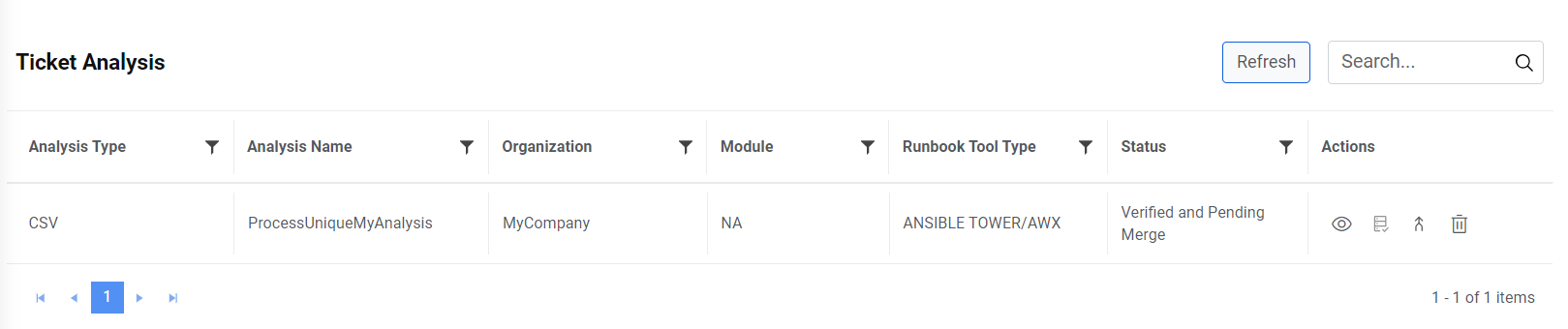

  13. Click Verify to approve the analysis.
    Figure 19. Build/ Approve Single Analysis (Cont.)

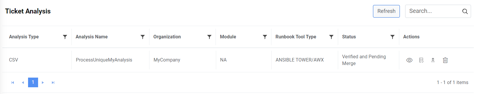

The analysis status changes to Verified and Pending Merge.
Figure 20. Build/ Approve Single Analysis (Cont.)

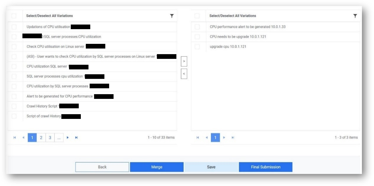

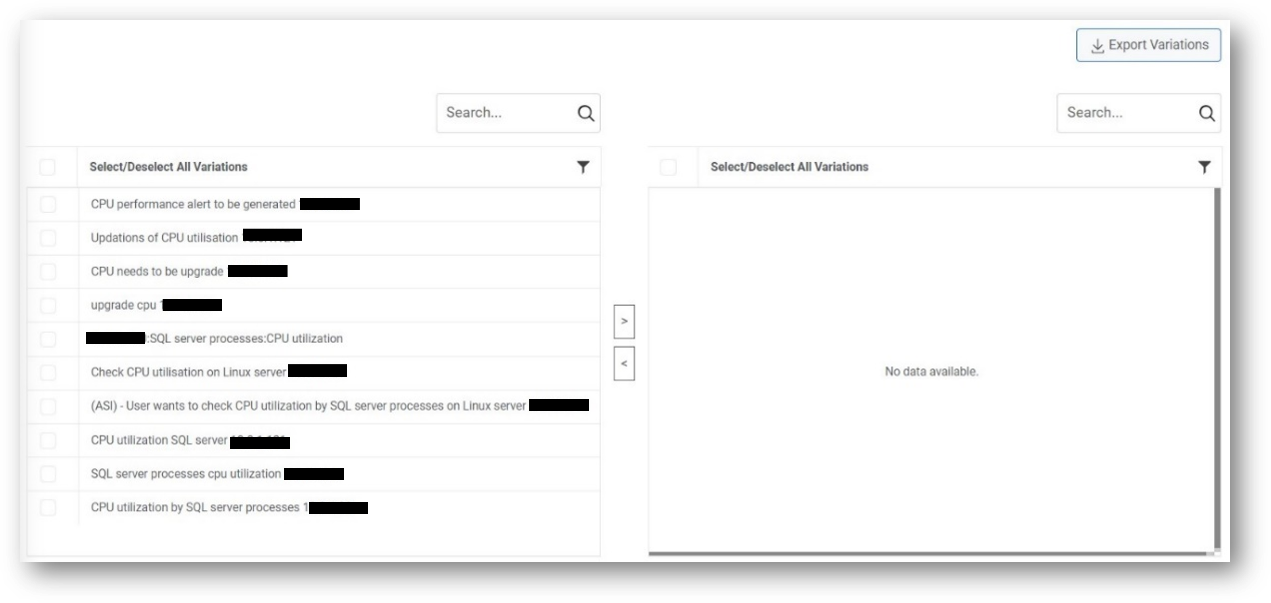

  2. The Merge Analysis page lists all the configured variations in a tabular view.
    Figure 23. Merge Analysis (Cont.)
  3. Select the variations from the left grid. Click to move the selected variations to the right grid and vice versa to remove selected variations.
    User can select a single variation or multiple variations to merge.
  4. To merge the selected variations, click Merge, and then click Save.
    Figure 24. Merge Analysis (Cont.)
  5. To proceed with the analysis, click Final Submission to submit the merged variations.

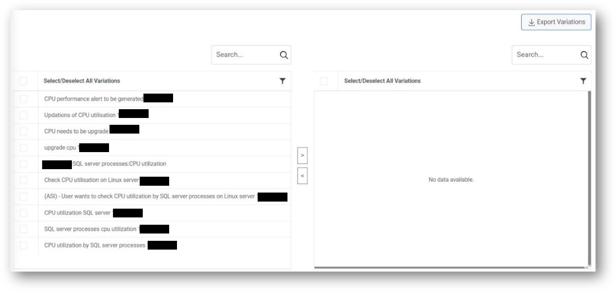

    Click Export Variations to export the selected variations.
BigFix Runbook AI provides you with search capabilities to access required variations from the list of variations based on certain keywords or set of characters. Type a value in the Search box and then select Search to get the preferred results.
Figure 25. Merge Analysis (Cont.)
Click Clear Search to cancel the search.

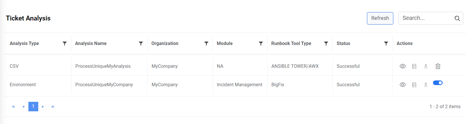

Auto Switch Mode for Analysis
Users can automatically validate newly identified unique tickets.
  1. On the Ticket Analysis screen, enable the toggle button next to the analysis to enable the Auto Switch mode.
    Figure 26. Auto Switch Mode for Analysis
  2. The auto-mode for the analysis gets enabled.
    Figure 27. Auto Switch Mode for Analysis
    The auto switch mode works only for environment analysis.

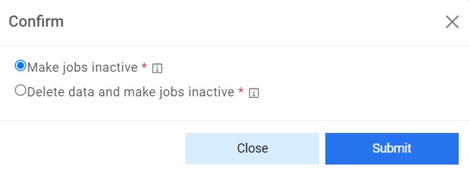

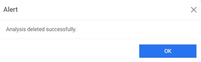

Delete Analysis
An analysis can be deleted if it is no longer required.
To delete an analysis, perform the following steps:
  1. Click to delete the analysis.
    Figure 28. Delete Analysis
  2. Select the appropriate option visible in the confirmation dialog box if you would like to make the jobs inactive or delete the data along with it.
    Figure 29. Delete Analysis (cont.)
  3. A confirmation message appears.
