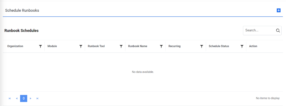

  1. On the main bar, click Runbooks and then Schedule Runbooks. The Schedule Runbook page appears. To schedule a runbook, click on icon.
    Figure 1. Schedule Runbook

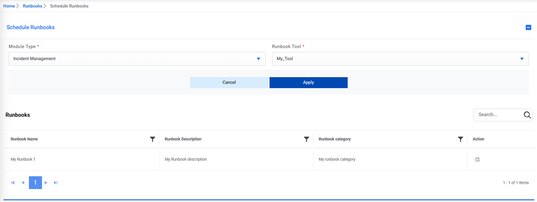

  2. Select Module and then select the Runbook Tool and click on Apply. It lists all the runbooks configured with the selected Runbook tool in a tabular view.
    Figure 2. Runbook Search Results

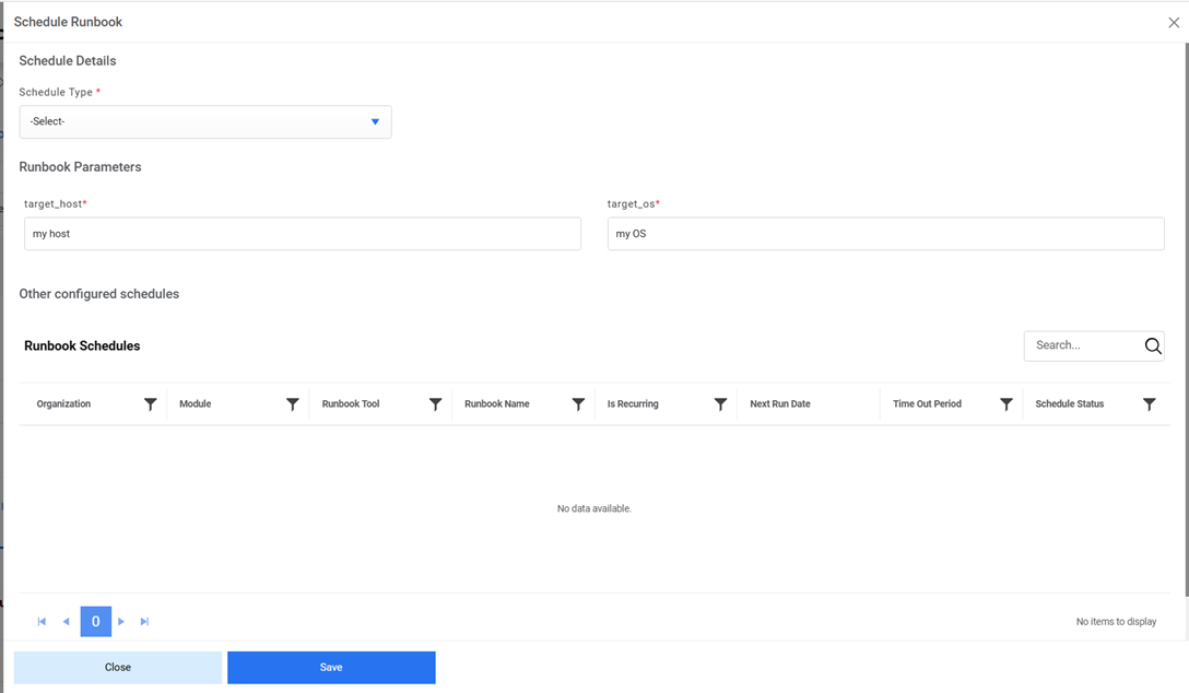

  3. Click and fill in the details to schedule a Runbook.
    Figure 3. Runbook Details

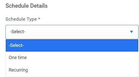

  4. Select One time or Recurring from the Schedule Type drop-down menu to specify the scheduling frequency.
    Figure 4. Select Schedule Frequency

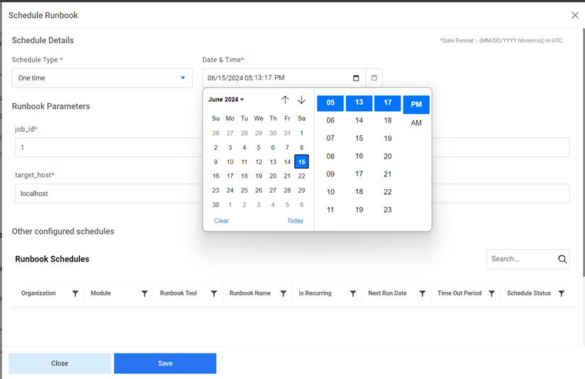

  5. If the user selects One time, specify the Start date and time.
    Figure 5. Scheduled Runbook (One Time)

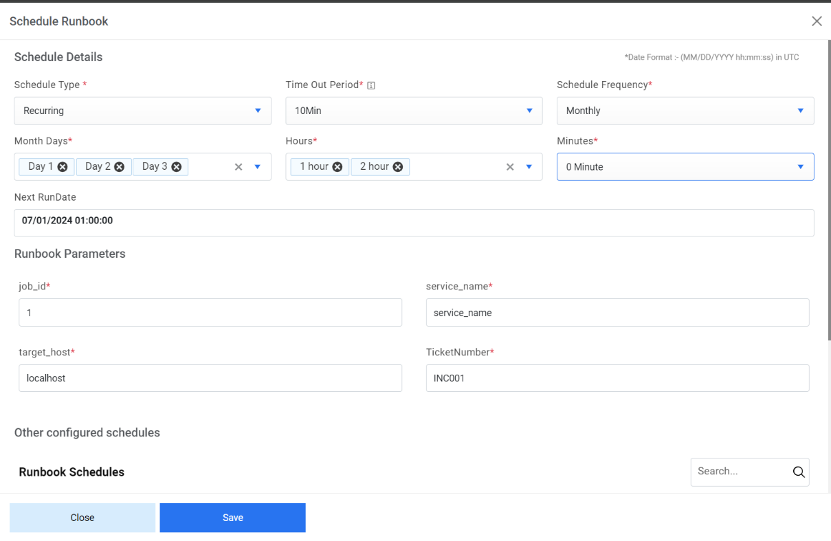

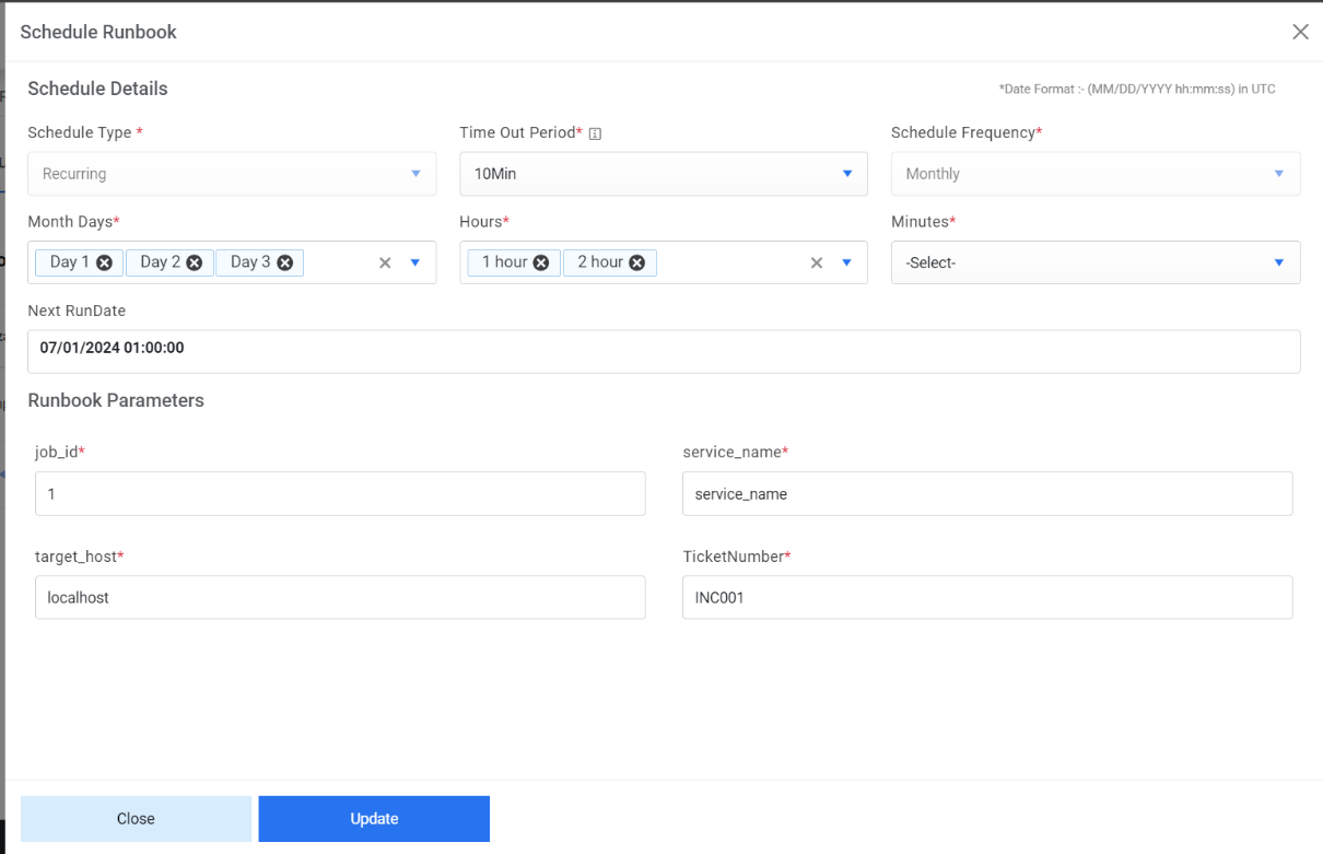

  6. If the user selects Recurring, specify the Time Out Period and the Schedule Frequency for how often the user wants the runbook to repeat by hour, day, week, or by month.
    Figure 6. Scheduled Runbook (Recurring)

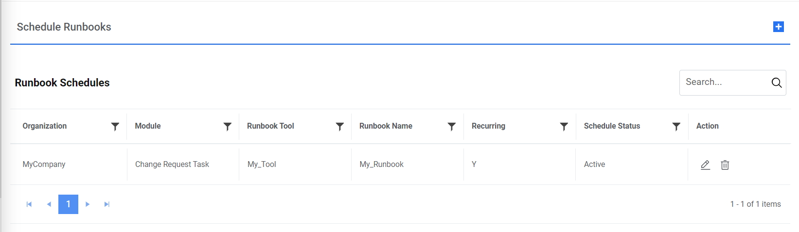

  8. This creates a new schedule and lists it on the Runbook Schedule page.
    Figure 8. Schedule Runbook (Cont.)
  9. The Runbook Schedule page enables users to edit or delete existing schedules.
    One-time schedule type Runbook cannot be edited. In case the user needs to modify it, it will have to be added as a new entry through Schedule Runbook
  10. Click next to the schedule you want to edit. This opens the auto-filled Schedule Runbook page.
  11. Click Update after editing the required details.
    Figure 9. Edit Details

  13. To delete an existing schedule, click corresponding to the schedule.
  14. Click Yes to confirm.
