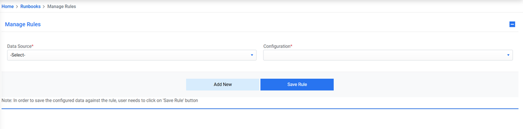

  1. On the main menu bar, click Runbooks, and then click Manage Rules. The Manage Rules page appears:
    Figure 1. Manage Rules
  2. Select a data source to fetch the data from the list of data sources available in the Data Source Name field.
  3. Select Configuration from the list of configurations available.
All the existing rules are listed in a tabular view with the associated parameters that allows user to manage the parameters for the existing rules.
No Rule in the condition column indicates the Else or Default condition. If No Rule is added against the selected Customer-Module combination, then BigFix Runbook AI will release the ticket without condition in case of Rule-based Release in the Manage Configuration tab.
