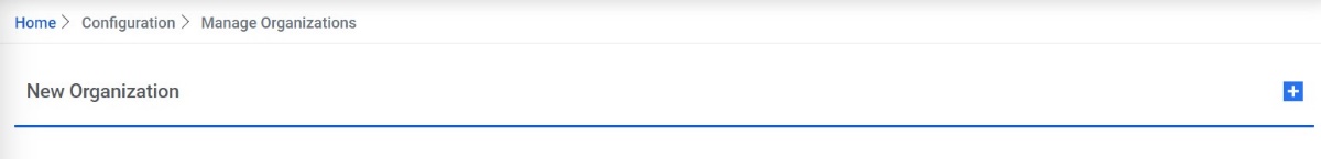

  1. On the main menu bar, click Configuration and then Manage Organizations . Then click on the plus sign.
    Figure 1. Manage Organization

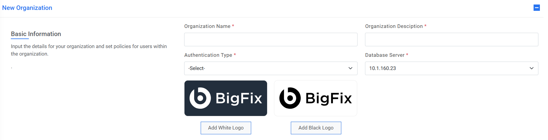

  2. The New Organization page appears.
    Figure 2. New Organization
  3. Type the name of the customer to be created in the Organization field.
  4. Type the customer description in the Organization Description field.
    The supported file type for uploading an image as a logo is .jpg, .jpeg, and .png and the recommended file size is not over 10 KB.

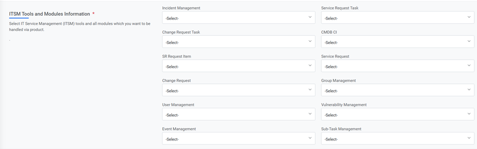

  5. Select the ITSM Tool Type from the Module Name field.
    Figure 3. Select ITSM Tool Type

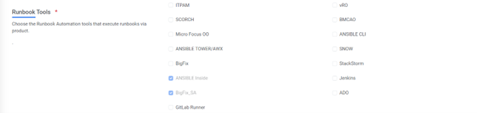

  6. Select the required Runbook Tool from the list of tools.
    Figure 4. Select Runbook Tool
    You can select single or multiple automation tools against the selected module.

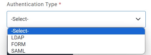

  8. Select the Authentication Type from the following options:
    • FORM: Users are authenticated without Active Directory (AD) support.
    • LDAP: Users are authenticated using their AD credentials.
    • SAML: Users are authenticated using the SSO (Single Sign On) credentials that allow security credentials to be shared by multiple computers across the network.
      Figure 5. Authentication Type Selection
    The selected authentication type will reflect while managing the user as explained in Add New User

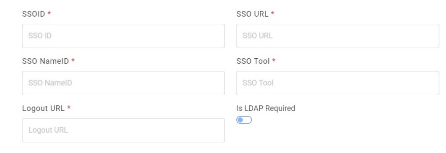

  10. Selection of SAML authentication prompts the additional fields to be filled.
    1. Type the ID in the SSO ID field.
    2. Type the URL in the SSO URL to access the BigFix Runbook AI website.
    3. Type the name ID in the SSO Name ID field.
    4. Enter the tool in the SSO Tool field.
    5. Enter the Logout URL.
      Figure 6. Select Authentication Type (SAML)

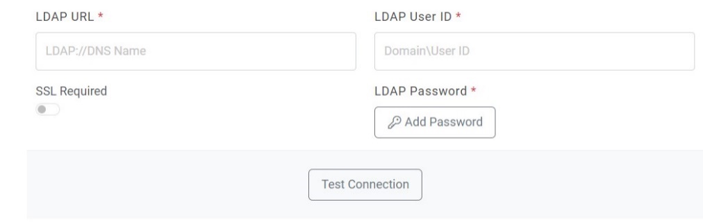

  12. Selection of LDAP authentication prompts the additional fields to be filled.
    1. Enable Is SSL Required field if configuration Run over LDAPS
    2. Type the LDAP URL.
    3. Type the LDAP UserID.
    4. Enter the LDAP Password.

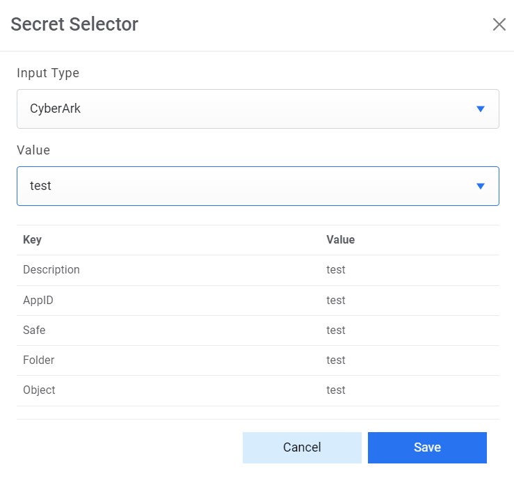

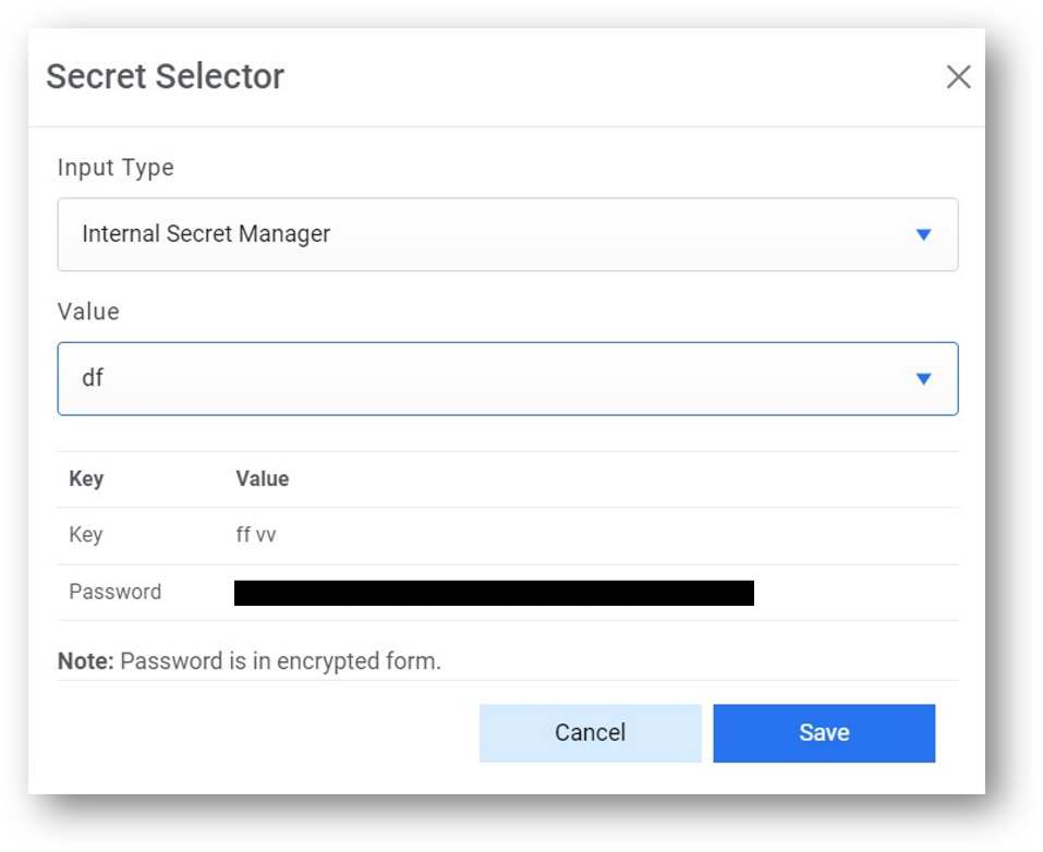

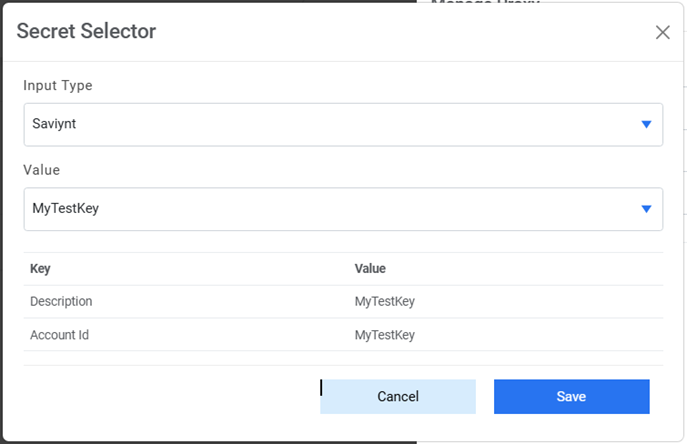

    5. For LDAP password, click on Add Password button next to it. If the password is available in plaintext, then select Input type as Input Text and enter the password in Value field. Else if it is available in Azure Key Vault then select Input Type as Azure Key Vault and then select any of the configured details from the value field. Else if it is available in any Key Vault such as CyberArk or Secret Manager then select Input Type as CyberArk or Secret manager respectively and then select any of the configured details from the value field.
      Figure 7. Password in Plaintext
      Figure 8. Password from Key Vault (CyberArk)
      Figure 9. Password from Secret Manager
      Figure 10. Password from Azure Key Vault
      Figure 11. Password from Saviynt Vault
    6. Click on Test Connection to check accessibility of LDAP from service. If an alert is generated saying ‘Use only WhiteListed URL’ then refer to ‘HCL BigFix Runbook AI KRS Guide’ to whitelist any URL.

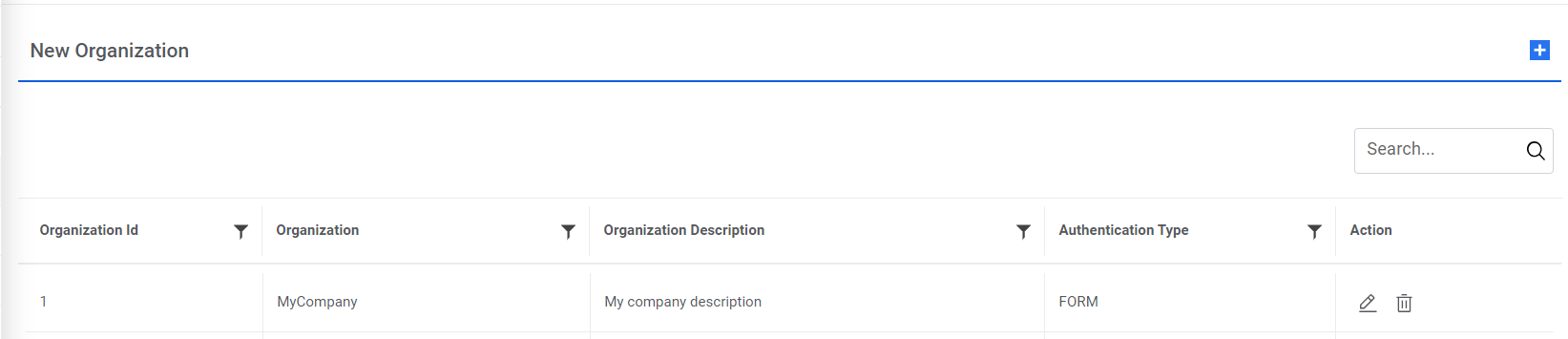

  13. Click Save.
  14. A confirmation dialog box appears. Click OK.
    Figure 13. Organization Creation Confirmation

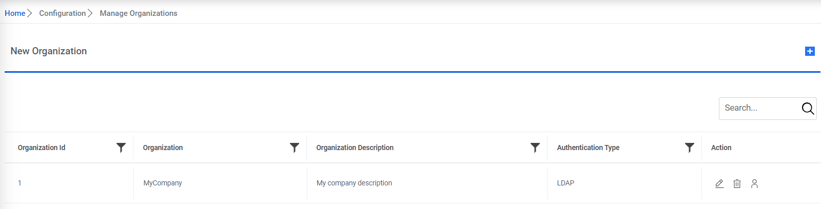

  15. The new organization is added and listed in a tabular view.
    Figure 14. Organization Creation Confirmation

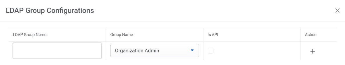

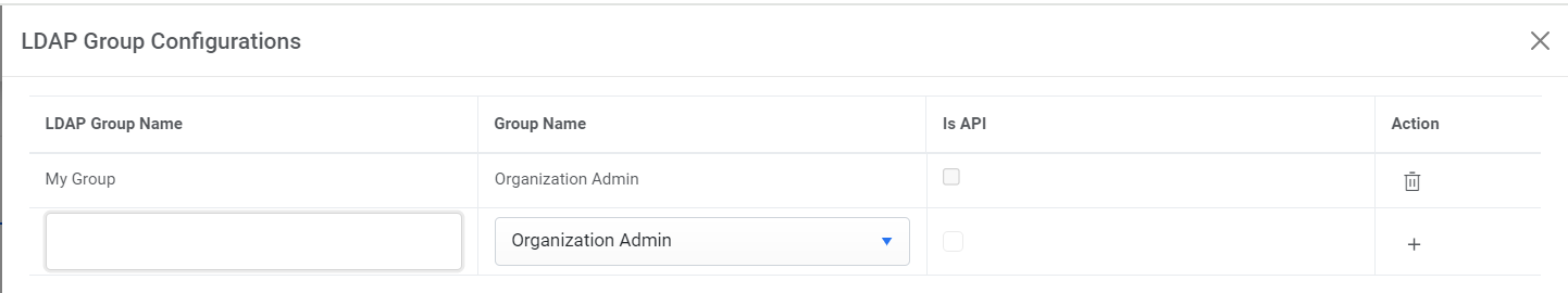

  16. In the case of LDAP, click to enter the LDAP Group Information.
    Figure 15. Enter LDAP Information
    1. Enter LDAP Group Name and select the Group Name from the dropdown.
    2. Check Is API if this group user needs to be treated as an API user.
    3. Click to add group.
      Figure 16. Enter LDAP Group Name
      Users can add multiple groups, and a group can be deleted by clicking icon.
    4. After having added the group details, click Submit.

  3. This screen lists all the available organizations in a tabular view with the organization name and organization description. It also allows user to create an organization by clicking Add New, which redirects you to Manage Organizations screen to create an organization and edit or delete existing organizations.

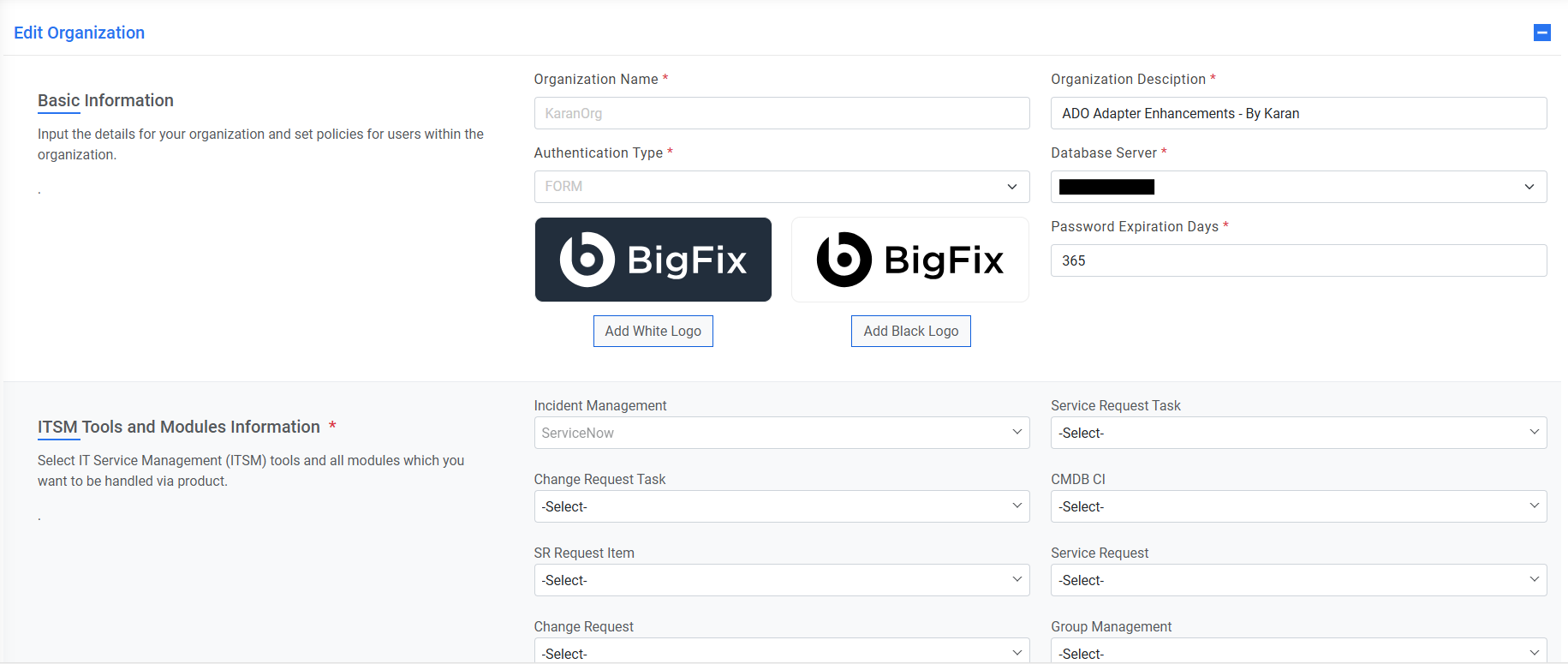

Edit Organization
Users can open an existing organization, review the available information, and edit the organization’s details.
To edit the existing organization, perform the following steps:
  1. On the Manage Organizations page, click corresponding to the organization that you want to edit.
    Figure 18. Edit Organization
  2. This redirects you to the Edit Organization page with all the details auto filled details.
  3. Edit the required details and click Update.
    Figure 19. Edit Organization
    Figure 20. Edit Organization (Cont.)
