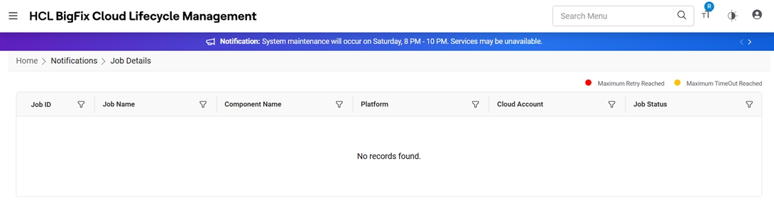

Job Details
  1. On the side menu bar, click Notification and then click Job Details.
    Figure 1. Job Details (Cont.)
    Refer to the table below to understand the fields mentioned in the above figure:
    Table 1. Job Notification Details
    Field Description
    Platform Name of the Cloud Service Providers.
    Job ID Unique Id of a Job.
    Job Name Unique Job Name
    Component Name Job belongs to which Component, like Sync, Comp etc.
    Cloud Account Unique Endpoint Name of the Provider.
    Job Status Status of the Job.
  2. This helps users to notify the number of jobs which are either in the state of Maximum Retry Reached, Maximum Timeout Reached or Failed.
