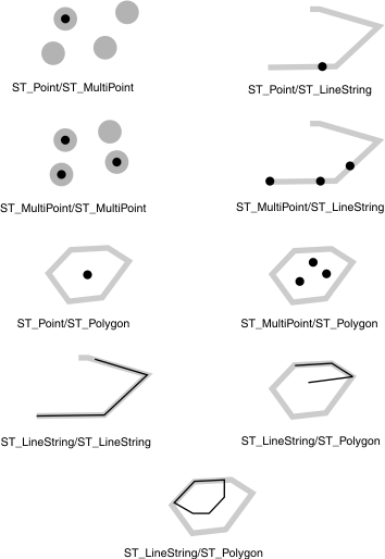

Figure 1. Geometries within other geometries
This graphic shows various geometric objects where one object is entirely within the other.
