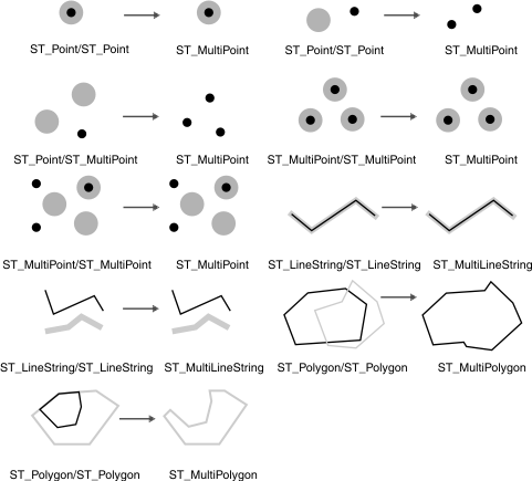

The source geometries must have the same dimension. ST_Union() returns the result as an ST_GeomCollection (ST_MultiPoint, ST_MultiLineString, or ST_MultiPolygon).
Figure 1. The union set of two geometries
This graphic shows the union of various geometric objects.
