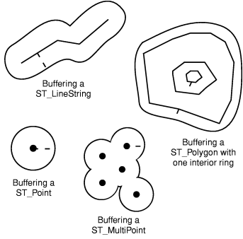

As shown in the following figure, ST_Buffer() generates a polygon or a multipolygon that surrounds a geometry at a specified radius.
Figure 1. Buffers generated by the ST_Buffer() function
This graphic shows the buffering of various geometric objects.
A single polygon results when a primary geometry is buffered or when the buffer polygons of a collection are close enough to overlap. When enough separation exists between the elements of a buffered collection, individual buffer ST_Polygons result in an ST_MultiPolygon.

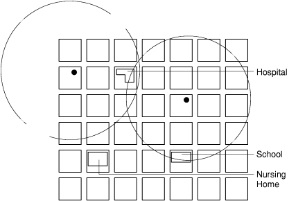

The following figure shows that some of the sensitive areas in this administrative district lie within the 5-mile buffer radius of the hazardous site locations. It is clear that both buffers intersect the hospital and one intersects the school. The nursing home lies safely outside both radii.
Figure 2. Sensitive areas
This graphic is described in the surrounding text.
