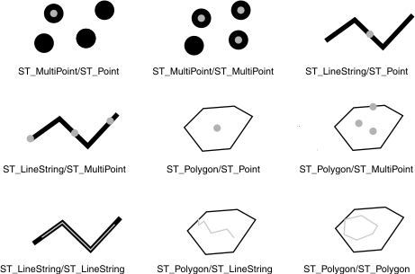

To return TRUE, the boundary and interior of the second geometry cannot intersect the exterior of the first geometry. ST_Contains() returns the opposite result of ST_Within().
Figure 1. Contained geometries
This graphic shows various geometric objects where one object is completely contains by the other.
