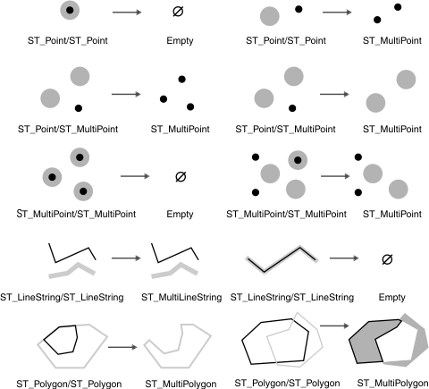

Figure 1. The symmetric difference of geometries
This graphic shows the symmetric difference of various geometric objects.
