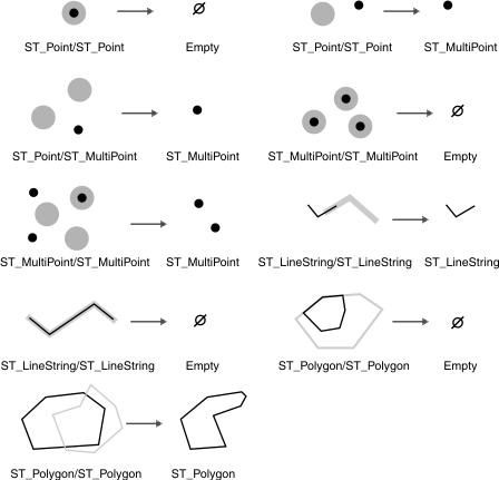

Figure 1. The ST_Difference() function
This graphic shows the difference between various geometric objects.
