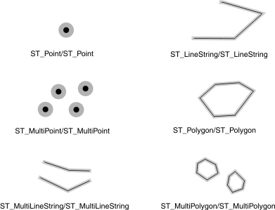

The following figure shows sets of various geometric objects that are spatially equivalent.
Figure 1. Equal geometries
This graphic shows two sets of various geometric objects that are the same.
