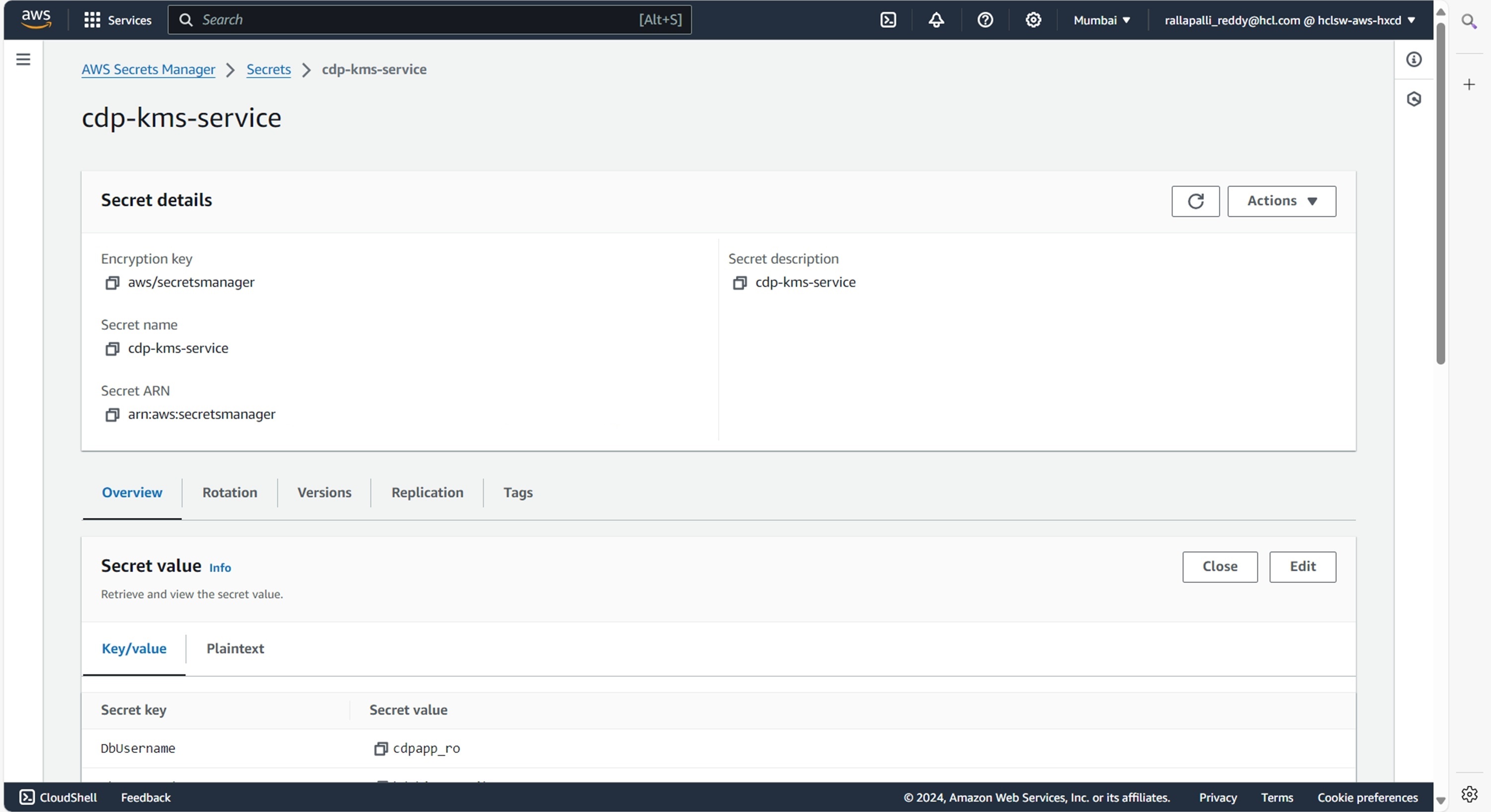

Make sure to create a cdp-kms-service secret with required data in the AWS Secrets Manager before deploying CDP KMS Service.
To create the cdp-kms-service secret in the AWS secret manager, follow the steps below:
  1. Create a cdp-kms-service secret sample key and value in the cdp-kms-service secret, and update ConfigMaps data with actual values.
