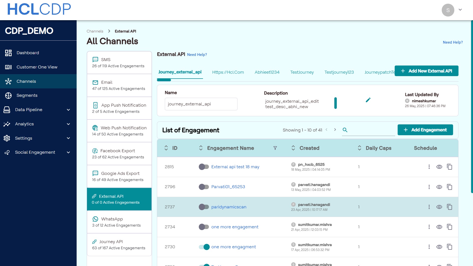

  • Navigate to Channels.
  • On the left panel, click External API, and click Add Engagement.
  • Select Segment Name from the list.
  • Click Confirm And Proceed To the Next Step.
