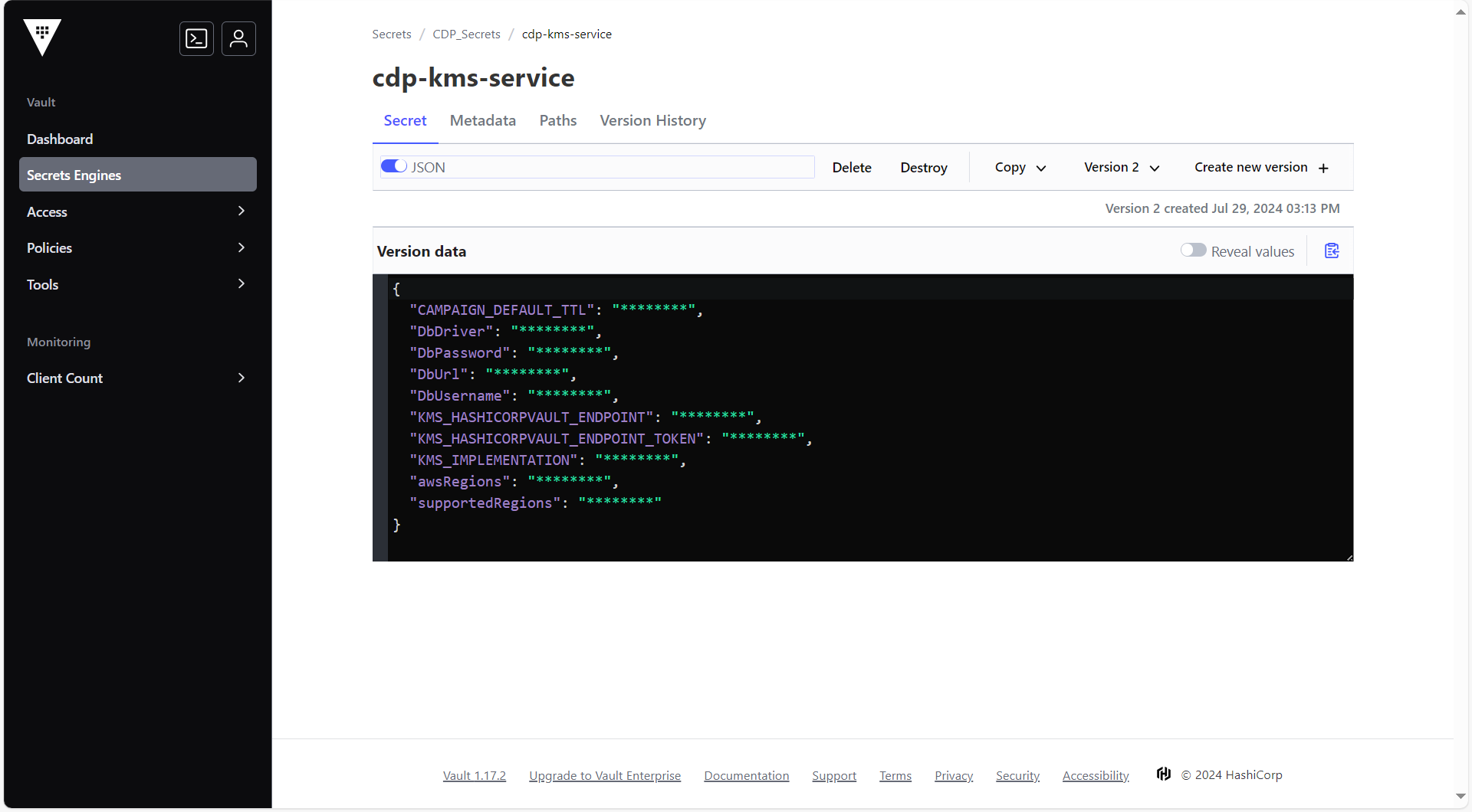

To create the cdp-kms-service secret in the HashiCorp Vault, follow the steps below:
  1. Create a cdp-kms-service secret sample key and value in the cdp-kms-service secret, and update ConfigMaps data with actual values.
      "CAMPAIGN_DEFAULT_TTL": "21600",
      "DbDriver": "<DbDriver>",
      "DbPassword": "<DbPassword>",
      "DbUrl": "<DbUrl>",
      "DbUsername": "<DbUsername>",
      "KMS_HASHICORPVAULT_ENDPOINT": "<KMS_HASHICORPVAULT_ENDPOINT>",
      "KMS_HASHICORPVAULT_ENDPOINT_TOKEN": "<KMS_HASHICORPVAULT_ENDPOINT_TOKEN>",
      "KMS_IMPLEMENTATION": "HashiCorpVault",
      "awsRegions": "ap-south-1",
      "supportedRegions": "aps1"

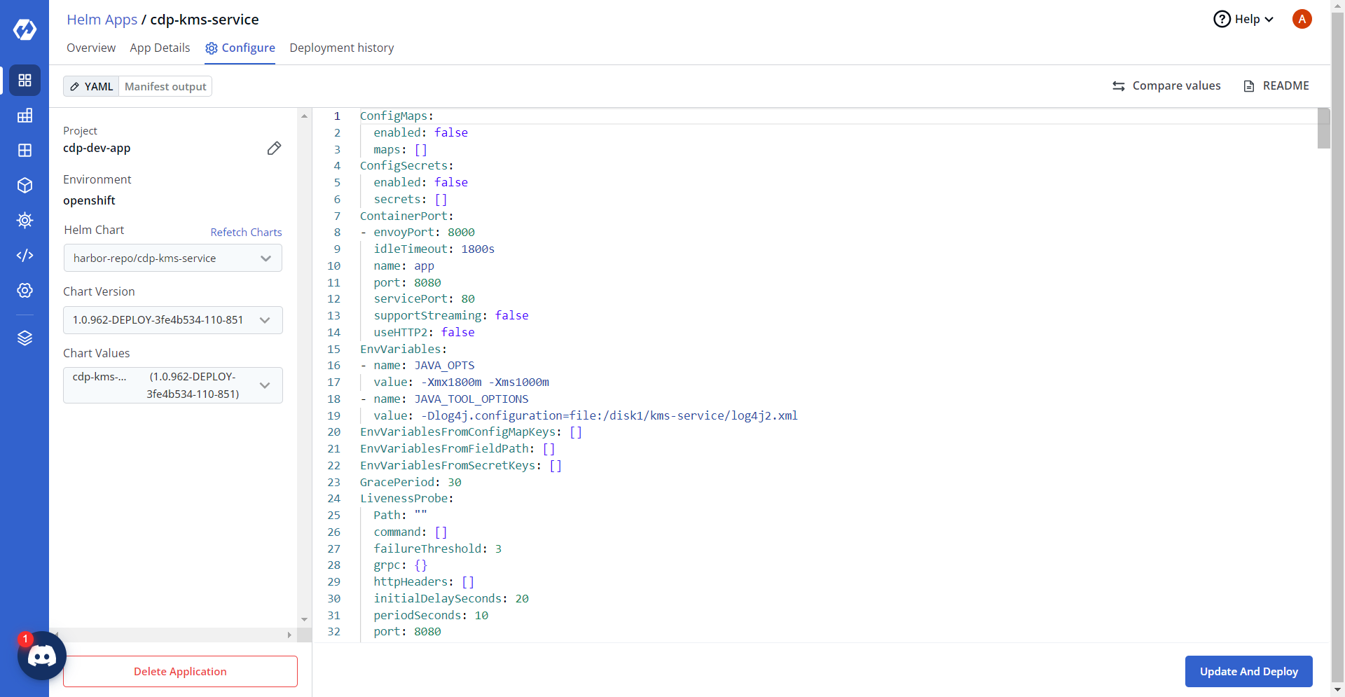

Deploying CDP KMS Service
To deploy the CDP KMS Service, follow the steps below:

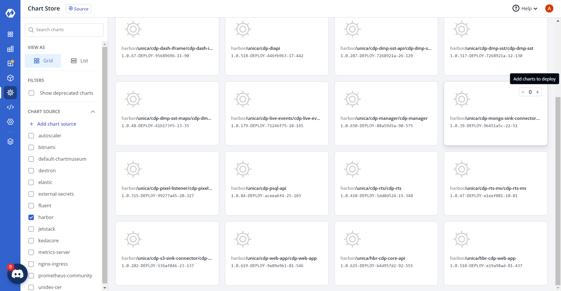

  1. Navigate to the Devtron Chart Store, and select the cdp-kms-service chart to deploy.
  2. Now, configure and deploy the CDP KMS Service.
  3. In the YAML section, update the ConfigMap using below details, and deploy the charts.

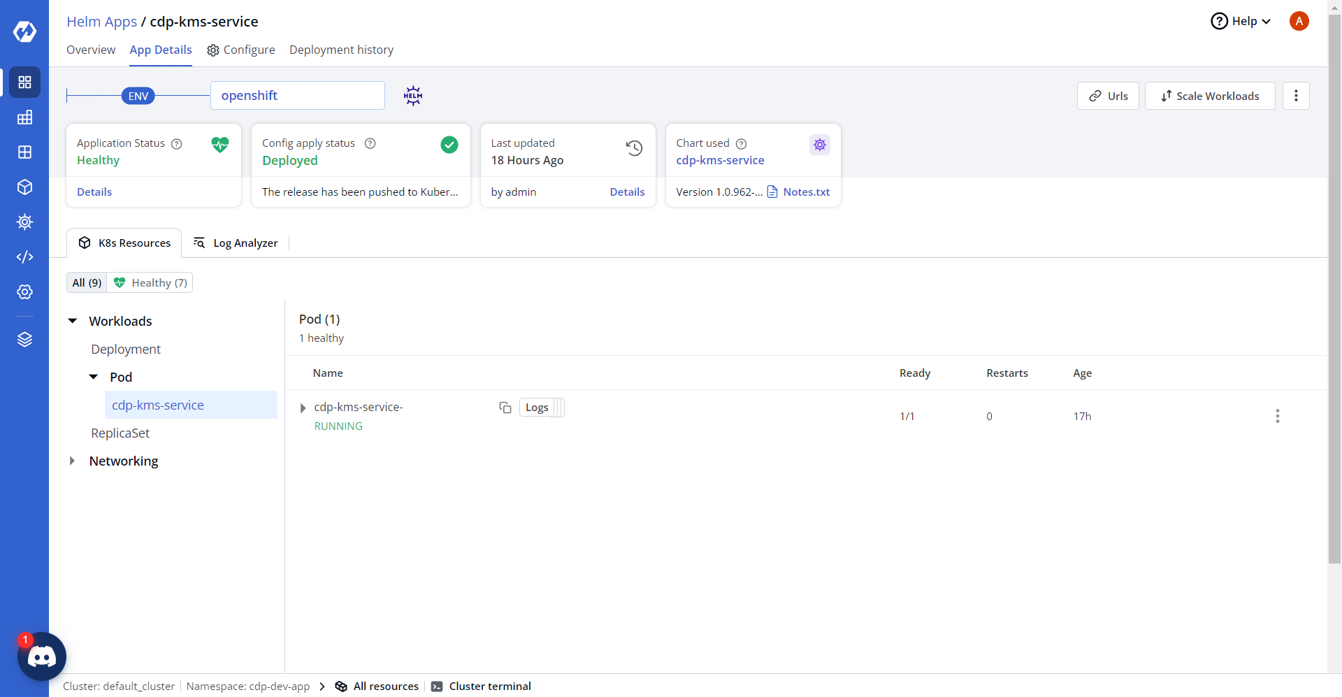

  4. On successful deployment, validate the deployment as shown below.
