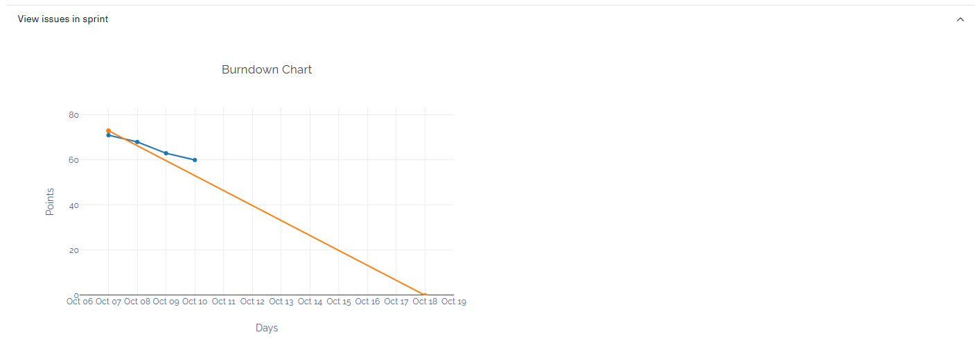

  • Sprint burndown chart
  • Individual Measures

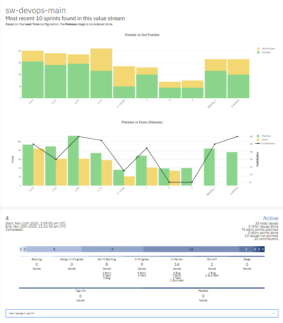

Additionally, Pointed vs Not Pointed and Planned vs Done (Release) bar chart graphs for all sprints in the value stream are displayed at the top of the State of the Sprint Report page.

The Pointed vs Not Pointed and Planned vs Done bar charts are interactive. You can hover over any area of the chart to dynamically display values and plot tool icons that provide extended functionality. You can click different areas of the blue shaded bar chart above to display the stage name with the number of related issues.

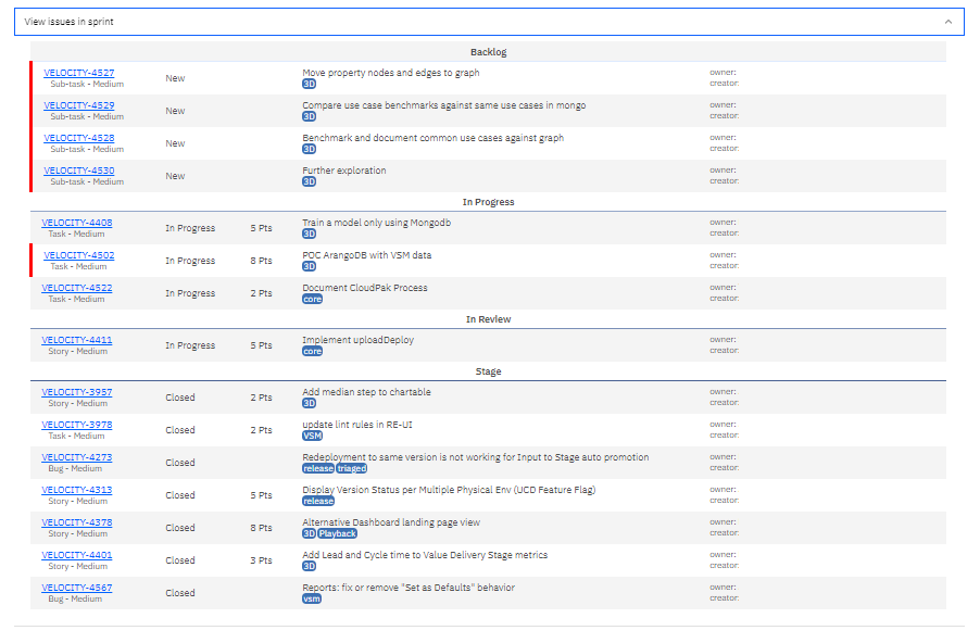

Click View issues in sprint to expand and display the burndown chart, related issues for each stage of the value stream, and the individual measures for the developers who contributed to the sprint.
expanded view issues in sprint bar screen capture
The red vertical bar indicates alerts for issues such as over median time, no owner, and so on. You can click the issue link to open the ticket in a browser window to view detailed information for that item.

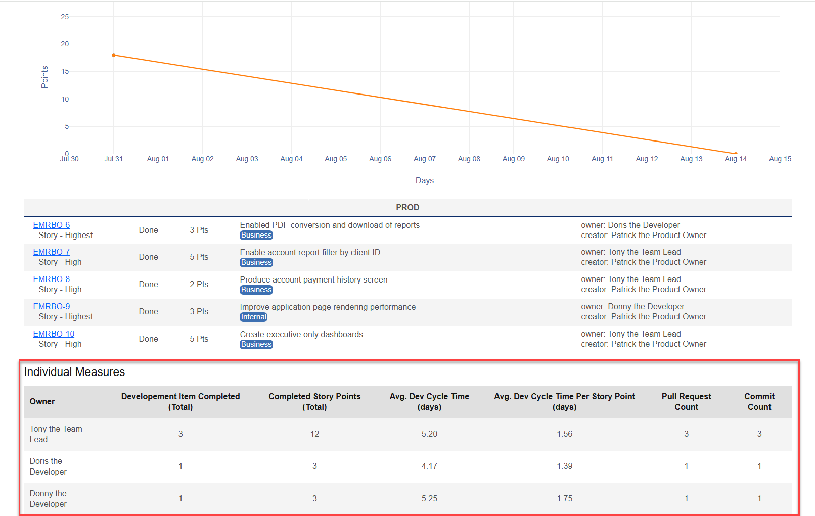

Individual Measures
The Individual Metrics section, available for each sprint, provides detailed insights into the contributions and performance of each contributor. This data is critical for engineering managers, product owners, and team leads to assess individual efficiency, promote accountability, and guide continuous improvement initiatives.
For every contributor who participated during a sprint, the following metrics are displayed:
  • Number of Issues Completed
    Tracks the number of tasks (stories, bugs, or technical items) a contributor has completed. This metric helps evaluate task throughput and individual contribution levels.
  • Total Story Points Completed
    Measures the total effort delivered by a contributor based on the story points assigned to completed work items. This metric supports capacity planning and performance evaluation.
  • Number of Pull Requests Created
    Indicates the frequency at which a contributor submits code changes for review. This metric provides insight into coding activity and collaboration with peers.
  • Total Number of Commits
    Shows the number of code commits made by a contributor, reflecting consistency, development cadence, and active involvement in coding tasks.
  • Dev Cycle Time
    Measures the duration a contributor takes to complete a work item, calculated based on the specific stages you have configured for Dev Cycle Time within your value stream. This metric is useful for identifying delays, inefficiencies, or areas requiring support or process refinement.
  • Dev Cycle Time per Story Point
    Normalizes Dev Cycle Time by story point size, allowing teams to evaluate individual efficiency relative to task complexity. This metric helps identify high-performing contributors or flag potential mismatches between estimated and actual effort.
Individual Measures are displayed in a tabular format within the State of the Sprint report, as shown in the following example, offering a clear overview of the contributions and performance metrics of each contributor for a given sprint.
Individual measures of the developers in a sprint
