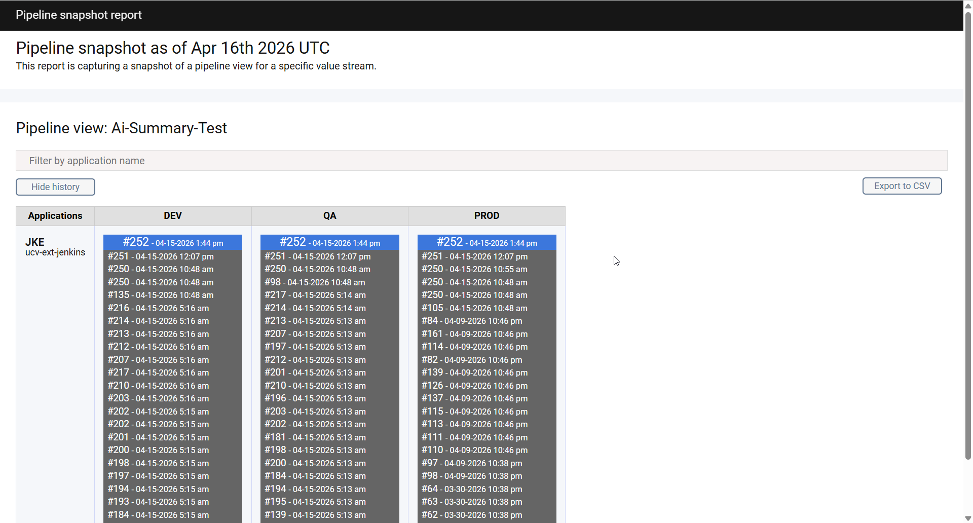

A sample pipeline snapshot report page is shown as follows:
