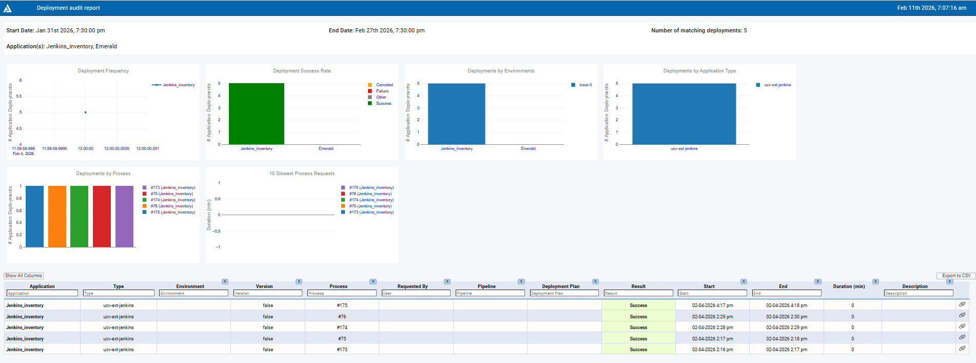

The Deployment audit report page displays the following information about the report:
  • Date: Shows the date, time, and email address of the user who ran the report.
  • Status: Shows the color-coded status: Orange = STARTED, green = COMPLETE, and red = FAILED.
The following elements provide detailed information about the report:
  • View log: When you click View log, the log details of the report are displayed.
  • View parameters: When you click View parameters, the VIEW PARAMETERS OF EXECUTION window opens and displays the details used to run the report.
  • Share: When you click Share, the URL is copied so you can share the report.
  • Results: When you click Results, the Deployment audit report page is displayed. You must then click Export to CSV to export the deployment audit report.
A sample deployment audit report page is shown as follows:
