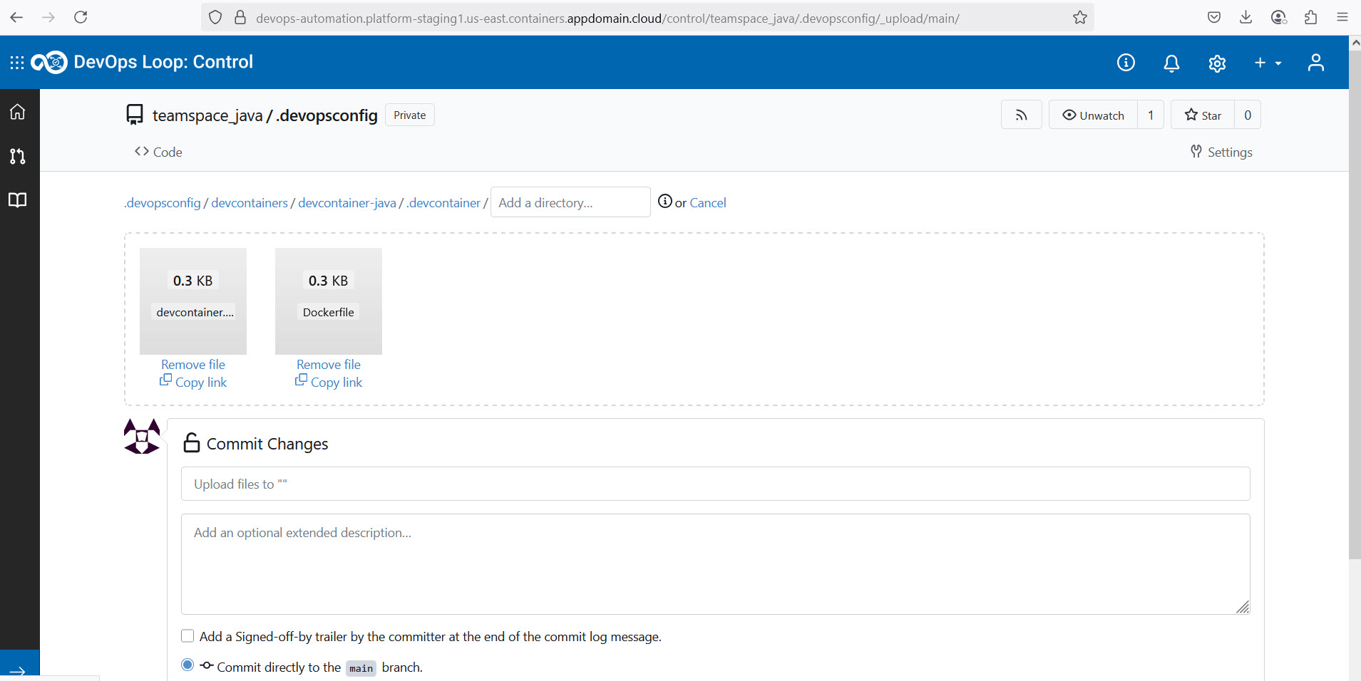

  8. Upload devcontainer.json and Dockerfile
    Inside the .devcontainer folder of the repo, upload devcontainer.json and Dockerfile.
    Commit the changes to the main branch.
    Note: You can also commit the changes to a different branch other than the main branch. In such a case, you will see different branches on the Branch menu.
  9. Verify the files
    Ensure both the devcontainer.json and Dockerfile.yml files are correctly uploaded at:
    teamspace-java/.devopsconfig/.devcontainer/

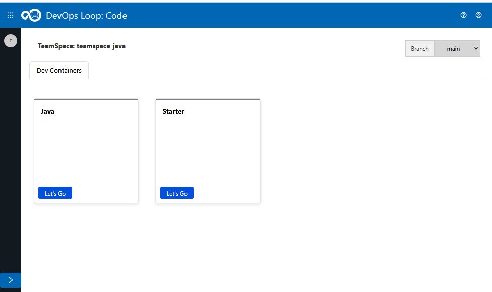

  10. Start the Java container
    1. Go to the Code landing page.
    2. Click the teamspace button and switch to your teamspace. Under Dev Containers, you will see a new dev container, along with the default Starter container that is always available for all users.
    3. Click Let’s Go to launch the container.
    Note: The first-time launch may take a few minutes.

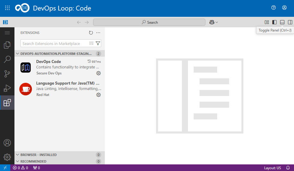

  11. View Visual Studio Code Extensions
    In the code server instance, click the Extensions button to see and verify the extensions you had configured in devcontainer.json file.
After you configure dev containers for teamspaces, members in a team can launch any dev container directly from their Code landing page.
