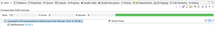

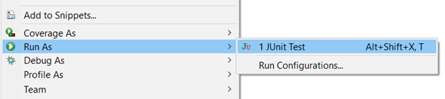

  6. Run this class as a JUnit Test. The result of the execution appears under the JUnit View.
