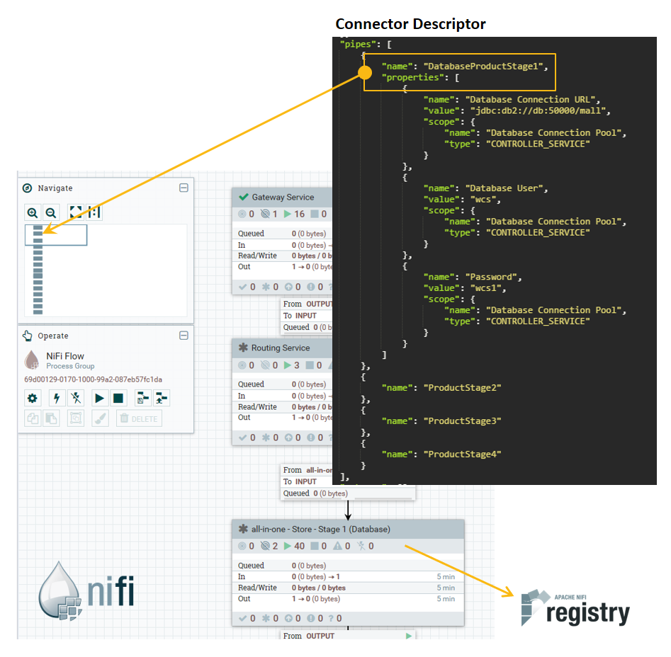

  2. Define your connector. A connector is a set of pipes or pipelines, bundled as a single processing unit. The standard tool for constructing connectors is the Apache NiFi interface. You can use the NiFi console to describe the relationships between pipelines that process incoming data. Multiple processing pipelines can be linked to one another to form a pipeline series inside of a connector, including a custom pipeline created by customers. The output is a Connector Descriptor, which you store in ZooKeeper. The console is located at http://nifi_hostname:30600/nifi.

  3. Design your connector by defining the needed attributes in a descriptor. The descriptor serves as a blueprint for a connector and has the following required attributes:

    Pipes
    The list of pipes that make up a connector. Each pipe in a connector is responsible for doing some sort of ETL operation(s). Each pipe must have a name, which corresponds to a pipe that exists in the NiFi Registry. For more information, see the Apache NiFi Registry documentation.
    You can define the properties that you want set in a pipe; PROCESS_GROUP and CONTROLLER_SERVICE level properties are supported. To define a property, the name and value of the property should be specified alongside their scope (The immediate parent Process Group or Controller Service they should be defined inside).
    When used with PROCESS_GROUP scope, the property defined inside of this section will be used as a variable to be set into the given process group. For example:
    					"name": "connector.wait.limit",
    					"value": "3",
    					"scope": {
    						"name": "Wait for Completion",
    						"type": "PROCESS_GROUP"
    In this example, you are defining a variable with the name connector.wait.limit created inside of the process group with name Wait for Completion. This variable will have a value of 3 assigned to it. Note that variables in NiFi can be inherited to child processors and child process groups. Setting the variable at the pipe level should be sufficient for all of its sub-components to access it.
