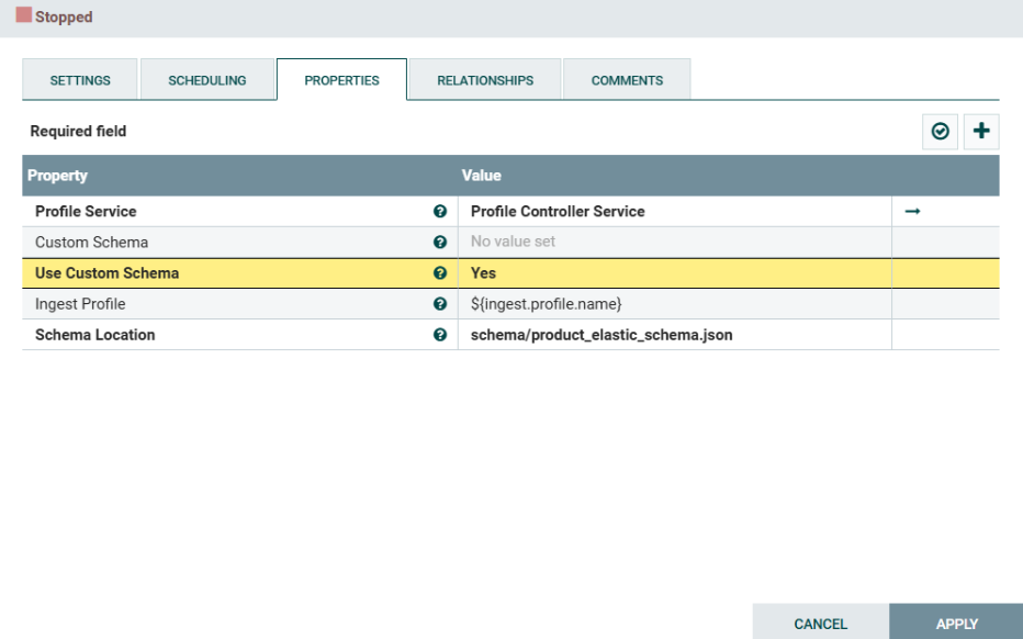

    2. Right-click on the Populate Product index schema processor, click Stop, and then click View configuration and the Properties tab. In the Properties tab, click in the Values field for the Index Schema property and copy the Index schema contents into a text editor for editing.
    3. Add your custom schema in the value for the property Custom Schema and toggle the value of Use Custom Schema to Yes.
