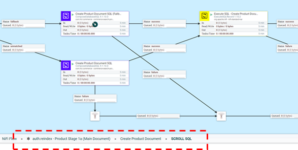

To customize the Extract phase of the ETL process, you can intervene in the logic inside the SCROLL SQL part of the side flow. The exact location in the NiFi flow is auth.reindex-Product Stage 1a (Main Document)/Create Product Document/SCROLL SQL.
