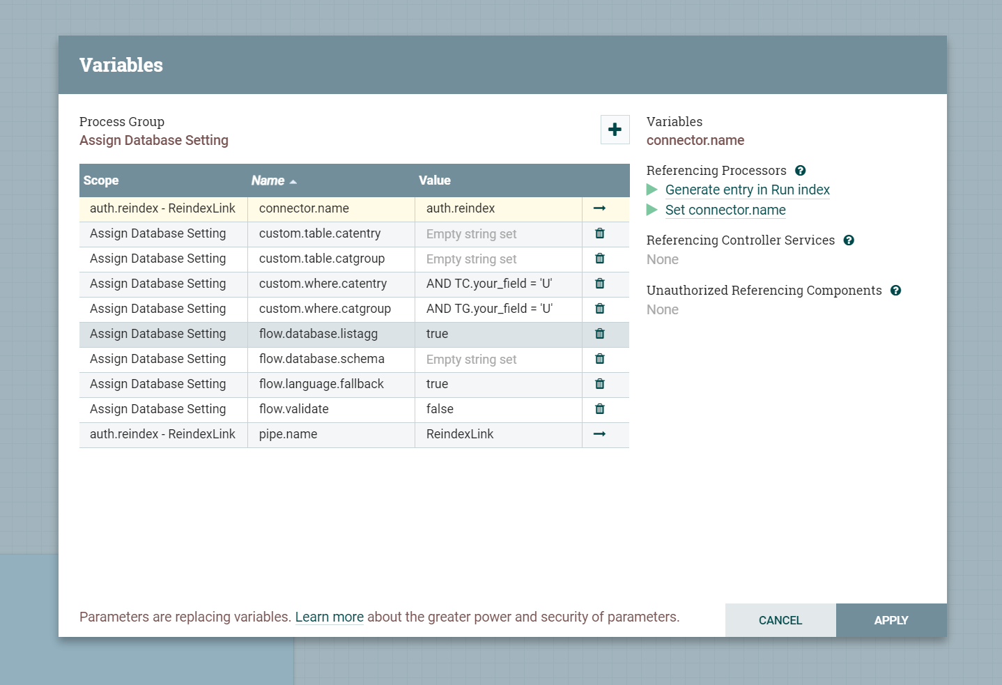

To avoid this problem, Commerce Search provides an application-level function to perform the serialization rather than having the database do it. You control this behavior using a variable that you can set at the flow level or, as a global switch, at the level of the reindex link or the NRT link. This variable is flow.database.listagg, and the default value is True. Setting it in ReindexLink, NRTLink, or DataloadLink means to define this property globally throughout the entire dataflow, while setting this property against a connector pipe instead will scope the operation only against that given stage.
