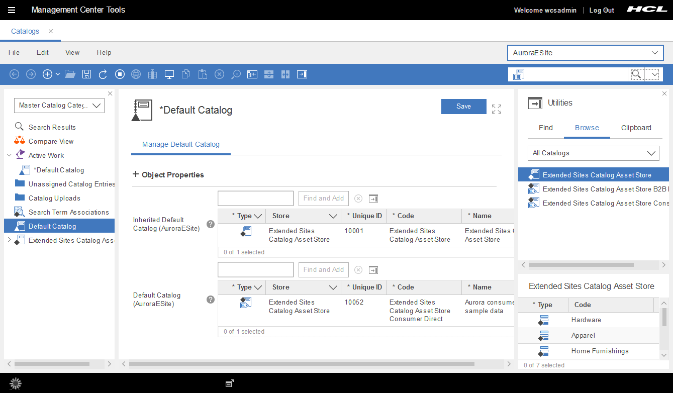

In the default catalog properties when you access the Default Catalog in the explorer filter, two default catalog tables display. The top table is for setting the default catalog at the asset store level. The bottom table is for setting the default catalog at the extended site store level. When working at the extended site level, the asset store default catalog table is read-only and displays the default catalog that is set at the asset store level. The extended site store default catalog table is for setting the default catalog for the specific extended site store you are working in.

  4. In the Manage Default Catalog tab, use the Find and Add function or the utilities view to find the catalog to set as the default catalog for your store.
  5. Select and drag the catalog into the appropriate default catalog table for your asset or extended site store.
    The default catalog table for an extended site store resembles the following image: Screen capture of default catalog
  6. Save your changes.
