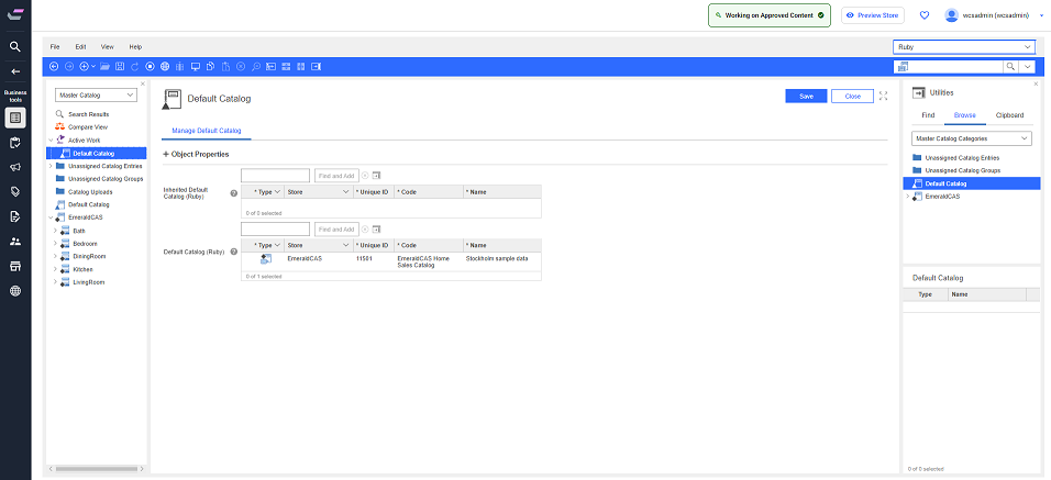

To set the default catalog, use the Catalogs tool.
Default Catalog pane
