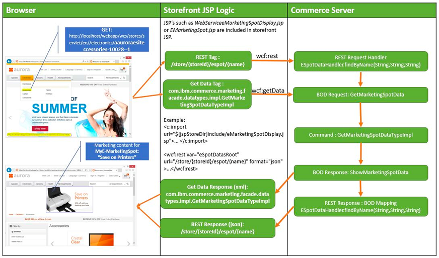

E-Marketing spot request flow
The following image shows the flow of an e-spot request from start to finish.
To understand the request: GET (http://localhost/webapp/wcs/stores/servlet/en/auroraesite/electronics/accessories-10028--1)
E-marketing Spot is always a part of the storefront page, such as CategoryDispalay, ProductDisplay, and HomePage. In this scenario MyE-MarketingSpot is a part of the Computer Accessories; CategoryDisplay page. Search for parentId=0 or ServiceLogger > in the trace logs to find the start of the request. In this example, the following entry is requested for entry and exit:
