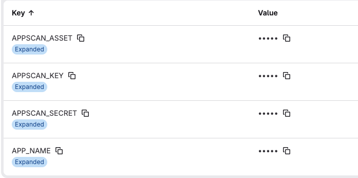

  4. Create variables in GitLab. Select Settings > CI/CD > Variables, and set the variables as follows:
    Table 1. Required inputs (SAST or DAST
    Variable Value
    APPSCAN_KEY Your API key from the API page.
    APPSCAN_SECRET Your API secret from the API page
    APP_NAME The name of the application in AppScan.
    APPSCAN_ASSET The ID of the asset group in AppScan.

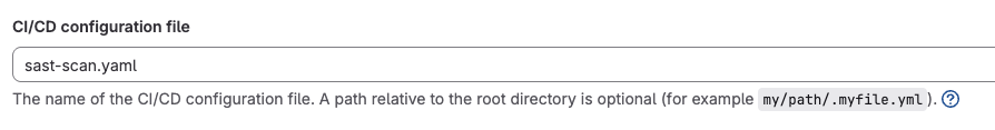

  6. Set the CI/CD configuration file. Select Settings > CI/CD > General pipelines > CI/CD Configuration file.

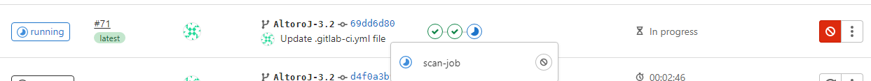

  11. Verify a new scan job is initiated when new merge requests are created at Settings > CI/CD > Pipelines.
Examples
Scan job

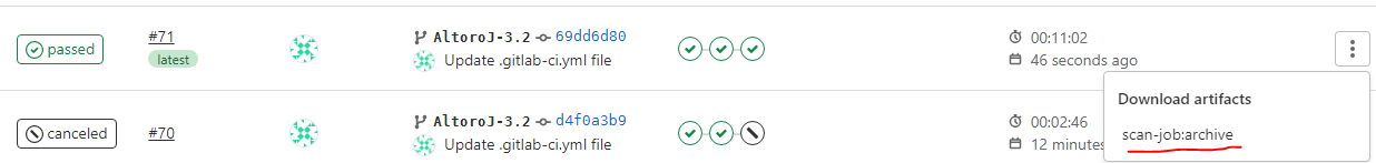

Scan artifacts ready for download

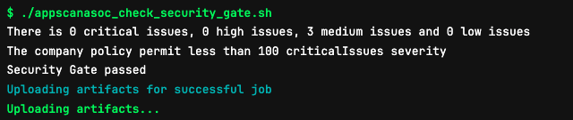

Scan job passed based on maxIssuesAllowed
Additional Information
The current yaml script contains a sample of a security policy check that fails the scan if the number of allowed security issues exceeds a certain threshold. The sample has maxIssuesAllowed set to 100.
