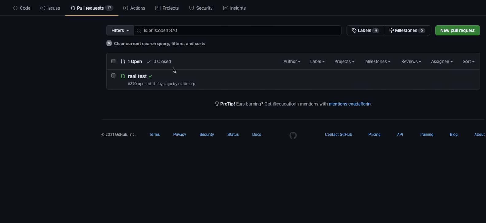

Example
Annotations are added to the diff view, showing any vulnerable lines of code and a checkrun is added to provide additional details, including good and bad code samples and mitigation information.
