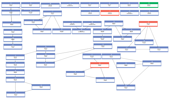

The following graphical views are currently available in the plan:
Plan View
Use this view to get an overall picture of your plan.
This view shows a collapsed plan; it shows only the job streams, hiding any jobs and internal dependencies. External dependencies, both at job and job stream levels, are shown as arrows between job streams. If a job stream has multiple dependencies on another job stream, these are shown as one single arrow.
The following is an example of the view:
Plan View
Because potentially a plan can contain a large number of job streams, by default the Plan View displays a limited number of objects. You can determine which job streams to display by specifying filtering criteria in the page before launching the view or from the toolbar within the view itself.
The maximum number of job streams displayed by the Plan View is 1000. You can modify the default maximum number of job streams to display in the Plan View by modifying the planViewMaxJobstreams property in the TdwcGlobalSettings.xml global settings file for the Dynamic Workload Console.

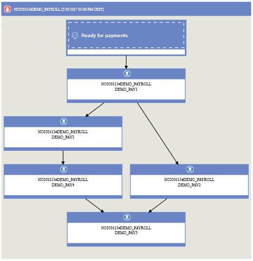

Job Stream View
This view displays a picture of the job stream with all its jobs and related dependencies. You can navigate through the displayed jobs and job streams, choosing the level of predecessors and successors to display. By default, this view displays all the objects in the job stream and the first-level of external predecessors.
You can open this view in the following ways:
  • From the table of results of a Monitor Jobs or Monitor Job Streams task, select an item and select Job Stream View from the toolbar.
  • From the Plan View, right-click a job stream and select Open > Job Stream View.
Use the Rename icon to change the name of the view. The Rename icon is displayed when you hover over the Job Stream View string.
The following is an example of a Job Stream View:
Job Stream View
The main elements in the Job Stream View are:
  • Jobs
    Job
    The status of the job is indicated by the color and the small icon in the header. See Graphical representation of statuses for the various icons representing the status. Additional information available about the job include:
    • The deadline written in the lower-left of the rectangle representing the job.
    • An icon is displayed in the lower-left indicating if the job is time dependent.
    • The tooltip for the job indicates if the job is a critical job or a shadow job. Shadow jobs are jobs running locally that are used to map jobs running on the remote engine.
    Further details are available in the tooltip displayed when you click on the job.
    You can take multiple actions on the job by right-clicking it and choosing options from the context menu. The actions available depend on the selected engine and on the type of job. From this menu, you can view and print the job log and the job properties, or act on the job and its dependencies. You can also take actions on the job workstation or open the job and job stream definitions in the database to modify them.
  • Dependencies
    Dependency
    They are shown as boxes different from those used to represent jobs, connected to the depending items by arrows that represent the dependency relationships. A joined conditional dependency instead is represented by the circle icon connected to the dependency arrows. To take actions on dependencies, you can right-click either the box or the arrow and choose an option from the context menu. Icons displayed in the box to the left describe the dependency type. Further details are available in the tooltip displayed when you click on the dependency. If dependencies within a job stream form a loop, this is highlighted in the view and a message appears, so that you can take the appropriate actions to resolve it.
