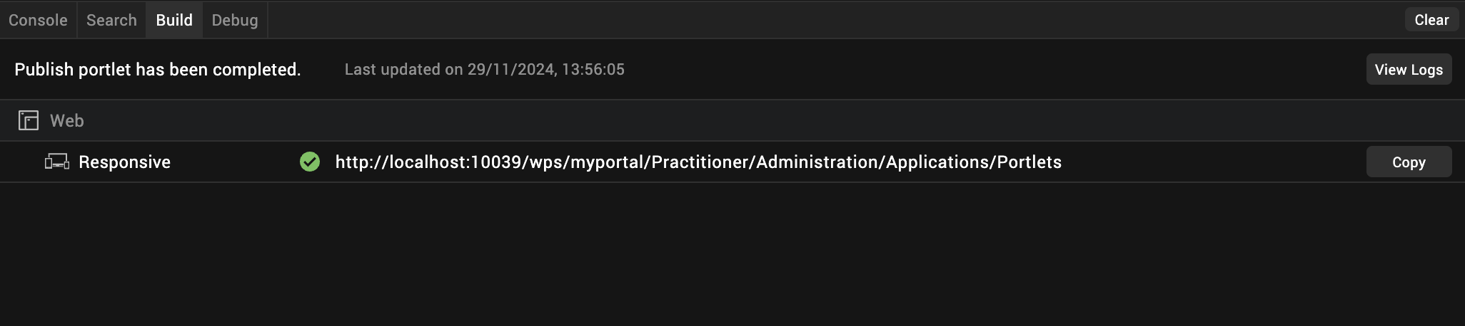

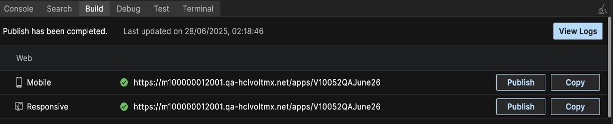

Access to the Published URL within Volt MX Iris
Once the publish is complete, the published URL is displayed on the Build tab in Volt MX App. When you click the URL, the Iris Preview window opens. For more information on the Iris Preview window, click here.
You can also click on Copy beside the URL to copy it and view the app in a web browser of your choice.
The Build tab in Iris displays the status of your app publish. If there are any errors, they appear in the Build tab. You can switch to the Console tab for a detailed view of the error logs.

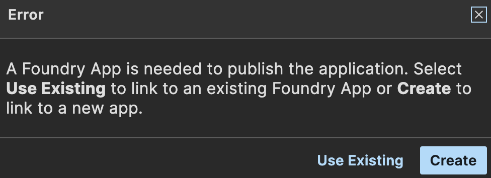

If you try to publish the app, even when you do not have an associated Volt MX Foundry app, you will get a prompt to link a Volt MX Foundry app.
To change the selected Cloud account or Environment, go to Project Settings > VoltMX Foundry. hen, click the VoltMX Foundry tab. At the top of this tab, under Volt MX Foundry Environment, select an environment from the drop-down list. Click Done. If you do not see any environments listed, you need to create one. For more information, refer Environments in the Volt MX Foundry Console User Guide.
To publish the Volt MX Iris web app to Volt MX Foundry, the app needs to be associated with a Volt MX Foundry app.
If no Foundry App is associated to your Iris project, an error message is displayed.
You must either create a new Volt MX Foundry app or use an existing one. For information on how to create a new Volt MX Foundry app, see How to Add Applications in the Volt MX Foundry Console User Guide.

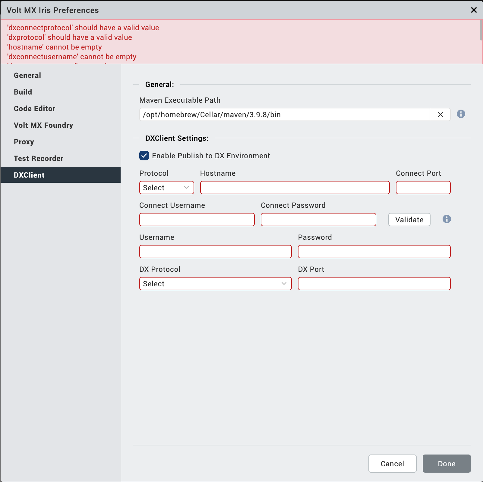

The Iris Preferences popup is now updated to support properties for seamless integration between Iris and DX. The properties are housed in a new category named "DXClient", as shown in the screenshot below.

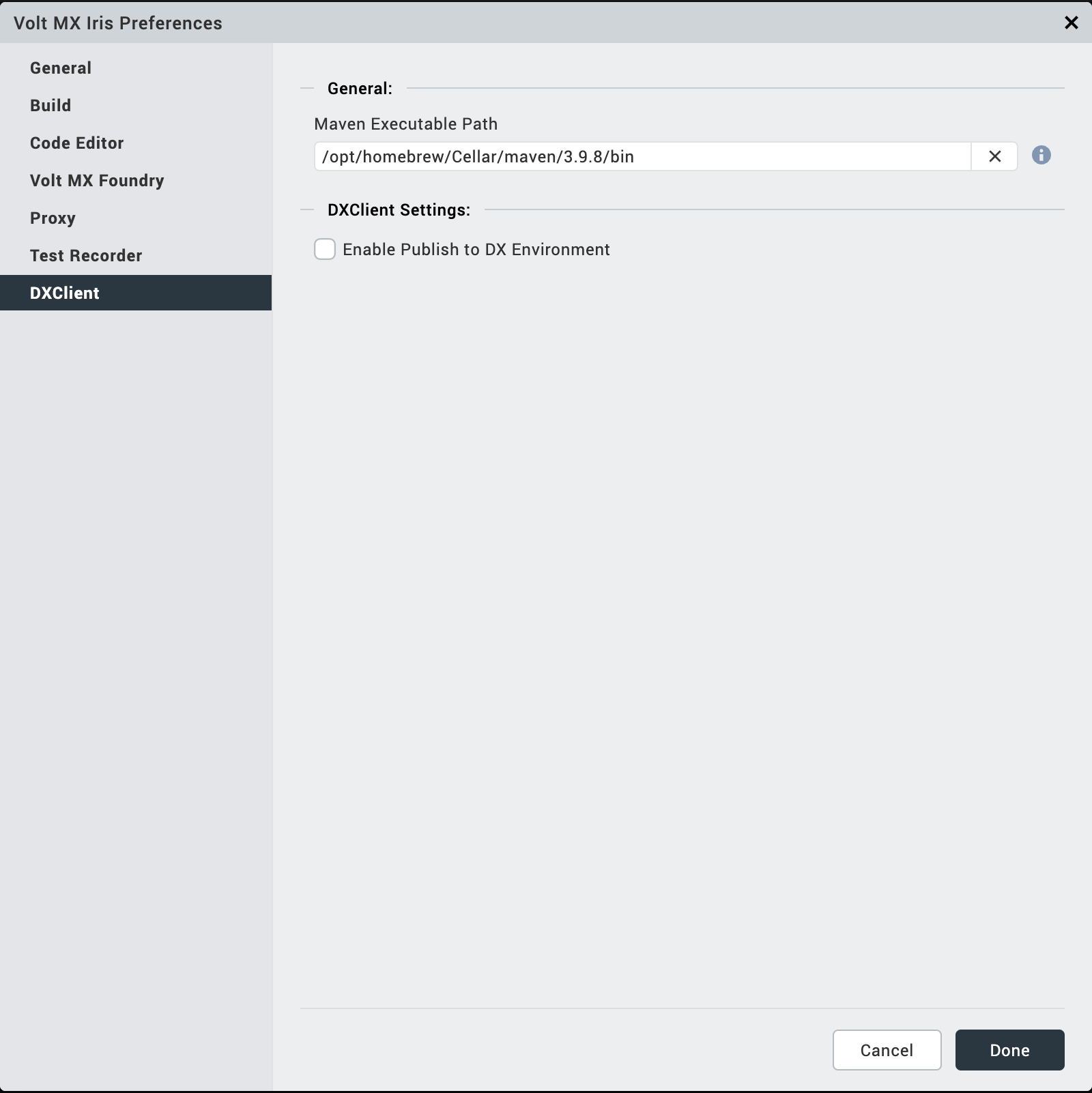

Generate a Portlet for DX

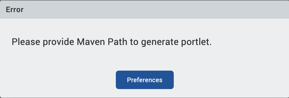

To generate a portlet, user needs to provide path to the Maven executable.
Incase the user has not provided it in preferences, an error popup is displayed at the time of application build that prompts the user to add the path.

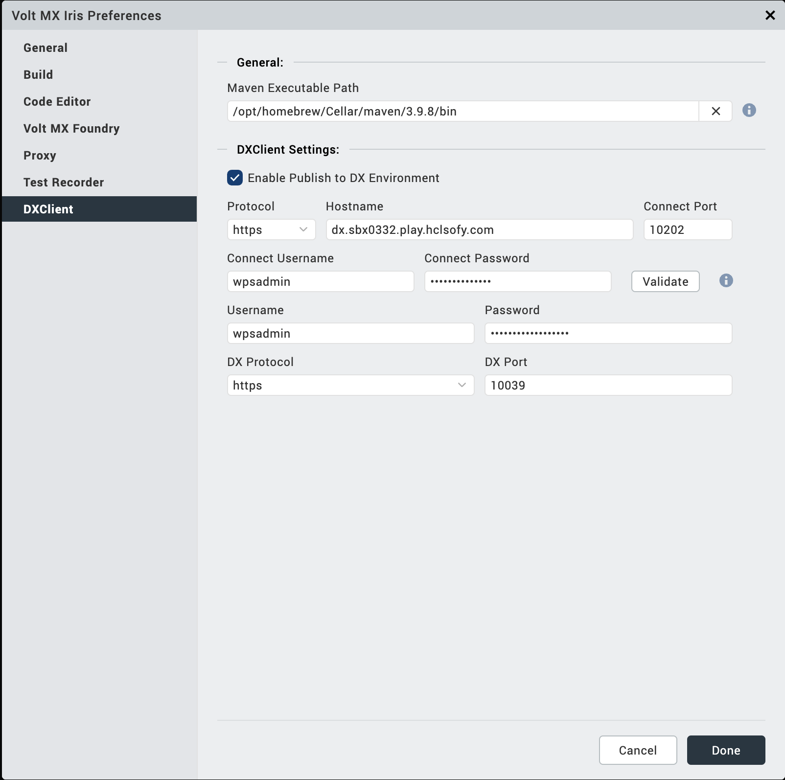

Publish a Portlet for DX

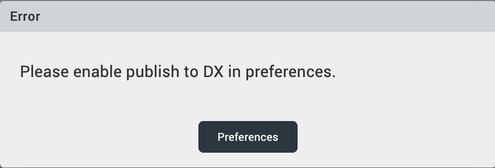

In addition to providing Maven path, user needs to add properties that are required to publish the generated portlet to a DX environment.
Incase the user has not enabled publish to DX in preferences, an error popup is displayed at the time of application build that prompts the user to enable this option.
Once all the properties are updated, the user will be able to initiate a build.
MAVEN_HOMEneeds to be added to the environment variables on Windows machines. -
If you want to connect to a DX environment with a Self-Signed Certificate, ensure that you perform at least one of the following actions:
Add the
process.env.NODE_TLS_REJECT_UNAUTHORIZED = 0;entry in the/config/default.js file. Add the
NODE_TLS_REJECT_UNAUTHORIZED = 0;entry in the Environment variables of your System. -
Ensure that Maven version 3.9.x is installed.
Ensure that Java version 8 or 11 is installed.
Folowing properties are mandatory in order to publish to an DX environment
| Property | Description |
| Enable Publish to DX Environment | This option enables the user to configure properties for publishing the MX app to the DX environment. |
| Protocol | Specifies the DX Connect protocol. |
| Hostname | Specifies the hostname of the DX environment. Example: “localhost”, “dx.sbx0032.play.hclsofy.com”. Note: Specific to Iris version 9.5.45, for host name localhost, Volt MX Iris connects to the DX environment using the http protocol. For non local hosts, https protocol is used to connect to the DX environment. |
| Connect Port | Specifies the port number of the Configuration Wizard(cw_profile). |
| Connect Username | Specifies the username that is required for authenticating to the Configuration Wizard(cw_profile). |
| Connect Password | Specifies the password that is required for authenticating to the Configuration Wizard(cw_profile). |
| Validate | Verifies if the DX environment is available based on the hostname provided. Note : Ensure that Connect Username and Connect Password are provided prior to validating. |
| Username | Specifies the DX username, which will be used to authenticate with the DX environment to publish a portlet. |
| Password | Specifies the DX password, which will be used to authenticate with the DX environment to publish a portlet. |
| DX Protocol | Specifies the DX protocol. |
| DX Port | Specifies the DX port. |

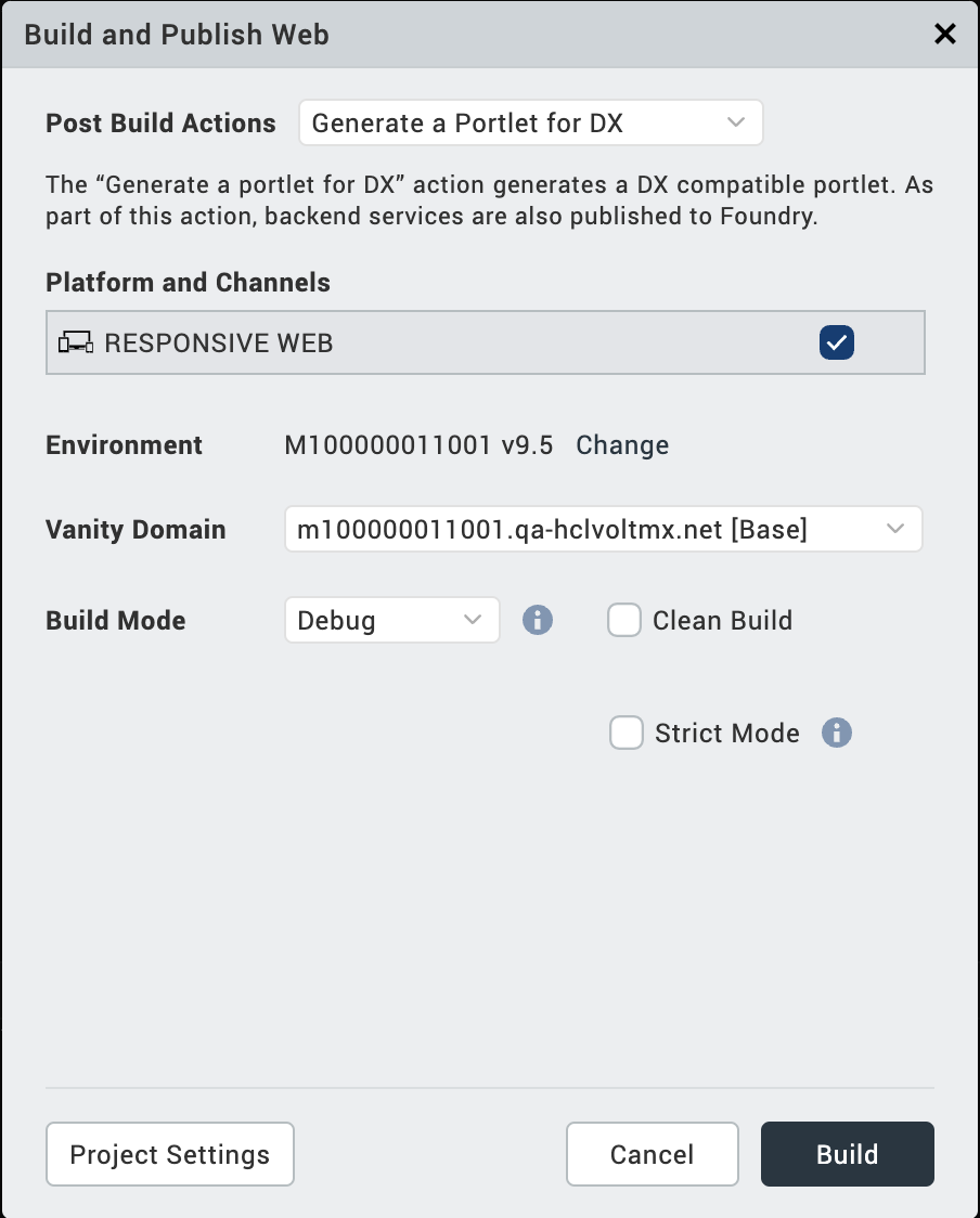

- Generate a Portlet for DX - This action generates a DX compatible portlet for your Web application and saves it on you file system.

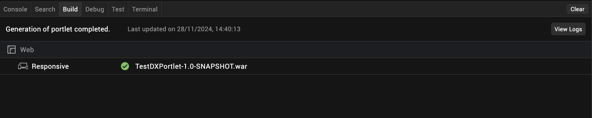

The Generate a Portlet action generates a portlet for your web application and saves it on your file system. This option also publishes the Volt MX Foundry app to the respective Foundry environment.
Once the build is complete, the generated portlet will appear in your project's workspace > binaries > TXArtifacts folder. You can then upload and publish the portlet on DX manually or using DX Client.

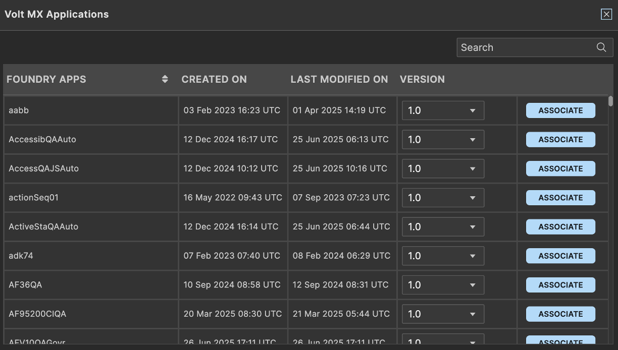

- Link your Iris Project to a Volt MX Foundry app. You can link your Project to a new or an existing Foundry app.
- On the Data & Services panel, click the hamburger menu near the Refresh button.
- Click either Create New App or Link to Existing App. The Volt MX Foundry console appears.
- If you have not already, sign in to your Volt MX Foundry account by using your cloud credentials.
- If you choose:
- Create New App, a new Foundry app with the same name as the Iris Project is created.
- Link to Existing App, a list of existing apps from your Volt MX Foundry account are displayed.
To select the Volt MX Foundry app that you want to associate your Volt MX Iris app with, click Associate beside the App Name.
The app you chose/created is successfully linked to your Iris Project.

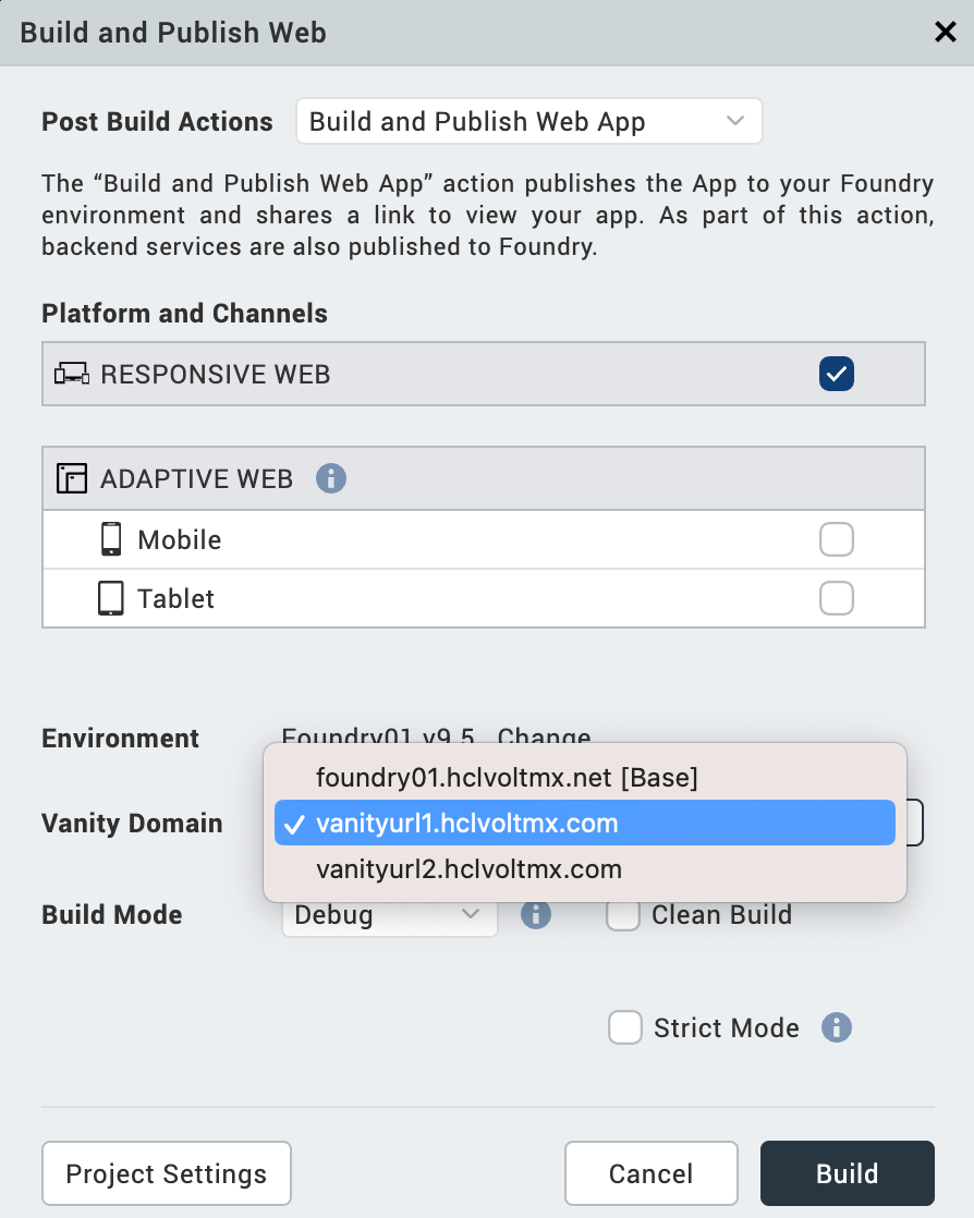

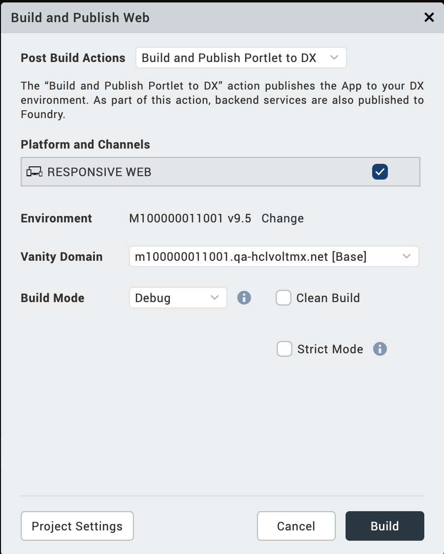

From the main menu of Volt MX Iris, select Build > Build and Publish Web.
The Build and Publish Web window appears.
Select the required Platforms and Channels for which you want to build and publish your web app.
- From the Post Build Action drop-down menu, select the desired Post Build Action. For more details about the Post Build Action, click here.
From the Build Mode drop-down list, select your desired build mode.
Debug mode - To help you identify and fix errors, Volt MX Iris emits the complete symbolic debug information . To lessen the amount of time necessary to complete the build, the build is not optimized for code execution, so it may tend to execute slower than a build optimized for release. Also, the inclusion of the symbolic debug information causes the final executable to be larger than a release build.
Release mode - Volt MX Iris optimizes the build for execution, requiring more time to generate the build. It also does not emit the complete symbolic debug information, making the final executable smaller than a debug build.
Protected Mode - Applications built in Volt MX Iris can use the additional security enhancements by building the application in the Protected Mode. Volt MX IrisPlatform code for iOS and Android is equipped with mechanisms that can protect your application by detecting attacks like tampering, swizzling, debugging, jail breaking (iOS), rooting (Android), and information disclosure. Additional security mechanisms are provided through the use of White Box Cryptography to protect application business logic and source code. Application reacts to the attack by exiting upon detecting attacks to prevent further attempts. If you choose to build an application in Protected mode, then setting the public and private keys is mandatory. To do so, go to Project Settings > Protected Mode. For more details on how to generate public and private keys, click here.
Test Mode - To help you identify and fix errors, Volt MX Iris provides the ability to Test the application on the device or an emulator. When you build an app using the Test Mode, you can leverage the Jasmine testing framework of Volt MX Iris to thoroughly test your app and ensure your application is errors free. You can run jasmine test cases, test suites and test plans by building an app using the Test mode.
You can choose to change the cloud environment on which your app will be published. To do so click on Change beside the Environment option.
You can select the Vanity Domain from the drop down. The base domain is identified by appended text “[Base]” in the displayed domain name.
Note: Change to vanity domain made in the popup is not persisted.
If you do not want to use the SHA1, MD2, MD4, and MD5 hashing algorithms in your application, check Strict Mode. If you do use any of those algorithms, leave Strict Mode unchecked. Otherwise, you will receive an "Unsupported algorithm" error message.
Once all the required settings are ready, click Build.
The progress of the Web App Publish is displayed in the Build tab of Iris.
Once the publish process is complete, a Web App URL appears on the Build tab. - Click on the generated URL to preview your Web app in the Live Preview mode.
The Iris Preview window appears. You can use this window to debug the application. - You can also click on Copy to copy the URL to your clipboard and view it in a web browser of your choice.
- Click on View Logs to access the logs of the publish process.
- An Application was deployed mail will also be sent to your registered e-mail account. This mail will contain the App details along with the App URL. Click on the URL in the mail to open the web app in your default web browser.

- From the Post Build Action drop-down menu, select the Generate a Portlet for DX as a Post Build Action. For more details about the Post Build Action, click here.
Protected Mode - Applications built in Volt MX Iris can use the additional security enhancements by building the application in the Protected Mode. Volt MX Iris platform code for iOS and Android is equipped with mechanisms that can protect your application by detecting attacks like tampering, swizzling, debugging, jail breaking (iOS), rooting (Android), and information disclosure. Additional security mechanisms are provided through the use of White Box Cryptography to protect application business logic and source code. Application reacts to the attack by exiting upon detecting attacks to prevent further attempts. If you choose to build an application in Protected mode, then setting the public and private keys is mandatory. To do so, go to Project Settings > Protected Mode. For more details on how to generate public and private keys, click here.
The progress is displayed in the Build tab of Iris. Once the build process is complete, a link to the generated portlet appears in the Build tab.
Click on the generated link to navigate to the generated portlet in your file explorer.

From the main menu of Volt MX Iris, select Build > Build and Publish Web. The Build and Publish Web window appears.
Select platform Responsive Web.
- From the Post Build Action drop-down menu, select the Build and Publish Portlet to DX as a Post Build Action. For more details about the Post Build Action, click here.
- Once all the required settings are ready, click Build.
Once the publish process is complete, a URL to the Manage Portlet section in the DX environment appears in the Build tab. - Click on the generated URL to view the deployed portlet in the DX environment.
You can also click on Copy to copy the URL to your clipboard and view it in a web browser of choice.
