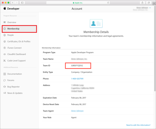

  • For iOS, make sure to obtain a 10-digit development team identifier from Apple. The Team ID can be found in the Membership Details of your Apple Developer account.
Note: The Team ID must not include spaces. Otherwise, the IPA generation in Volt MX Iris fails.

  5. Provide profile key chain password, export method, and Team ID.
    keychain.password=p@ssword
            #Possible values for method are "app-store", "ad-hoc", "enterprise", "development"
            method="development"
            #Examples for development.team are "G9B5P7QDV2", "PM7453S8QE"
            development.team="G9B5P7QDV2"
