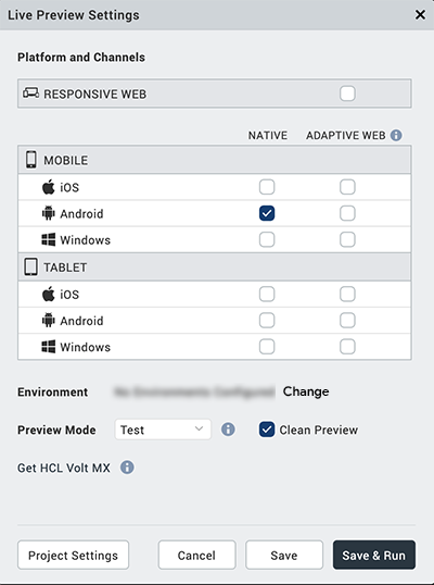

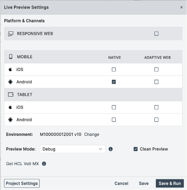

  1. In Iris, from the main menu, navigate to Build > Live Preview Settings.
    The Live Preview Settings window appears.
  2. Select the platforms and channels for which you want to build the application.
  3. From the Preview Mode drop-down list, select the Test mode.
  4. Click Save and Run.

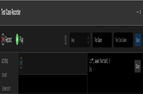

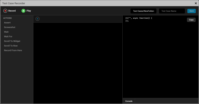

  5. In Iris, from the Project Explorer, go to Test Resources > Jasmine.
  6. Expand the required < channel >, right-click on Test Cases or any of the sub folders and select Create a Test Case.
    The Test Case Recorder window appears.
    When you minimize the Test Case Recorder window, a View option appears in the Test tab on the lower pane of Iris. You can click View to re-open the window that you have minimized.
    When you minimize the Test Case Recorder window while playing a test case, a progress bar appears in the Test tab indicating the progress of test case being played. Once the test case is played completely, a toast message appears on the lower-right of Iris.
    After minimizing the Test Case Recorder window, a few options such as Edit, Delete, and Rename* are disabled for the test files. Also, the options to create a new Test Case, Test Suite, or Test Plan are disabled.
  7. Re-launch the application.
    The device connects successfully.
    Note: If the device does not connect successfully, refer this FAQ.
  8. On the upper-left corner of the window, select Record to start the recording.
    Note: Any activity performed by a user on the application is recorded until the user clicks Stop.
  9. After the recording starts, a stop option appears in the Test Case Recorder window. To discontinue the recording, click Stop.
    You can now edit the test case to add more actions, if required. To know more about editing the test case, click here.
  10. On the upper-right corner of the window, type a name for the test case and click Save.
    The test case is created.

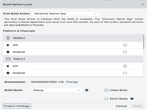

If you want to connect to a native device instead of viewing the app using live preview, ensure that your system and the device on which you want to run the app are on the same network.
In this case, follow these steps to create a test case:

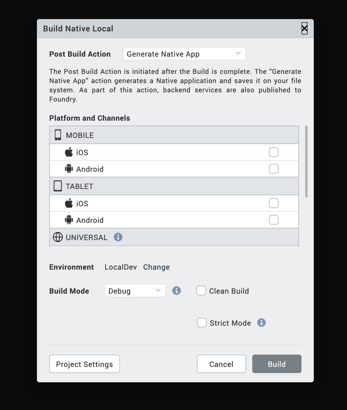

  1. In Iris, from the main menu, navigate to Build > Build Native Local.
    The Build Native Local window appears.
    Note: The Build Native Local feature enables you to build an app on the local machine. To know more about the feature, click here. If you want to build the app on the cloud, select Build and Publish Native.
  3. From the Post Build Action drop-down menu, select Run on my Device.
  4. From the Build Mode drop-down list, select the Test mode.
  5. Click Build. The build generation begins. You can check the status of your build in the Build tab. If there are any errors, they appear in the Build tab.
    Once the build is completed, the app is launched on the device.

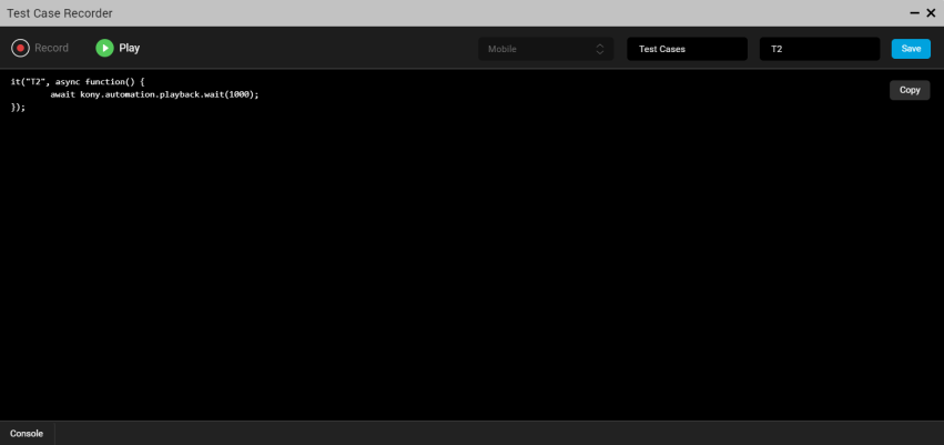

You can edit the test case to add certain actions without having to record from the device. For every activity that is recorded such as a button click or entering text, you can add several other actions before or after the activity in the Test Recorder. You can edit a test case in the following ways.

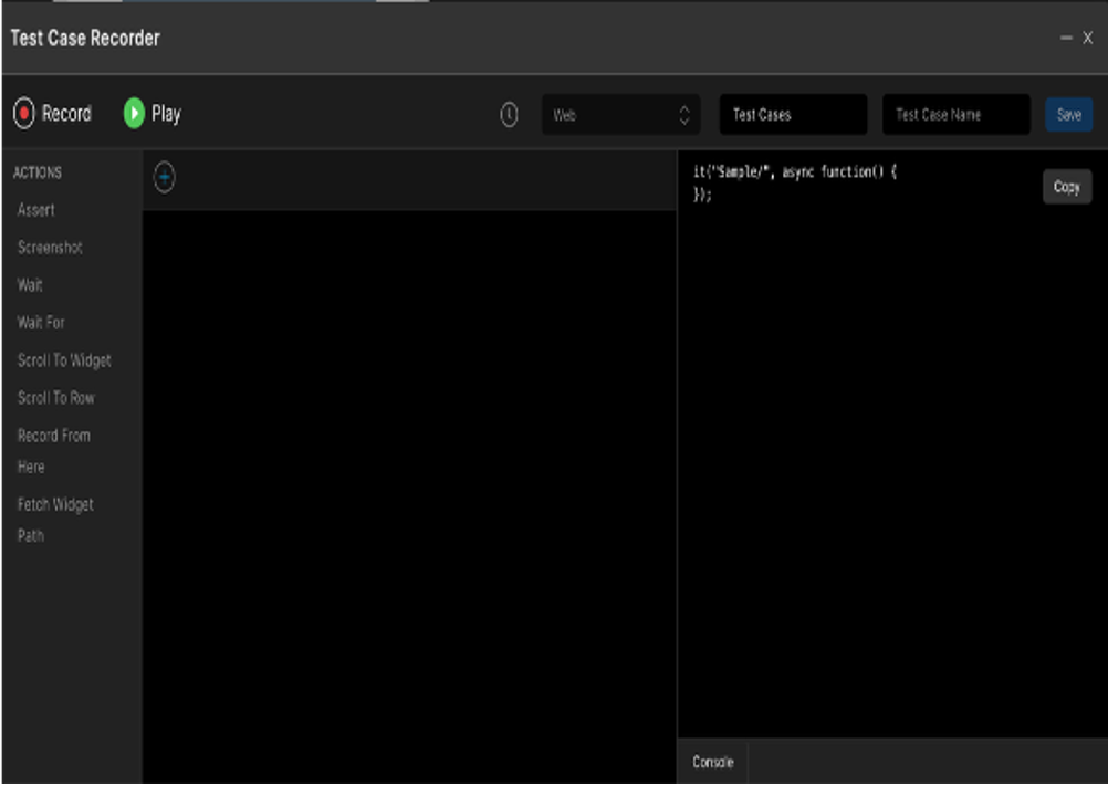

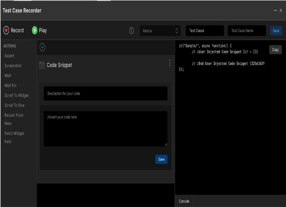

Edit a Test Case Using Test Recorder
Using the Test Recorder, you can edit a test case while creating the test case or after the test case is created.
To edit a recorded test case, follow these steps:
  1. From the Project explorer, navigate to Test Resources > Jasmine > < channel > > Test Cases.
  2. Right-click a test case and click Open in Test Recorder.

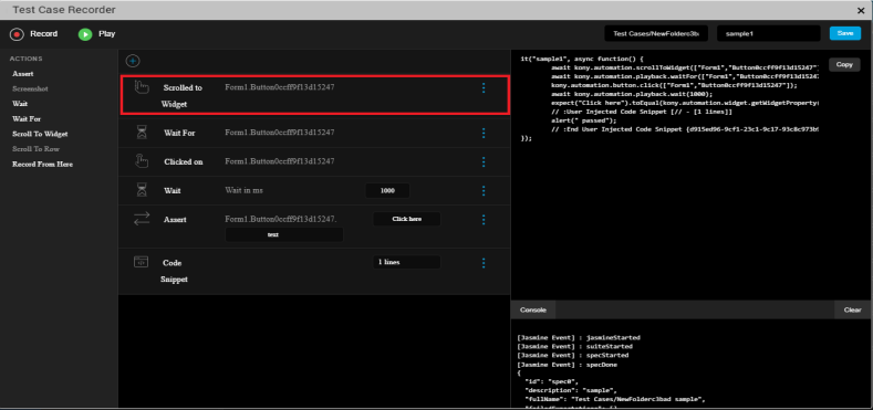

  3. Select any user activity that is recorded.

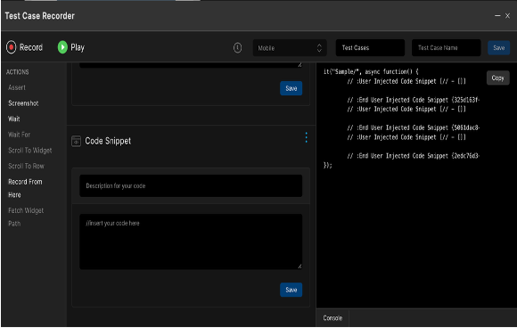

  4. Click the add icon to add any of the following actions to the top of the canvas:
    • Insert Code Snippet: Enter the code and description and click Save.
    • Wait: Delays the selected action by specified period of time.
    • Fetch Widget Path: This action enables you to get the path of a widget in the application by selecting the widget. The application can be launched in the device, web browser, or in the Live Preview window. To get the path of any widget in the Test Recorder window, follow these steps.
      1. From the top-left of the Test Recorder window, click Record.
      2. From the top of the canvas, click the add icon, and select Fetch Widget Path .
      3. Select the required widget in the application.
        A new node with the path of the widget is added to the canvas of the Test Recorder window.
      4. To complete the Fetch Widget Path action, select any of the following actions from the left of the Test Recorder window as per your requirement: Wait For, Assert, and Scroll to Widget.
      Note: In iOS platform, Fetch Widget Path action is not supported for FlexForm, FlexScrollContainer, and FlexContainer widgets.
      Note: In Android platform, you cannot perform any scrolling actions after the Fetch Widget Path action is performed. You must perform the scrolling action before the Fetch Widget Path action.
  5. From the Actions panel, select any of the following actions for the corresponding user activity.

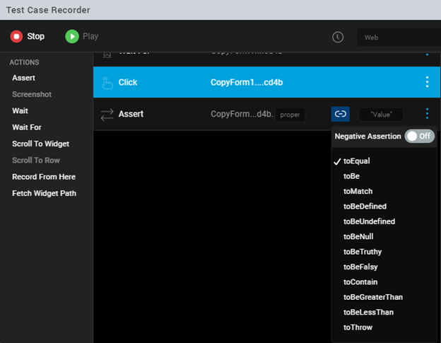

    • Assert: Validates the value of a specified property for any widget.
    In Volt MX Iris V9 SP 2 GA, when you add an assert action in the Test Case Recorder window, you can view the link icon in the assert statement. Click the icon to view a list of options that you can use to customize the type of assertion to be applied on the specified property of the widget.
    This feature allows you to add custom matches for any test case that improves the test automation.
    Prior to the V9 SP2 release, the default matcher was configured as expect(a).toEqual(b) and if a developer wanted to add a new match, they had to add the code manually.
    The following types of Assertion options are available:
    Important: When you toggle the button next to the Negative Assertion option to On, all the Assertion options turn into Negations.
    • The toBe matcher compares with ===.
    • The toEqual matcher works for simple literals and variables.
    • The toMatch matcher is for regular expression.
    • The toBeDefined matcher compares against an undefined value.
    • The toBeUndefined matcher compares against undefined.
    • The toBeNull matcher compares against a null value.
    • The toBeTruthy matcher performs boolean casting testing.
    • The toBeFalsy matcher performs boolean casting testing.
    • The toContain matcher finds an item in an Array and a substring.
    • The toBeLessThan matcher performs mathematical comparisons.
    • The toBeGreaterThan matcher performs mathematical comparisons.
    • The toThrow matcher tests whether a function throws an exception.
    • Screenshot: Takes a screen shot of the app on the device. This action is applicable on native applications only and not on Desktop web applications.
    • Wait: Delays the next action for a specified period after the selected action is performed. The time period is in milliseconds.
    • Wait For: This is applied to the widget involved in the selected user activity. Delays the selected action until the widget being awaited appears.
    Note: In Volt MX Iris V9 SP 2 GA, on a new form, when a new action is performed, the Test Case Recorder automatically adds the Wait For statement to the recording.
    • Scroll To Widget: Scrolls to a specified widget on the application.
    • Scroll To Row: Scrolls to a specified row of the Segment widget.
    • Record From Here: Starts the recording from the selected action in the recording.
      2. From the left of the Test Recorder window, select Fetch Widget Path .
  6. To open context menu for a recorded step in the canvas, click on the three dots corresponding to it:
    • Insert Code Snippet: To add a code snippet after the selected action, click this option. Enter the code and description and click Save.
    • Wait: To introduce a delay before the selected action, click this option. It delays the selected action by specified period of time.
    • Edit: To edit the path of the widget (if applicable) in the current selection, click this option. Modify the widget path, and then click anywhere outside the box. If the step under consideration is a code snippet, then this option will expand the code snippet area.
  7. On the top-right corner of the Test Case Recorder window , click Save.
    A new _.js file will be created for the respective channel.
You have successfully edited the test case. To run the edited recording, click Play.

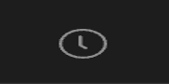

Add Timeout For a Test case
In Volt MX Iris V9 SP 2 onwards, a developer can configure the timeout for a test case in the Test Case Recorder window. Prior to the V9 SP2 release, a default timeout of five seconds (in the milliseconds unit, 5000 MS) was configured, and developers couldn't customize the timeout value.
Note: If the test case takes longer than the configured time, Jasmine interrupts the test case and the test case fails.
To add a timeout value for a Test Case, follow these steps:
  1. From the Project explorer, navigate to Test Resources > Jasmine > channel > Test Cases.
  3. Click the timeout icon.
  4. Enter the timeout value. For example, 10000 MS.
    By default, the timer is configured to 5000 MS.
  5. Enter a name for the test case in Test Case Name .
    The test case is automatically saved.

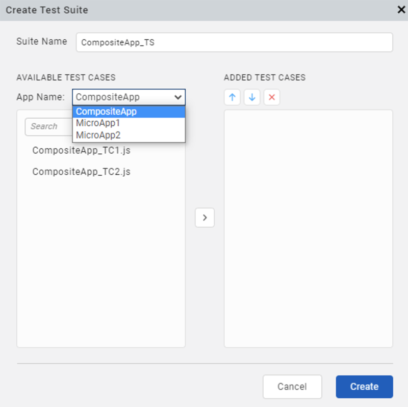

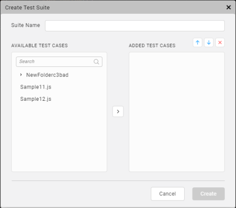

Test Suite
Test Suite is a collection of several test cases. Create a test suite to group various test cases and run them in an order in which they are grouped.

Create a Test Suite
Follow these steps to create a test suite:
  1. From the Project explorer, go to Test Resources > Jasmine.
  2. Expand any channel, such as Mobile, and go to Test Suites.
  3. Right-click on Test Suites and select Create a Test Suite. The Create Test Suite window appears.
  4. From the available test cases, select the test cases that you want to add to the test suite.
  5. Drag and drop the selected test cases in the ADDED TEST CASES pane.
    By using the up and down icons, you can change the sequence to the order in which you want the test cases to run.
    If you want to remove a test case from the test suite, select the test case and click the delete icon.
  6. Type a name in the Suite Name box and click Create.
    A new < testSuite.js > file is created in the Test Suites folder.
You have successfully created a test suite. To edit the test suite, navigate to the Project explorer, right-click on the test suite and select Edit Test Suite. Once the modifications are done, click Save.

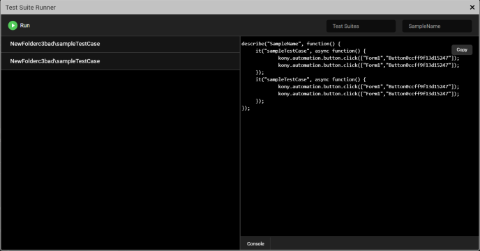

    The VoltMX Iris Test Suite Runner window appears.
    The left pane of the window displays all the test cases in the specified test suite.
    The right pane of the window displays the code in the order of the test cases. On selecting a test case from the left pane, the corresponding code on the right pane is highlighted.
    The Console tab displays the results of the test.
    When you minimize the Test Suite Runner window, a View option appears in the Test tab on the lower pane of Iris. You can click View to re-open the window that you have minimized.
    When you minimize the Test Suite Runner window while running a test suite, a progress bar appears in the Test tab indicating the progress of test suite that is running. Once the test suite is run completely, a toast message appears on the lower-right of Iris.
    After minimizing the Test Suite Runner window, a few options such as Run, Edit, Delete, and Rename* are disabled for the test files. Also, the options to create a new Test Case, Test Suite, or Test Plan are disabled.
    Note: If you want to play all the test cases in the test suite, click Run on the upper-left corner of the Test Suite Runner window.

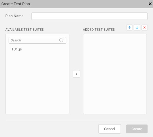

Create a Test Plan
You can create a new test plan from the Project explorer. Once a test pan is created, a corresponding JavaScript file is created.
To create a new test plan, follow these steps:
  1. From the Project Explorer, go to Test Resources > Jasmine.
  2. Expand the channel where you created the test cases and test suites earlier.
  3. Right-click on Test Plans and click Create a Test Plan.
    The Create Test Plan window appears.
  4. From the available test suites, select the test suites that you want to add to the test plan.
  5. Drag and drop the selected test suites under ADDED TEST SUITES.
    By using the up and down arrow icons, you can change the sequence to the order in which you want the test suites to run.
    If you want to remove a test suite from the test plan, select the test suite and click the delete icon.
  6. Type a name in the Plan Name box and click Create.
    The < PlanName.js > file is created in the Test Plans folder.
  7. If you want to edit the test plan that you have created, right-click on the file and select Edit Test Plan.
    Click Save after the modifications are made.

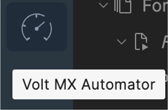

Volt MX Automator

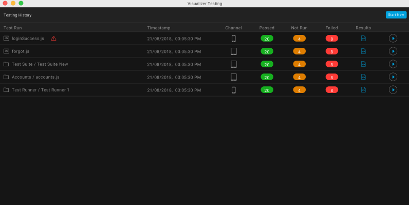

Volt MX Automator is a one-stop shop where you can view the latest executed test cases. You can find more details about the time of execution of a test, channel on which a test is executed, and the test results. You can open the VoltMXAutomator window by clicking the following icon in the left navigation bar of Volt MX Iris.
You can view the last five tests executed on the Dashboard and the recorded test scripts, if you want. In addition, you can record a new test case from the Dashboard without having to navigate to the Test Resources folder in the Project explorer.
Using Dashboard, you can perform the following tasks:
You can find the VoltMX Automator icon on the left navigation bar of Iris. Click the icon to open the Dashboard window.
View the Testing History

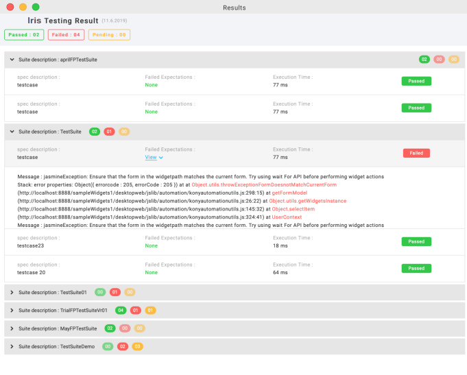

The Dashboard displays the information about the last five test results of the application. The latest tests that have executed can be test cases or test suites.
The Dashboard window displays the following details for each of the five tests that have been executed:
  • Time stamp: The time at which the test was executed.
  • Channel: The channel on which you ran a test case or test suite.
  • Passed: The number of the test cases that ran successfully.
  • Not Run: The number of ignored test cases that the user do not want to run.
  • Failed: The number of test cases that failed due to errors.
  • Results: Click on the file to view the test results of each test suite.

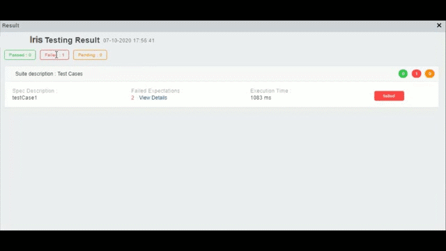

    The number of passed test cases, failed test cases, and pending test cases are displayed across each test suite. Furthermore, you can expand the test result of each test suite to view more information such as: * Spec description: Displays the name of the test case. * Failed exceptions: Displays the location of errors in the test case along with the file location.
    In Volt MX Iris V9 SP 2 , in the Results window, when you click View Details option, details of failed expectations appear. Details include the name of the test case, code line number, column number, jasmine message, stack trace, and the associated screen-shot of the failure. When you click on the screen shot, the image maximizes.
    • Execution Time: Displays the time taken by a test case for completing the execution.
View the Recording of an Executed Test Script
In the Dashboard window, a play icon is displayed for each of the latest five tests that have been executed.
You can click the play icon to run the recorded test script.

  1. From the main menu, click Build > Live Preview Settings.
  2. In the Platform and Channels section, select the appropriate checkboxes.
    For the Preview Mode, select Test.
  3. Click Save and Run.
    The app launches on the device. In case of Inline preview, the Iris Preview window appears.
  4. From the left navigation bar of Iris, click the VoltMX Automator icon.
    The Dashboard window appears.
  5. In the upper-right corner of the window, click Start New.
  6. From the Iris Preview window, re-launch the application.
  7. On the upper right corner of the Test Case Recorder window, select the channel for which you want to create the test case.
  8. On the upper-left corner of the Test Case Recorder window, select Record to start recording a test script.
    After the recording starts, a stop option appears.
  9. To discontinue the recording, click Stop.
  11. To play the recorded script, re-launch the app and click Play.
    The recorded script plays in the Iris Preview window.
    You can view the result of the test case in the Console tab.
Deploy the Test Resources
A testPlan.js file is present for each channel and is executed when the app is launched without opening the test recorder. After the test scripts are generated, deploy the test resources to retrieve the test scripts from the server and test the application.
To deploy your application, follow these steps:
  1. In Iris, from the Project explorer, go to Test Resources > Jasmine.
  2. Right-click on Jasmine and select Deploy.
The results of the deployment will be available in the HTML format ](with the TestResult_dd-mm-yyyy_hh-mm-ss.md nomenclature), in the following locations based on the platform.

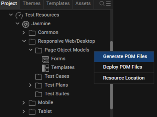

  • The testPlan.js file is the point of entry for the execution of the Jasmine Test Resources. Therefore, ensure that you always push the testPlan.js file into the repository.

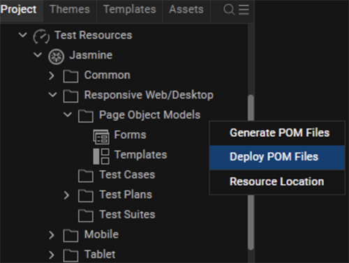

  • From the V9 ServicePack 5 release, ensure that you push the Page Object Model Files (pom files) into the repository.

From the Volt MX Iris V9 Service Pack 3 release, the Volt MX Test Automation Framework creates a test data file for the input data of each Test Case that the user records. The test data file is an editable JavaScript (.js) file that is present at the same location as the Test Case, with the name of the Test Case appended with _data. For example, if a Test Case with the name tc1.js is present at Test Cases/folder1/tc1.js, the test data file is created with the name tc1_data.js in the same location (as Test Cases/folder1/tc1_data.js).
Important: For Test Cases that were recorded prior to the Volt MX Iris V9 Service Pack 3 release, the test data file is not created. However, if you add or edit any steps in the Test Case recording after upgrading Volt MX Iris, the data for those steps is externalized in the TestCase.js file, and is added in a corresponding data file.
The test data file is a JS file that contains an automatically generated dataset with the key dataset and the value as a unique global object .This dataset stores the recorded input data for each step of the Test Case. For better readability, the input data in a dataset is further divided into the following types based on the actions:
  • input : Data associated with the following widget actions is captured in the input key:
  • Input text in the TextArea and TextBox widgets.
  • Sliding of the Slider widget.
    Note: The input values for the Slider widget must be provided only in numbers. The JSON key-value pairs are created for each slider action after validating the input data. If you do not provide valid values, the input textbox displays a tooltip about the error, and you will not be able to Play or Save the Test Case or Close the Test Case Recorder window.
  • Clicking an item from a RadioButtonGroup widget.
  • assert : The data associated with the Assert actions in the Test Case Recorder window is captured in the assert key.

Here is a sample Test Case file after data externalization:
it("tc1", async function() {
    var _data = testcaseData_1616407300354.dataset;
    await voltmx.automation.playback.waitFor(["Form1","tb1"]);
    voltmx.automation.textbox.enterText(["Form1","tb1"],_data.input.tb1);
    expect(voltmx.automation.widget.getWidgetProperty(["Form1","tb1"], "text")).toEqual(_data.assert.tb1);

Create a Test Suite for Micro App Projects
You can create a Test Suite that contains test cases from the application and its dependent Micro Apps (if there are any linked Micro Apps).
  1. From the Project explorer, expand Test Resources > Jasmine.
  2. Expand any channel, such as Mobile.
  3. Right-click Test Suites, and then select Create a Test Suite. The Create Test Suite window appears.
  4. From the Available Test Cases section, select the test case that you want to add to the test suite.
Note: The Available Test Suites section displays a list of all the test suites available in the Base App. To add test suites from a dependent micro app, select the Micro App from the App Name drop-down list.
Click the forward arrow (>) or drag and drop the test case to add the test cases in the Added Test Cases section.
Note: By using the up and down arrow icons, you can change the sequence order in which you want to run the test suites.
Type a name in the Plan Name box and then click Create or Save.
The Test Plan is successfully created.

Generate Page Object Model Files
Volt MX Iris generates the Page Object Model files for all the Forms, Components, and Templates present in the app. You can generate Page Object Model files for the complete project or each channel separately.

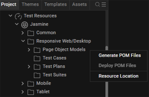

Follow these steps to generate the Page Object Model Files for a specific channel (Mobile, Tablet, or Responsive Web):
  1. From the Project Explorer, navigate to Test Resources > Jasmine.
  2. Expand any channel (Mobile, Tablet, or Responsive Web) and right-click Page Object Models.
  3. From the context menu that appears, select Generate POM Files.
Volt MX Iris generates the POM files, and the files appear in the Test Resources > Jasmine > < Channel > (Mobile, Tablet, or Responsive Web) > Page Object Models section of the Project Explorer.
Note: To generate the Page Object Model files for the complete project, from the Project Explorer > Test Resources section, right-click Jasmine, and then select Generate POM Files.

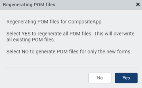

  • If you try to generate the Page Object Model files for a channel that already has Page Object Model files, Volt MX Iris displays a prompt to regenerate the Page Object Model files in the Regenerating POM Files dialog box.
    Click Yes to regenerate and overwrite the existing POM files.
    Click No to only generate the POM files for the new Forms.

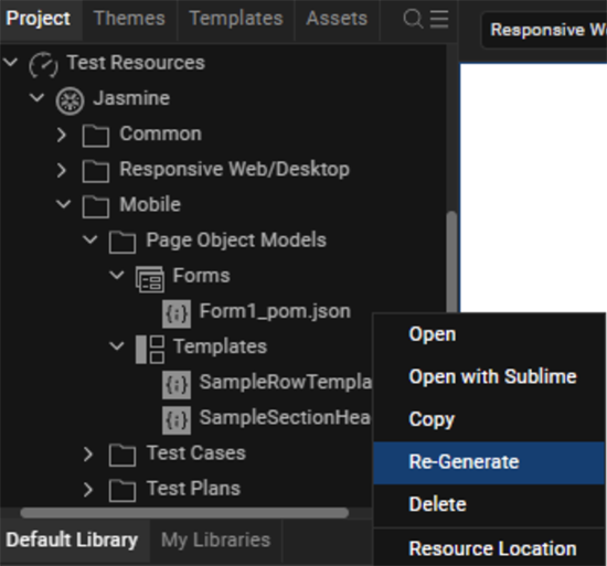

Regenerate Page Object Model Files
When you make changes to the elements of a Form or Template, you must regenerate the Page Object Model file for the updates to be captured.
Follow these steps to regenerate the Page Object Model Files:
  2. Expand the channel (Mobile, Tablet, or Responsive Web) in which the Form or Template has been updated.For Component updates, expand the Common folder.
  3. Expand the Page Object Models > Forms (or Templates or Components) folder, and right-click the POM file that must be generated again.
  4. From the context menu that appears, select Re-Generate.
Volt MX Iris regenerates the specified Page Object Model file, and the updated POM file appears in the Test Resources > Jasmine > (Mobile, Tablet, Responsive Web, or Common)> Page Object Models section of the Project Explorer.

Follow these steps to deploy the Page Object Model Files at the channel-level:
  2. Expand any channel and right-click Page Object Models.
  3. From the context menu that appears, select Deploy POM Files.
Volt MX Iris deploys the POM files, and a deployment success message appears in the Console.
Note: Deploy the Page Object Model files at the channel- level if you want to run standalone Test Cases and Test Suites.
