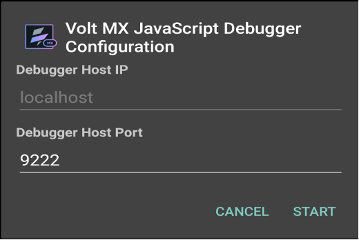

    The device must connected using a USB connection. If you have specified a port other than 9222 as your Android debugger port in:
    • Volt Iris: In the Window menu, click Preferences. From the Preferences dialog box, click VoltMX Iris and update the Android Debugger Ports setting to use the same port.
    • Volt Iris: In the Edit menu, click Preferences. From the Preferences dialog box, click Build and update the Debugger ports to use the same port.
  3. Click Start in the emulator. A Waiting for the Debugger message appears.

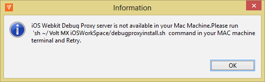

brew install ios-webkit-debug-proxy

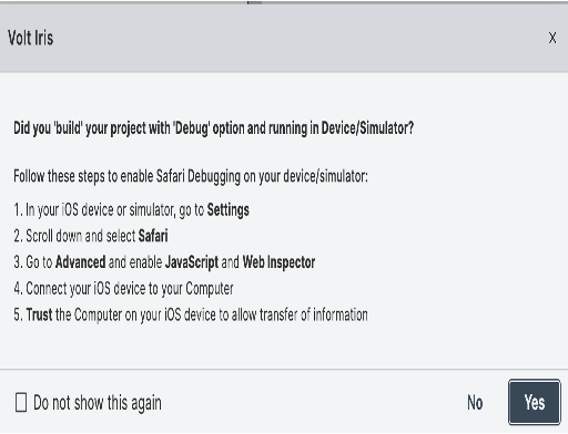

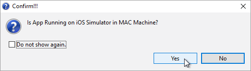

  3. Volt Iris displays a dialog box confirming whether the app is running in an iOS simulator on a Mac computer.

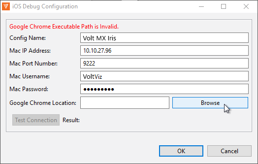

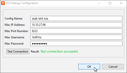

  4. If you click Yes in the dialog box and you're running Volt Iris on a Windows computer, Volt Iris displays a dialog box prompting you for information so that the debugger can connect to the Mac computer running the iOS simulator. Once you have entered the needed information, click Test Connection. If the connection is configured properly, the Result reads Test connection successful. Click OK.
  5. Volt Iris tests to see if it can locate Google Chrome on your computer. If it does not find Chrome in the Program Files folder, a Google Chrome Location field appears in the above dialog box. Click its corresponding Browse button to locate the Chrome executable.
  6. Once the connection to the Mac computer running the simulator is established and Volt Iris has verified the location of Google Chrome, Volt Iris launches the iOS WebKit Debug Proxy tool. If Volt Iris does not find the iOS WebKit Debug Proxy tool, it prompts you to manually run the necessary script file on your Mac computer.

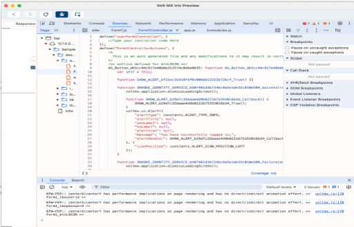

  7. Upon the successful start of the iOS WebKit Debug Proxy tool, Volt Iris opens a new Google Chrome debugger window. JavaScript files that you open appear on the Sources panel of the window, and you can add breakpoints and step through the code using the Debugger panel.
You can then use the Google Chrome debugger to debug the application. For information on using the Chrome debugger, see Get Started with Debugging JavaScript in Chrome DevTools on the Google Chrome website.

To get started with debugging iOS native applications, you must enable Developer Settings on your iOS device. If your Mac has an OS earlier than Mojave, the Developer settings are automatically configured. If your Mac has Mojave OS or later, configure Mojave OS Specific settings.
Once you are done configuring the settings, you can Build iOS Native Application in the Debug mode and then further, Debug the iOS Native Application using Safari Browser.
iOS Device Developer Settings
For the debugging to work, you must enable the Web Inspector developer tool on your device before debugging an application. To enable Web Inspector tool, follow these steps:
  1. On your iOS device, open Settings.
  2. Go to Safari > Advanced.
  3. Toggle the button next to JavaScript to enable JavaScript in the Safari browser.
    Toggle the button next to Web Inspectorto debug iOS native applications.

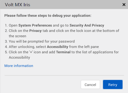

For the Mac OS versions Mojave and later, full disk access and accessibility must be provided to the Terminal due to enhanced security of newer Mac OS versions.
For the debugger to run on your Mac, follow these steps:
  1. In your Mac, go to System Preferences > Security and Privacy.
  2. Click the Privacy tab, and then click the lock icon at the bottom of the screen. You may receive a password prompt.
  3. If the password prompt appears, enter your password.
  4. Once you can access the settings, from the left pane, select Full Disk Access .
  5. Click the + icon to add the Terminal to the list of applications with Full Disk Access.
  6. From the left pane, select Accessibility.
  7. Click the + icon, and then add Terminal to the list of applications for accessibility.
Note: If Iris fails to automatically communicate with Safari to launch Web-inspector, you must debug the application manually.

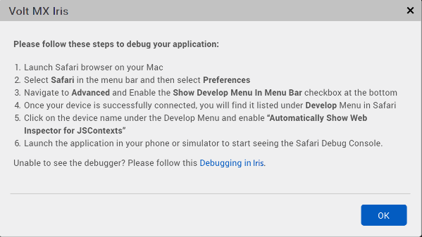

If the application debugging fails and the Safari web browser does not launch automatically, you must configure the following steps manually:
  1. Launch Safari web browser.
  2. From the menu bar, go to Safari and click Preferences.
  3. In the Preferences menu, click Advanced.
  4. Select the Show Develop Menu In Menu Bar check box.
  5. Connect your device to your Mac system using a USB.
  6. From the menu bar, click the Develop menu, you will see the device name that is connected to your Mac system.
  7. Click on the device name and enable Automatically Show Web Inspector for JS Contexts.
  8. Launch the application on your device to see the Safari Debug Console.

Note: By default, the Android debugger uses port 9222. If there is a conflict, you can change the port that the debugger uses.
In Volt Iris, in the Window menu, click Preferences. From the Preferences dialog box, click VoltMX Iris and update the Android Debugger Port settings. In Volt Iris in the Edit menu, click Preferences. From the Preferences dialog box, click Build and update the Debugger ports settings.

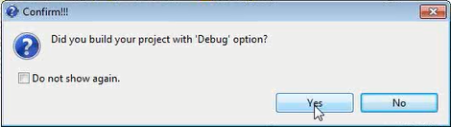

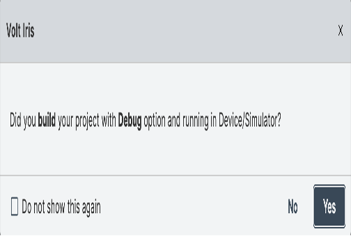

  3. A confirmation dialog box appears asking if the project was built with the Debug option. If you know that it was, click Yes. Otherwise, click No, which ends the debug process.
    Note: To debug applications in Volt Iris, you must have built the application using the Build Mode Debug. To do so, in the Build dialog box, select Debug from the Build Mode drop-down list.
  4. Volt Iris displays a popup that the debugging has started. Open your Google Chrome browser and enter the URL displayed in the popup into the address bar of the browser. The URL will be as follows, chrome-devtools://devtools/bundled/inspector.html?experiments=true&v8only=true&ws=127.0.0.1:
    For example,
    chrome-devtools://devtools/bundled/inspector.html?experiments=true&v8only=true&ws=127.0.0.1:9222
    JavaScript files that you open appear in Sources panel. You can add breakpoints and step through the code using the Debugger panel.
