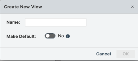

Create a New View for a Component
Once you create a Component with contract, you can create different views for it.
To create a new view for a component, follow these steps:
- In the Project Explorer, navigate to the Templates tab.
- Expand the Components node, and then select the Component for which you want to create the new view.
- Right-click the component, and then select Create New View.
The Create New View dialog box appears.
Enter a Name for the new view, and then click OK.
If you want to mark this new view as the default view for the component, select the Yes value for the Make Default button.
The new view appears in the Templates tab, and the Controller and Actions Controller JavaScript files for the new view are added in the Modules node of the component.

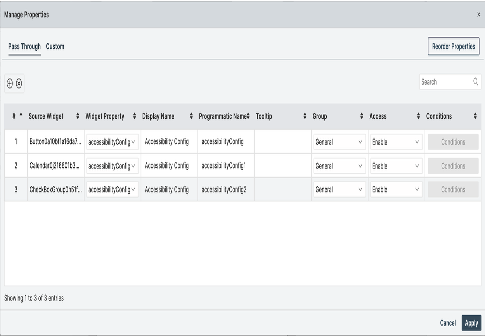

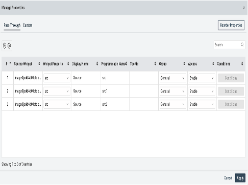

- Click Manage Properties. displays the Manage Properties dialog box.

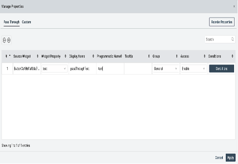

- To define pass through properties, select the Pass Through tab on the Manage Properties dialog box.
Click the plus sign (+) for each pass-through property you want to define. Click the delete symbol (X) to delete an existing property. To define a new pass-through property, specify the following for each property:
- Source Widget — The widget that contains the property. Click in the Source Widget field to display a hierarchical list of the component's widgets, and then select the widget.
- Widget Property — The property that you want to define as a pass-through property. Click in the Widget Property field to display a list of the source widget's properties, and then select the property.
- Display Name — The name to display in the Component tab of the Properties pane. Click in the Display Name field and enter a name. The display name should start with a non-numeric character, and can contain only alphanumeric characters and spaces.
- Programmatic Name — The name to identify the property in code. Click in the Programmatic Name field, and enter a name. The programmatic name can contain only alphanumeric characters, and cannot start with a number or contain spaces.
- Tooltip: Enter the information about the property. Developers can enter detailed information about the property to convey the functionality of the property. When a user hovers over the property of the component, information entered in this property will appear.
- Group — The group to which the property belongs. Use groups to display related properties in their own section in the Properties pane.
- Access — Whether the property is enabled or disabled. Click in the Access field, and select either Enable or Disable.
Conditions: Set a property as a conditional property. You can also define dependent properties. Based on the value of the conditional property, dependent properties will be shown or hidden on the property panel.
To set a conditional property, in the Manage Properties section of the Properties panel, click the Conditions column corresponding to the property. Click Define Properties to set dependant properties. Select the Type of Property (either pass-through or custom), and provide the name of the Dependant Property, and then click Done. In the Conditions dialog box, click Set Visibility for a conditional value to set the show/hide conditions for the property on the Properties Panel.
All conditional values must be unique. You cannot set the same dependant property for different conditional properties.
- The supported data types for the property are String, Integer, Boolean, List Selector.
- You cannot define cyclic dependencies and dependant properties for Templates, Image Identifiers, and Flex Properties.
- You cannot set forkable properties as conditional properties. Only properties of type String, Integer, Boolean, and List Selector (that do not support forking) can be set as conditional properties.
- If a property does not support conditions, the Conditions button is disabled and a tool tip appears with the ‘This property can't be used as a conditional property’ message.
- Properties that are already implicitly dependent on other properties cannot be set as dependent properties. For example, The Separator Thickness property of the Segment widget is implicitly dependent on the Separator property, and therefore cannot be set as a dependent property.
- If you add a component with defined conditional properties into another component, the conditional properties of the child component are not retained as part of the parent component. You must define the properties as pass through properties for the parent component again.
Click Apply to add the pass-through property.
You can also designate a widget's property as a pass-through property by navigating to the widget and right-clicking on the property name.

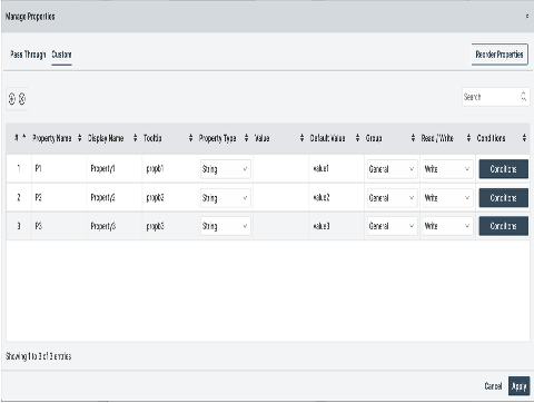

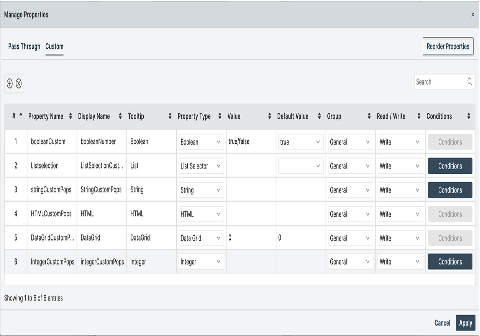

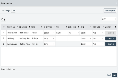

- To define custom properties, select the Custom tab on the Manage Properties dialog box.
Click the plus sign (+) for each custom property you want to define. Click the delete symbol (X) to delete an existing property. To define a new custom property, specify the following for each property:
- Property Name — The name you want to give the property. Click in the Property Name field and enter a name. The property name can contain only alphanumeric characters, and cannot start with a number or contain spaces. The property name is used to refer to the property in code.
- Property Type — The data type of the property. Click in the Property Type field, and select a value, either boolean, List Selector, String, or HTML, Data Grid, Integer, JSON, or Color.
- Value — For a property with a List Selector data type, the key-value pairs that make up the list. If the property type value is List Selector and you click in the Value field, displays the Key Value Popup dialog box. Enter the values and click OK. For a boolean property type, the Value field is automatically set to true/false. For other property types, the value field is not applicable.
Default Value — The default property value. Click in the Default Value field, and enter a default value.
When you click the default value field for a HTML property, a new HTML editor appears. Enter the HTML code in the HTML Editor window.
When you click the default value field for a JSON property type, a new JSON editor appears. Enter the JSON code in the JSON Editor window.
When you click the default value field for a Color property type, a color palette appears. To select a particular hue, on the vertical color bar drag the two opposing arrows to the hue you want, and then change the hue’s lightness, darkness, and saturation by dragging to the desired location on the large color square. You can also assign a color by changing the RGB values, the HSB values, or pasting a hexadecimal value from another program into the # text box. To close the Color Palette window, click anywhere outside of it.
- Read/Write — Whether the property is read-only or read-write. Click in the Read/Write field, and select either Read or Write.
- Conditions: Set a property as a conditional property. You can also define dependent properties. Based on the value of the conditional property, dependent properties will be shown or hidden on the property panel.
To set a conditional property, in the Manage Properties section of the Properties panel, click the Conditions column corresponding to the property. Click Define Properties to set dependent properties. Select the Type of Property (either pass-through or custom), and provide the name of the Dependent Property, and then click Done. In the Conditions dialog box, click Set Visibility for a conditional value to set the show/hide conditions for the property on the Properties Panel.
Conditional rendering of properties has been introduced to de-clutter the Properties Panel during the designing phase. Configuring conditions does not affect the properties or the values of the properties at runtime. Users can access the properties at runtime irrespective of any conditions configured for the property. Following is a list of limitations that you must consider when you configure conditions for a custom property:
- All conditional values must be unique. You cannot set the same dependent property for different conditional properties.
- You cannot define cyclic dependencies and dependent properties for Templates, Image Identifiers, and Flex Properties.
Click Apply to add the custom property.
Unlike a pass-through property, which is based on an existing property of the component, a custom property has no built-in behavior. You must define the property's behavior programmatically. On the Templates tab, expand the component's Modules node, open the controller module, and add code defining the property's behavior to the controller code. For more information, see Define the Behavior of a Custom Property, Event, or Method in Code.

Manage Methods of a Component with a Contract
In addition to specifying pass through properties and events, you can specify which of the component's methods to expose to users. You can also define custom methods.
To manage methods of a component with a contract:
- Click the Templates tab in the Project Explorer or the Library Explorer.
- Expand the components node, if necessary, and then select the component.
- In the Properties pane, click the Action tab.
- Click Manage Methods. displays the Manage Methods dialog box.
- To define pass-through methods, select the Pass Through tab on the Manage Methods dialog box.
Click the plus sign (+) for each pass-through method you want to define. Click the delete symbol (X) to delete an existing method. To define a new pass-through method, specify the following for each method:
- Source Widget — The widget that contains the method. Click in the Source Widget field to display a hierarchical list of the component's widgets, and then select the widget.
- Method — The method that you want to define as a pass-through method. Click in the Method field to display a list of the source widget's methods, and then select the method.
- Programmatic Name — The name to identify the method in code. Click in the Programmatic Name field and enter a name. The programmatic name can contain only alphanumeric characters, and cannot start with a number or contain spaces.
- Group — The group to which the event belongs. Use groups to display related events in their own section on the Action tab of the Properties pane.
Click Apply to add the pass-through method.
- To define custom properties, select the Custom tab on the Manage Methods dialog box.
Click the plus sign (+) for each custom method you want to define. Click the delete symbol (X) to delete an existing method. To define a new custom method, specify the following for each method:
- Method — The name you want to give the method. Click in the Method field and enter a name. The method name can contain only alphanumeric characters, and cannot start with a number or contain spaces.
To add parameters to the custom method, click the Manage Methods button, and specify the parameter information in the dialog box.
Click Apply to add the custom method.
Unlike a pass-through method, which is based on an existing method of the component, a custom method has no built-in behavior. You must define the method's behavior programmatically. On the Templates tab, expand the component's Modules node, open the controller module, and add code defining the method's behavior to the controller code. For more information, see Define the Behavior of a Custom Property, Event, or Method in Code.

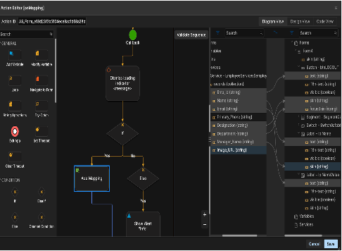

Set Data for Components with Contract by using Mapping Editor
To set data for a component with contract by using Mapping Editor, follow these steps:
In Iris, create a component with contract, add the required widgets, define the pass through and custom properties of the component, and then click Apply.
2. In Project Explorer, select the form into which you want to insert the component with contract.
3. Go back to Templates > Components, and right-click the newly created component. A list of options appears.
4. Click Insert Into. The component with contract is inserted into the selected form.

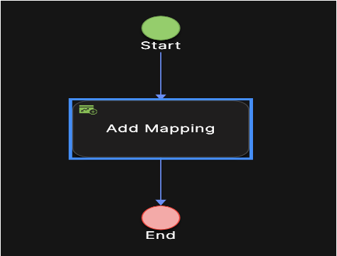

5. Select the form, and then go to Properties panel > Action.
6. For any Event (for example, onMapping), click Edit. The Action Editor window appears, with Diagram View open by default.
7. On the left pane of Action Editor, locate and click the Add Mapping action. The Add Mapping action is added to the flow diagram, as shown here.
Select Add Mapping from the flow diagram. Mapping Editor opens on the right pane of Action Editor.
You can use Mapping Editor to expand and create mappings among various form, component, and widget elements as well as global variables.
10. Click Code View to see the generated sample code details of the data mappings.
- Click Save. You have successfully set data for the component with contract by using Mapping Editor.

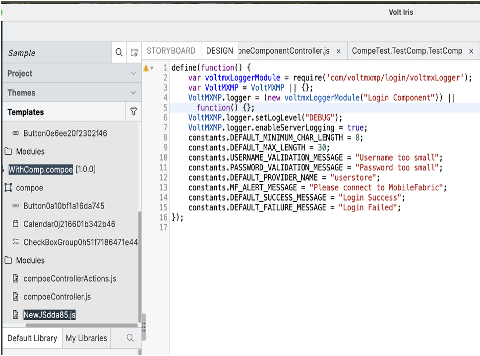

Define the Behavior of a Custom Property in Code
When you create a component with a contract, you can define pass-through and custom properties, events, and methods for the component. Defining pass-through properties, events, and methods does not require that you write code. You simply specify the built-in properties, events, and methods that you want to expose. However, a custom property, event, or method does not have any built-in behavior. You must define its behavior in code. First, specify a name for the custom property, event, or method using the Manage Properties dialog box. For a custom property, you can also specify a display name, data type, and default value, and whether the property is read-only or read-write. If the property has a list selector, you can specify the key value pairs that make up the list. For more information on working with the Manage Properties dialog box, see Manage Properties of a Component with a Contract, Manage Events of a Component with a Contract, or Manage Methods of a Component with a Contract.
Once you specify information in the Manage Properties dialog box, you can add code to the component's controller module to define the behavior of the custom property, event, or method.
To define the behavior of a custom property, event, or method in code (Beta):
- Specify the required information in the Manage Properties dialog box.
- On the Templates tab, expand the Modules node of the component that contains the property, event, or method.
- Open the component's controller module; for example, loginController.js.
- Add JavaScript code that defines the behavior of the property, event, or method.
For example, the following code defines custom properties for the Login component, which can be downloaded from . For examples of custom events and methods, see the loginController.js controller module example.
* @function initGettersSetters
* @description contains getters/setters for the usernameMinimumChar and usernameValidationMsg custom properties
initGettersSetters: function() {
defineGetter(this, "usernameMinimumChar", function() {
voltmxmp.logger.trace("----------Entering usernameMinimumCharacter Getter---------", voltmxmp.logger.FUNCTION\_ENTRY);
return this.\_usernameMinimumChar;
defineSetter(this, "usernameMinimumChar", function(val) {
voltmxmp.logger.trace("----------Entering usernameMinimumCharacter Setter---------", voltmxmp.logger.FUNCTION\_ENTRY);
try {
if (val == null || val == undefined) {
voltmxmp.logger.warn("Username Min Char is undefined");
throw {
"Error": "LoginComponent",
"message": "Username Min Char is undefined"
if (isNaN(val)) {
voltmxmp.logger.warn("Invalid datatype for Username Min Characters Property");
throw {
"message": "Invalid datatype for Username Min Characters Property"
if (this.usernameMaxChar & amp; lt; val) {
voltmxmp.logger.warn("usernameMaxChar is less than usernameMinimumChar");
throw {
"message": "username Max Char is less than Username Min Character propert"
this.\_usernameMinimumChar = val;
} catch (exception) {
if (exception\["Error"\] === "LoginComponent")
alert(JSON.stringify(exception));
defineGetter(this, "usernameValidationMsg", function() {
voltmxmp.logger.trace("----------Entering usernameValidationMsg Getter---------", voltmxmp.logger.FUNCTION\_ENTRY);
return this.\_usernameValidationMsg;
defineSetter(this, "usernameValidationMsg", function(val) {
voltmxmp.logger.trace("----------Entering usernameValidationMsg Setter---------", voltmxmp.logger.FUNCTION\_ENTRY);
this.\_usernameValidationMsg = val;

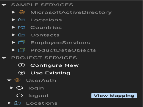

Data & Services Panel Support for Components
From V8 SP4 Fixpack 20, you can directly drag and drop services from the Data & Services panel to a component. In addition, you can drag and drop individual parameters of a sample service to a component. This enhancement will enable you to quickly customize components according to your requirement, and reuse them at various places in your and projects. Furthermore, you can publish customized components to Forge . You can leverage Data Panel support for both components with contract and components without contract. For more information on the Data & Services panel, click here.
Once you drag and drop a sample service from the Data & Services panel to a component, a corresponding project service is added. That particular project service and its associated parameters are auto-highlighted in the Data & Services panel. So if multiple components exist and when you select a specific component, only those services which have been added to that component are highlighted in the Project Services of the Data & Services panel. The Data & Services panel also allows you to view the mappings for each project service operation in the component. The onMapping Event of the operations in the component is not generated separately in the CodeGen. You can view the onMapping Event in the preShow Event of the component
Currently, only the Details form and List form UI are supported for the drag and drop of services into a component; Entry form UI is not supported.

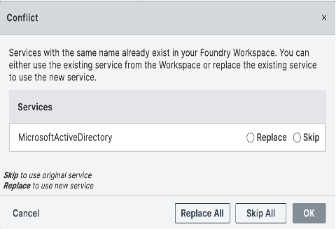

If the sample service that you are trying to add to a component has already been added to another component, a Conflict window appears. In such a scenario, you must perform any one of the following actions to resolve this issue:
- Select the Skip radio button, and then click OK to use the original service.
- If multiple instances of the same service exist and you want to use the original service, click Skip All.
Select the Replace radio button, and then click OK to use a new service.
- If multiple instances of the same service exist and you want to use a new service, click Replace All.

How to Create a Component with Services
Create a component and leverage sample services from the Data & Services panel. You can bundle these services to the required widgets of a component. You can directly drag and drop services into a component and customize it according to your requirement.
In this scenario, we will use the List-Details (Employee) component and add services to the widgets of the component. You can add parameters (for example, Name) to specific widgets (for example, empname Label) of the component. This component contains the following two screens:
- Employee List
- Employee Details
To import the List-Details (Employee) component and add services to the component, follow these steps:
In , create a new Sample App project , and then import the List-Details (Employee) component.
The landing page of the List-Details (Employee) component is displayed on the Project Canvas and its associated widgets are displayed in the Project Explorer. -

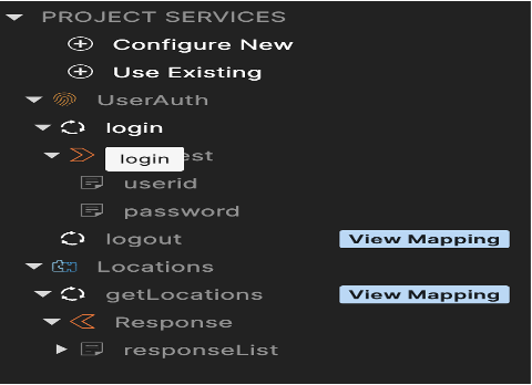

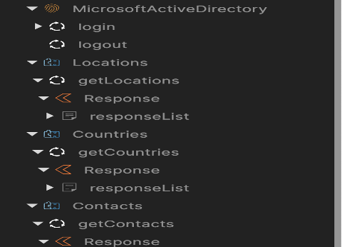

To add services to the Employee List screen, follow these steps:
- In the Project Explorer, go to Mobile > Forms, and then click frmList. The list screen is displayed on the Project Canvas.
- Go to Data & Services panel > Sample Services, and then expand Employee Services.
Under the employees > get > Response > records operation, drag and drop the following parameters to the respective widgets:
- Name > empname
- Designation > designation
- Department > department
To add services to the Employee Details screen, follow these steps:
- In the Project Explorer, go to Mobile > Forms, and then click frmDetails. The details screen is displayed on the Project Canvas.
- Designation > lblEmployeeDesignation
- Primary_Phone > callMobileFlex
- Email > emailFlex
- Department > departmentFlex
- Manager_Name > reportingToFlex
Go to Data & Services panel > Sample Services, and then expand Contacts.
Under the getContacts > Response > responseList operation, drag and drop the following parameters to the respective widgets:
- Name > lblEmployeeName

For the List and Details screen, add response parameters of the required Object service (that fetches customer data) to the corresponding widgets of the component. Response parameters of other services (such as Contacts) can also be used wherever necessary. The new parameters are mapped to the corresponding component widgets, and the services are created in . Furthermore, the mappings are highlighted and displayed under Project Services on the Data & Services panel.
Click View Mapping for the service, and then click Generate Code to view all the mappings of the parameters in the component.
Alternatively, you can go to Properties panel > Component, click Edit for the onMapping Event, and then click Generate Code. - This component can now be used in the CRM app to display the list of customers on the Customer List screen and specific customers' information on the Customer Details screen.

You can drag and drop individual Sample service parameters to the widgets in the component of a form. This feature helps you to organize forms containing distinct components and services in multiple Collections within the Library Explorer. Furthermore, you can import forms containing components from a Collection in the Library Explorer and use these forms in your project. By using these forms in your project, you can accomplish specific purposes within your application.
For instance, consider a scenario where a simple Employee Details screen needs to be created for an Employee Directory app. You can create a Employee Details form and add a component containing the Employee ID and Employee Name fields with associated Label widgets. You can then leverage the Name parameter of the getContacts operation in the Contacts Integration service and the Emp_id parameter of the get operation in the EmployeeServices Object service. You can drag and drop the Name and Emp_id parameters onto the respective Label widgets of the Employee ID and Employee Name fields.
The parameters will call the unique Name and Employee ID details of a particular employee in the Employee Directory app. In addition, whenever a similar kind of functionality needs to be designed for another app, this customized form can be leveraged and reused.
To add Sample service parameters to the widgets in the component of a form, follow these steps:
- Add a component to a form.
- Go to Data & Services panel > Sample Services, and then expand the required service.
- Drag and drop a specific parameter of the service to a particular widget of the component. The parameter is added to the specific widget of the component, and that parameter is auto-highlighted in the Data & Services panel.
You can drag and drop multiple service parameters to the widgets of a component within a form.
- Click View Mapping for the service, and then click Generate Code to view all the mappings of the operations in the component.
Alternatively, you can go to Properties panel > Component, click Edit for the onMapping Event, and then click Generate Code. - Once you have successfully added the service operation parameters to the component in the form, the form can be added to a Collection and then imported to be used for a particular channel in your project.
