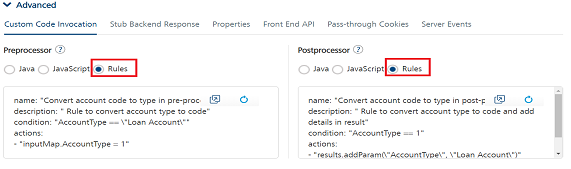

    1. When you are configuring an operation, in the Advanced > Custom Code Invocation for pre-processor or post-processor, click the Rules option.
