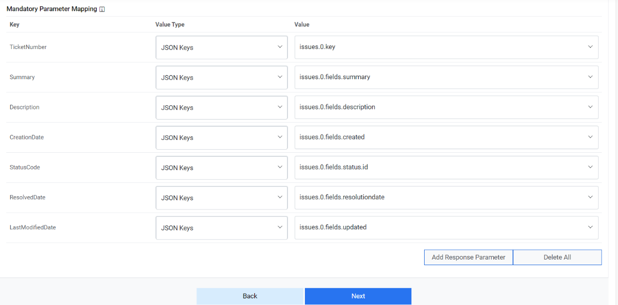

  4. Mandatory Parameter Mapping:
    Figure 2. Mandatory Parameter Mapping

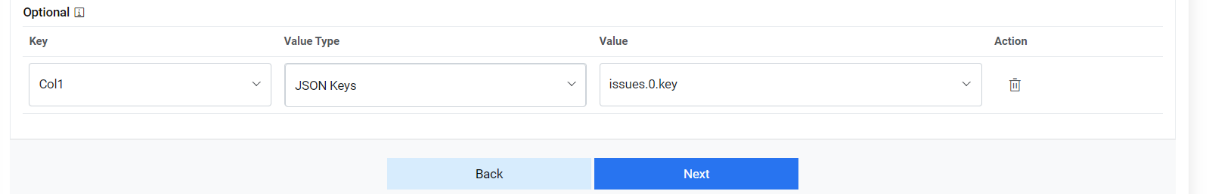

  5. Optional:
    Figure 3. Optional

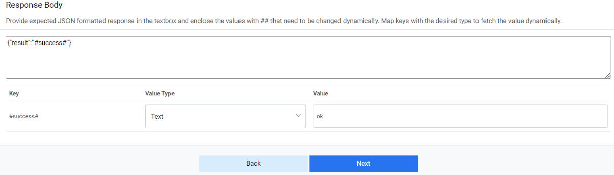

  8. Response Body:
    {"result":"#success#"}
    Figure 4. Response Body
    A screenshot of a computer Description automatically generated
