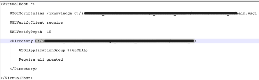

  1. Check for existence of the file iknowledgeCrawler.conf at location <Apache_Root_Folder_Path>/conf.
  2. At the bottom of iknowledgeCrawler.conf file you will find the path to the python files as highlighted in the below figure.

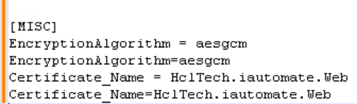

  3. Open the file icrawler.cfg from the location <highlighted_path_in_fig_128>/config and search for any duplicate keys present in the file. You can refer below keys for reference:
    Figure 2. HCL.iAutomate.iCrawler (cont.)
  4. Remove the entry that is duplicate for each key. In the above case delete, the
  5. EncryptionAlgorithm = aesgcm and Certificate_Name = Hcltech.iautomate.Web, similarly, check for any other duplicate keys and remove the last entry and save the file.

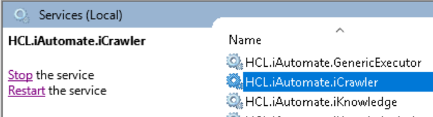

  6. Finally restart the service named HCL.iAutomate.iCrawler
