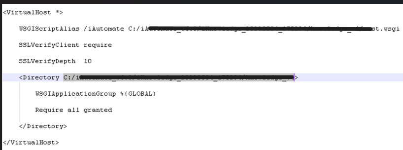

  1. Check for existence of the file iKnowledge.conf at location <Apache_Root_Folder_Path>/Conf
  2. At the bottom of iknowledge. conf file, you will find the path to the python files as highlighted in the below figure.

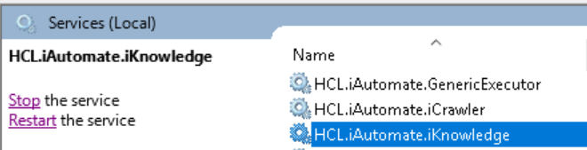

  6. Finally restart the service named HCL.iAutomate.iknowledge in services.msc
    Figure 3. HCL.iAutomate.iKnowledge(cont.)
