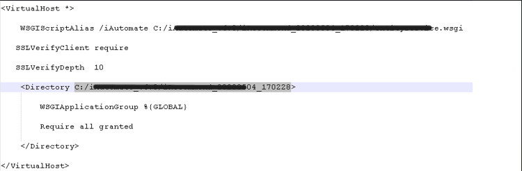

  1. Check for existence of the file Entity.conf at location <Apache_Root_Folder_Path>/conf.
  2. At the bottom of Entity.conf file you will find the path to the python files as highlighted in the below figure.

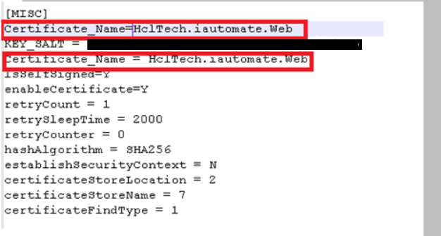

  3. Open the file entity.cfg from the location <highlighted_path_in_fig_112>/config and search for any duplicate keys present in the file. You can refer to the keys below for reference:
    Figure 2. EntityModel (cont.)
  4. Remove the last entry that is duplicate for each key. In the above case delete the second entry of Certificate_Name = HclTech.iautomate.Web Similarly check for any other duplicate keys and remove the last entry and save the file.
