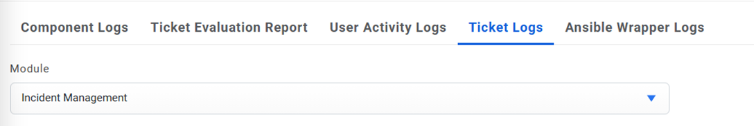

  3. Select Module.
    Figure 2. Organization and Module

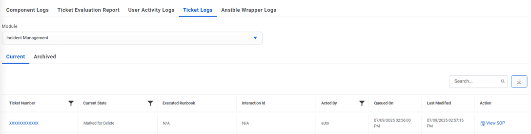

  4. This lists the ticket log for logged in organization and module-specific tickets in the following tabs.

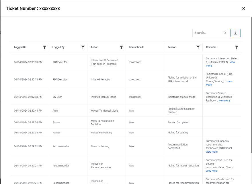

    • Current: Lists of the log details of the tickets available for execution in the selected organization, including the ticket number, current state, executed runbook, interaction id, acted by, queued on, and last modified information.
    • Selecting a Ticket Number displays detailed log information including logged on and logged by details, action was taken on the ticket, the reason for the action taken, and remarks.
      Figure 3. Ticket Logs
    • Archived: Lists the log details of the ticket that are marked as closed in the selected organization, including the ticket number, current state, executed runbook, acted by, queued on, and last modified information. Selecting a Ticket Number displays the detailed log information including logged on and logged by details, action that was taken on the ticket, the reason for the action taken, and remarks.
  5. Users can export the log details using the button above the Log Detail's view.
