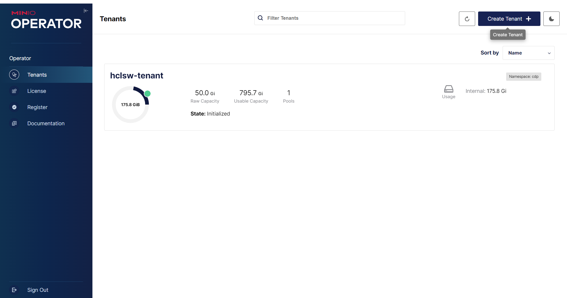

  2. Create and configure the Tenant.

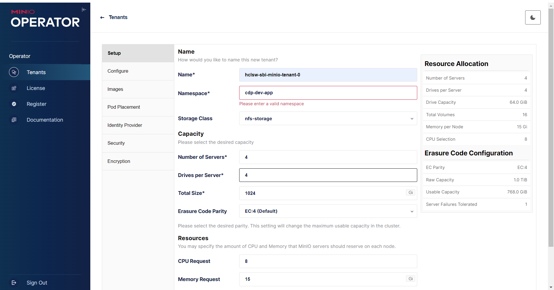

    1. In the MinIO portal, select Tenant, and click Create Tenant.
    2. In the Tenants page, click Setup, and enter tenant name and other details.

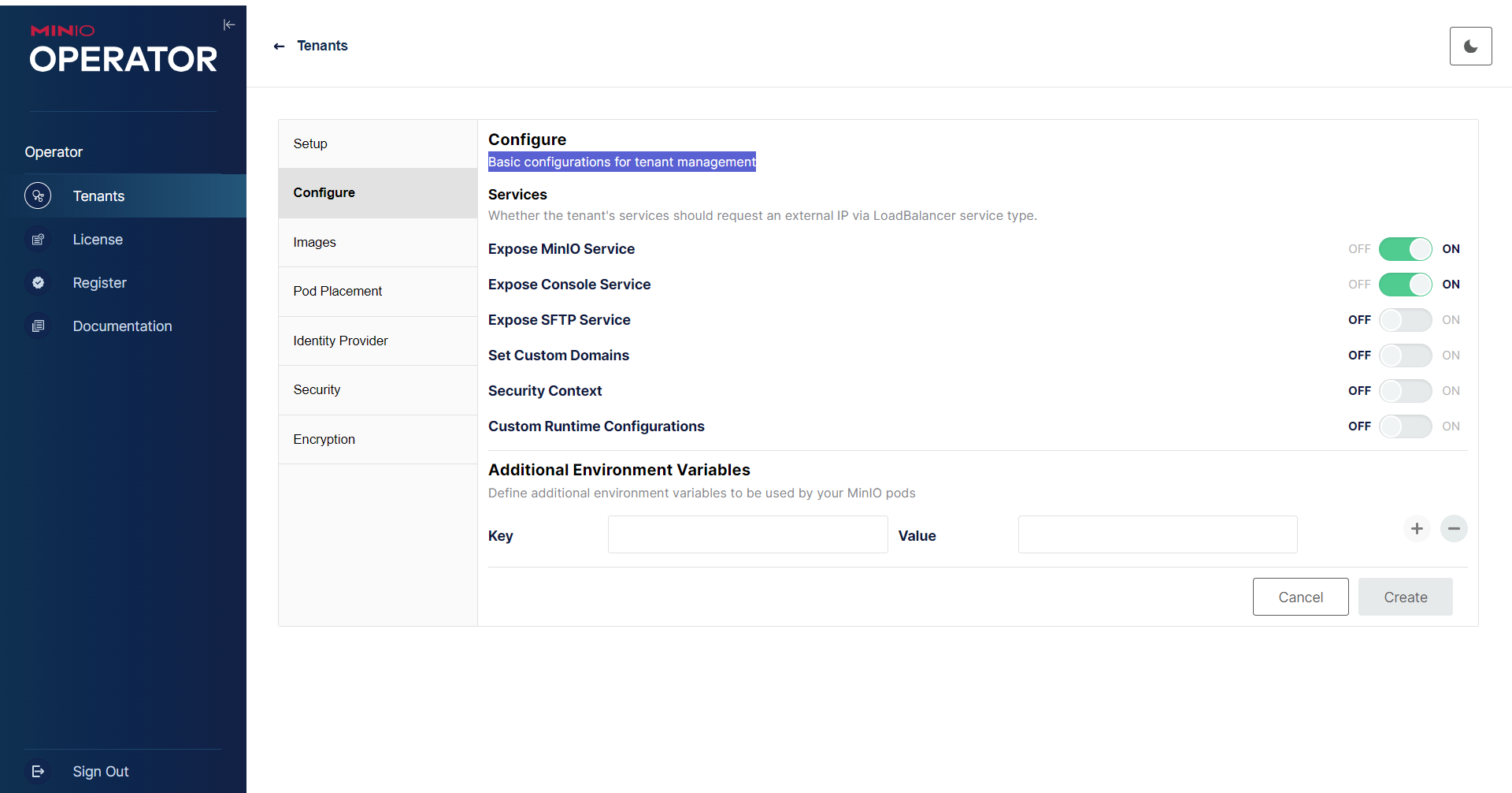

    3. Now, click Configure, and set the basic configurations.

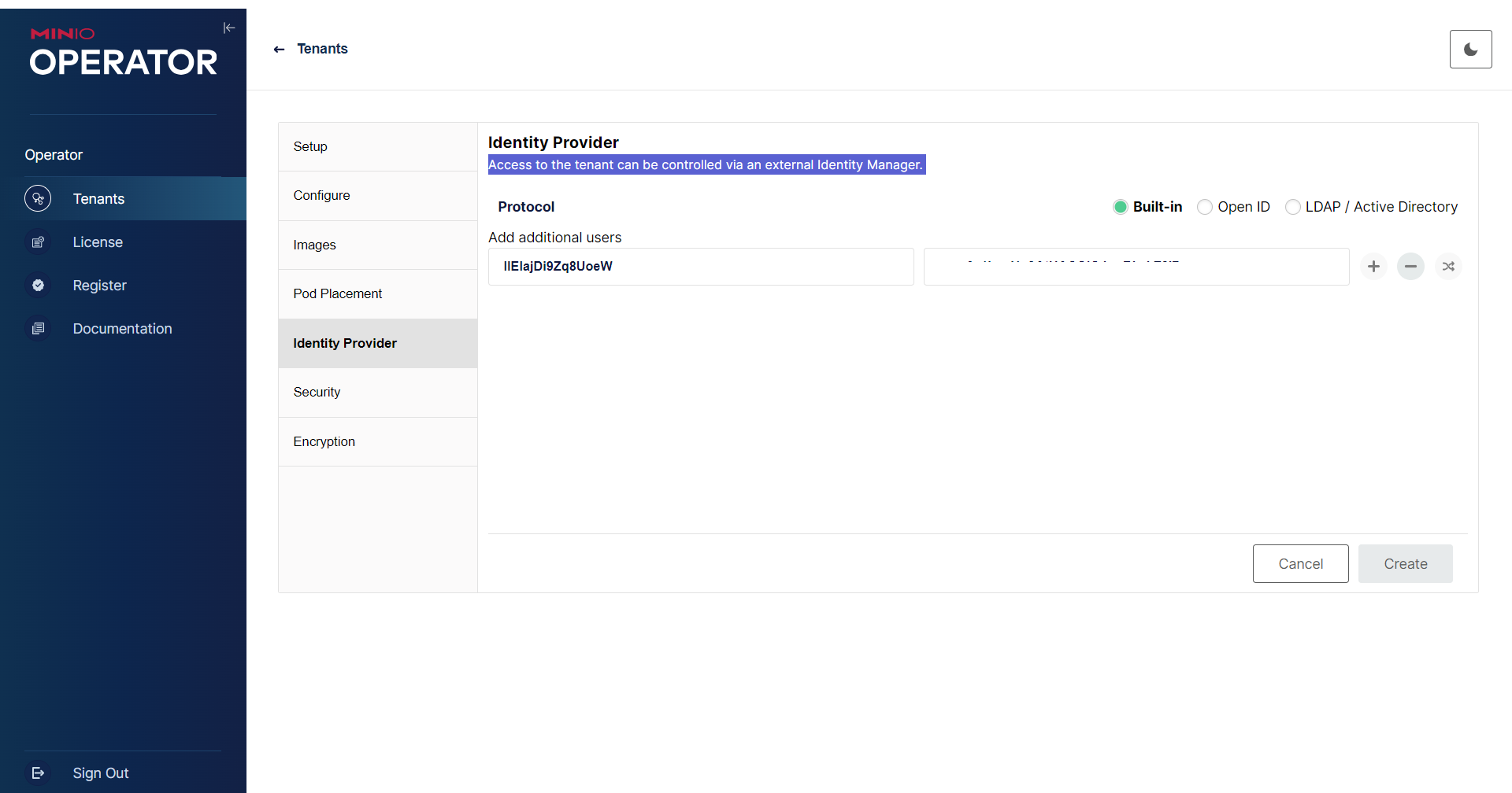

    4. Similarly, configure Identity Provider, Security and Encryption.
    5. Store the MinIO credentials.json for Tenant Management, and verify the Tenant resources created under specified namespace - cdp.

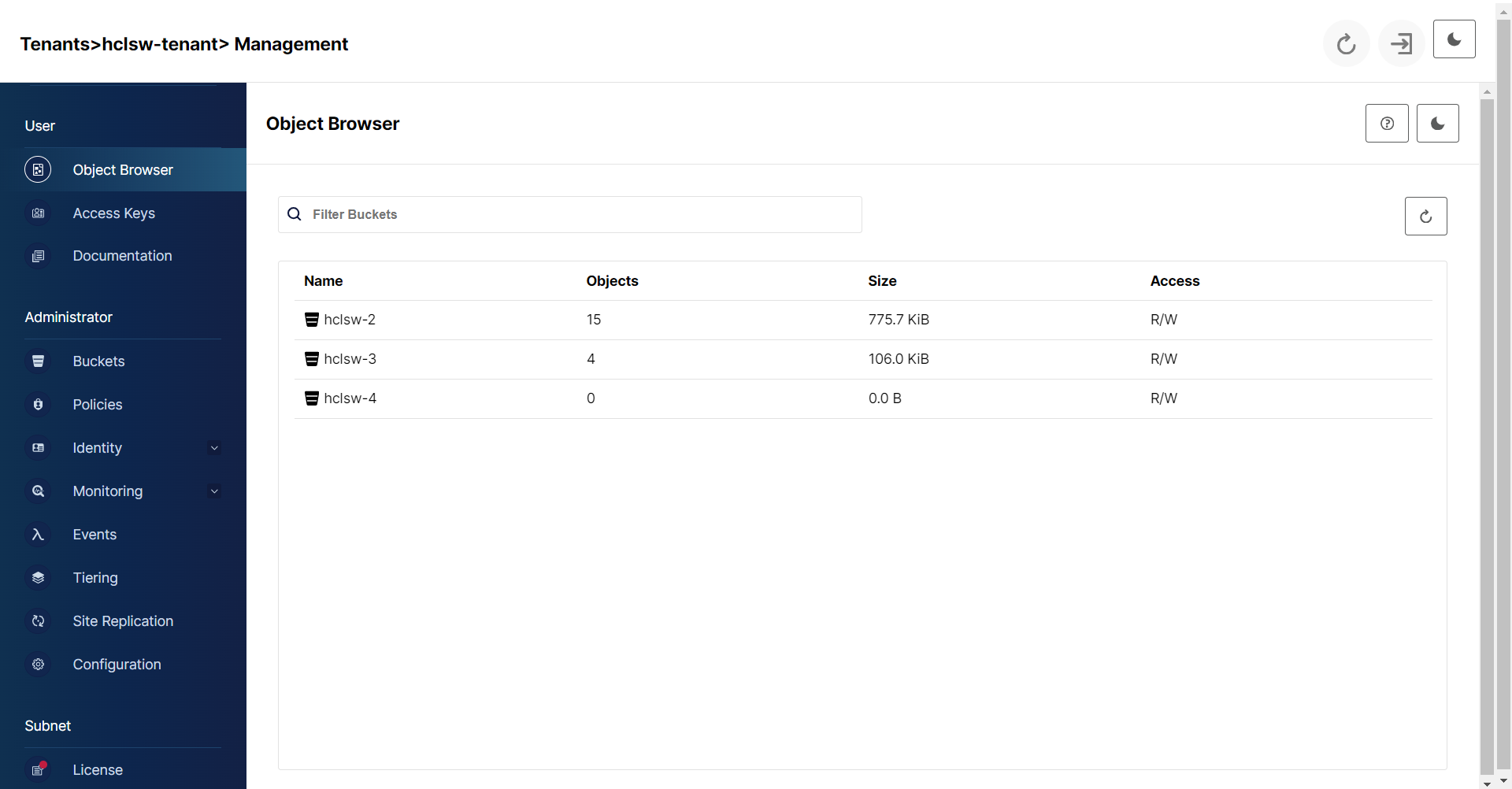

  3. Create a bucket in the Management Console.

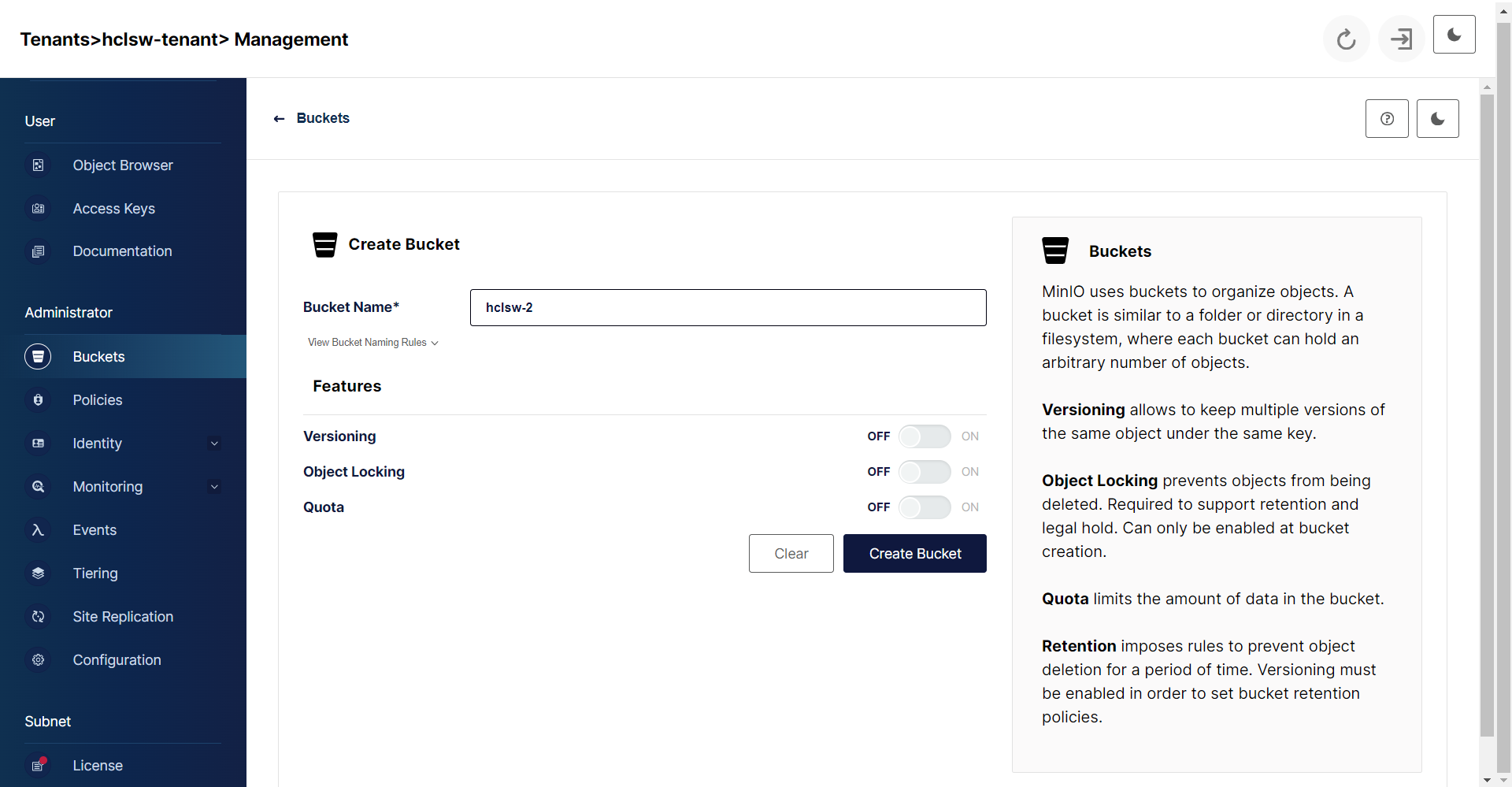

    1. Open the Management console using console URL.

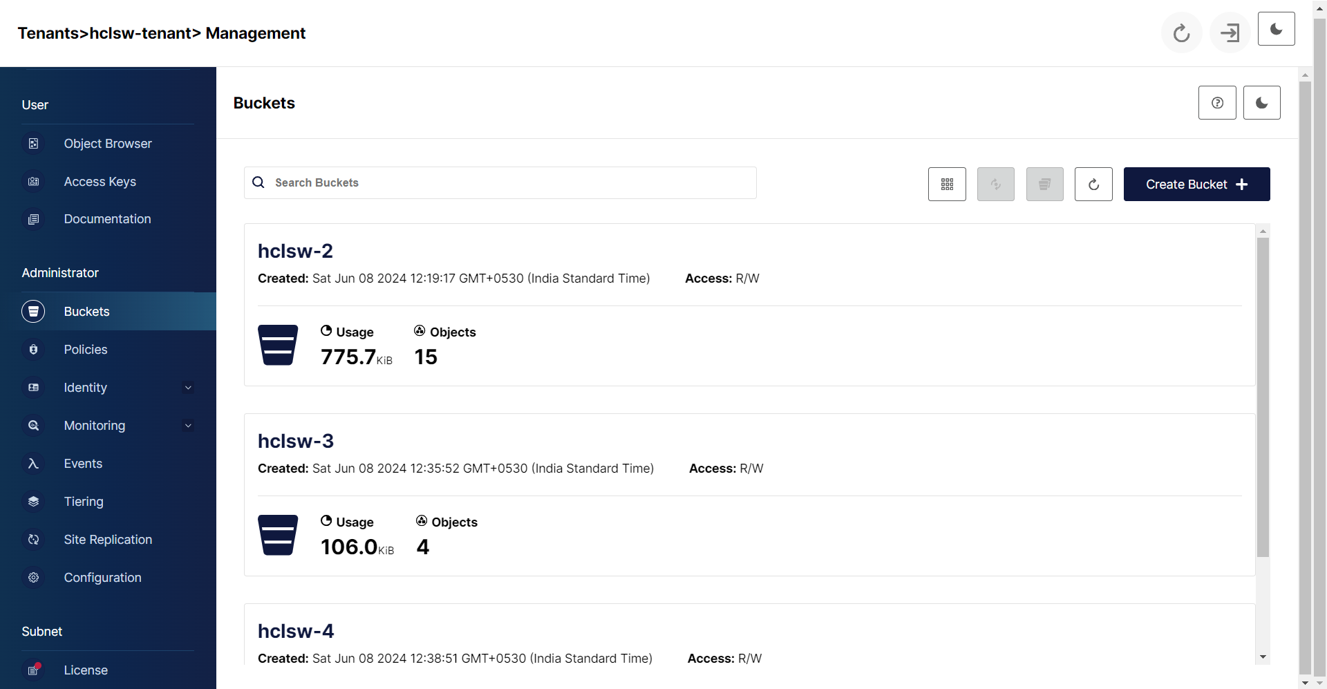

    2. In the console, Under Administrator section, click Buckets and enter bucket details. Click Create Bucket to create the new bucket.
    3. You search for the existing buckets in the search bucket option as shown below.
