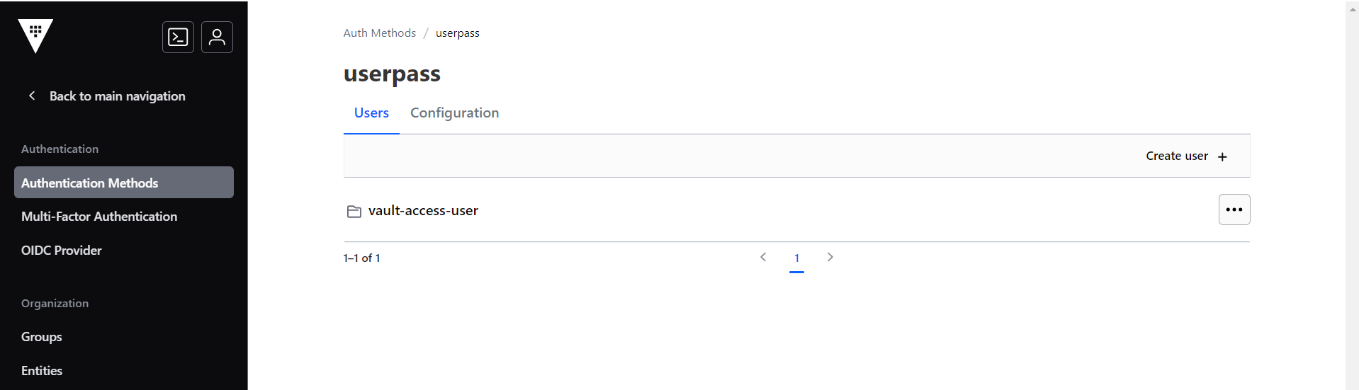

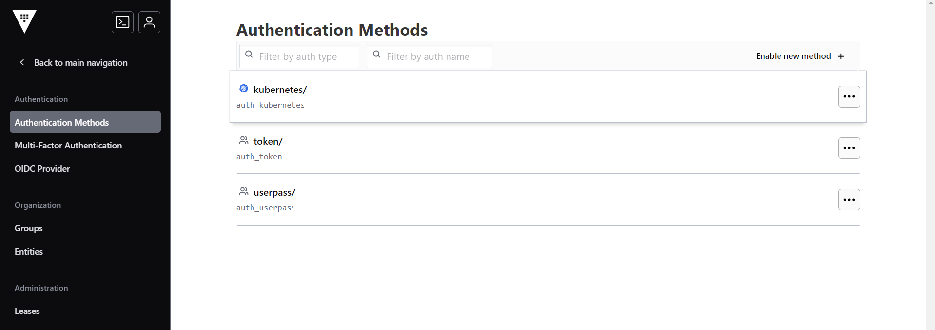

  4. Create a user for Vault access.

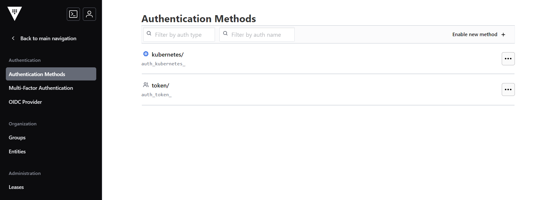

    1. Using the port URL and credentials, login to the Vault UI. Navigate to Access > Authentication Method > Authentication Method.
    2. In the Authentication Method section, click the Enable new method as shown below.

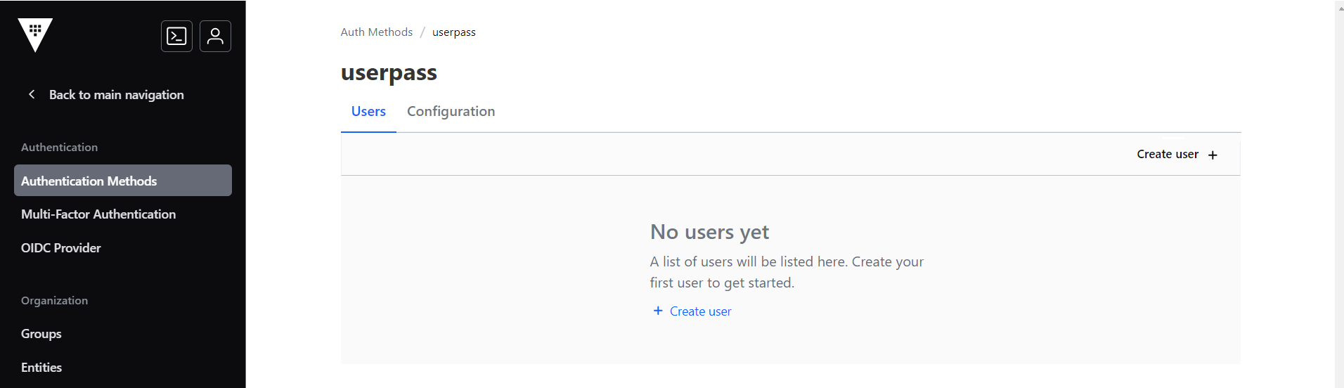

    3. Click the Username & Password icon, and click Create user.

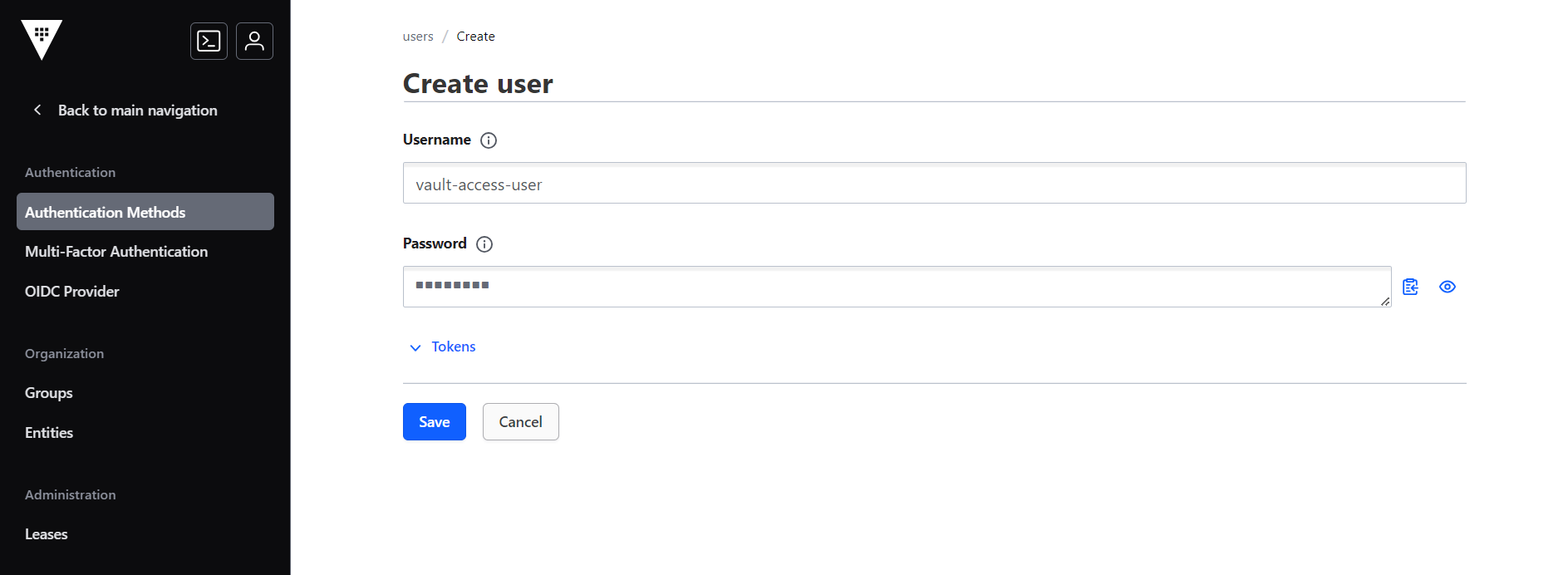

    4. In the Create user section, enter the username and password.
      Make sure to use base 64 bit encoded password.
    5. The new user will be created listed in the userpass section. The new user can access the vault to retrieve the secrets.

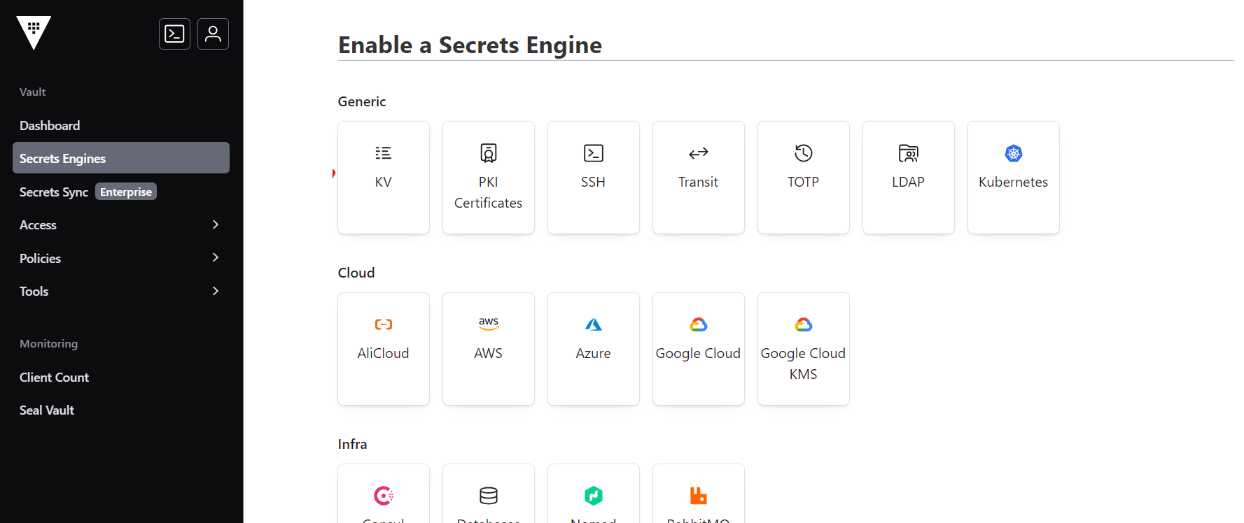

  5. Create a Secrets Engine to store secrets in Vault.

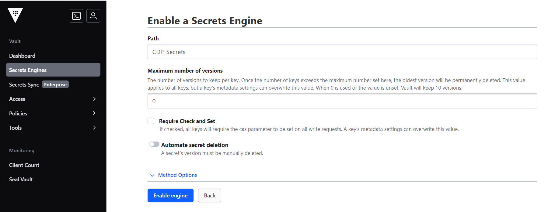

    1. In the Vault UI, navigate to Secrets Engines > Enable new engine, and click KV icon.
    2. Enter the name of the KV secret folder, inside which you can create the secrets, and click Enable engine to create the KV folder.

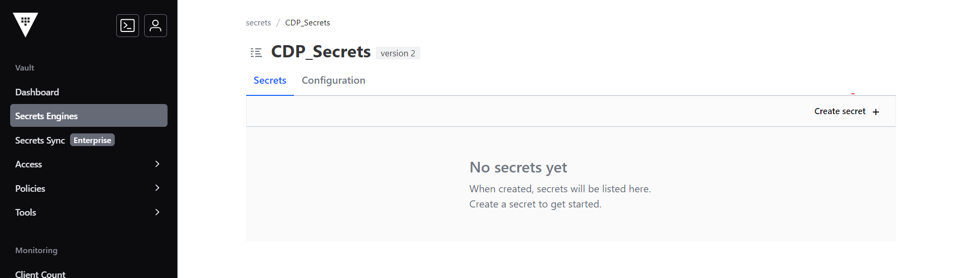

    3. In the KV Folder section, click Create secret option to create new secrets.

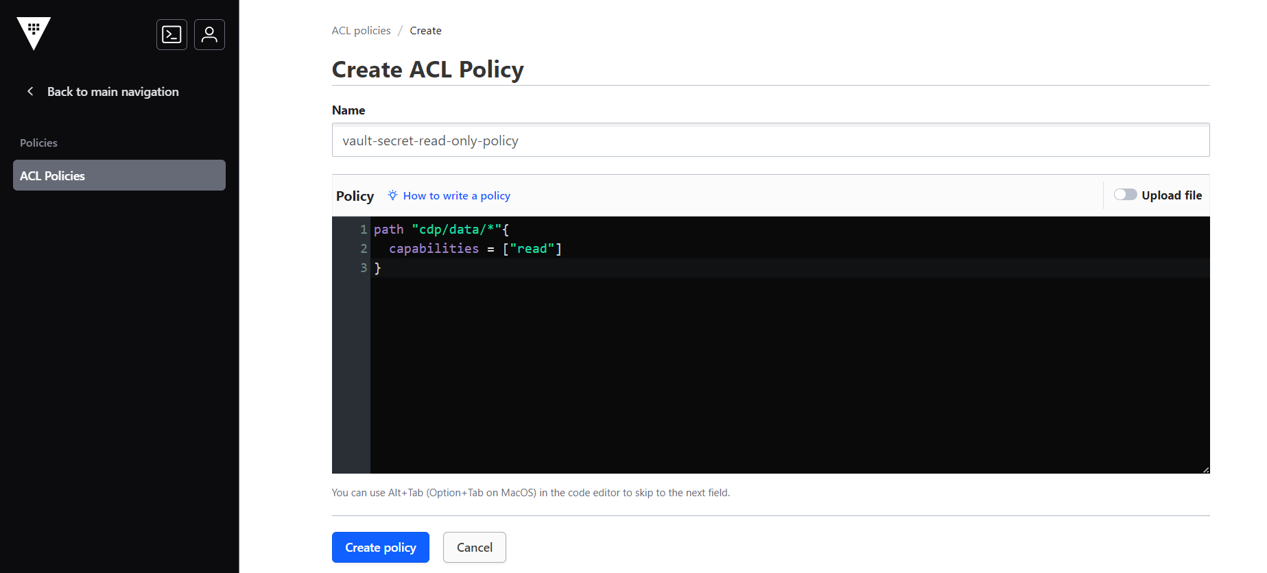

  6. Create a User Policy. After creating secret folder, you can create policy to access the secrets from Vault.

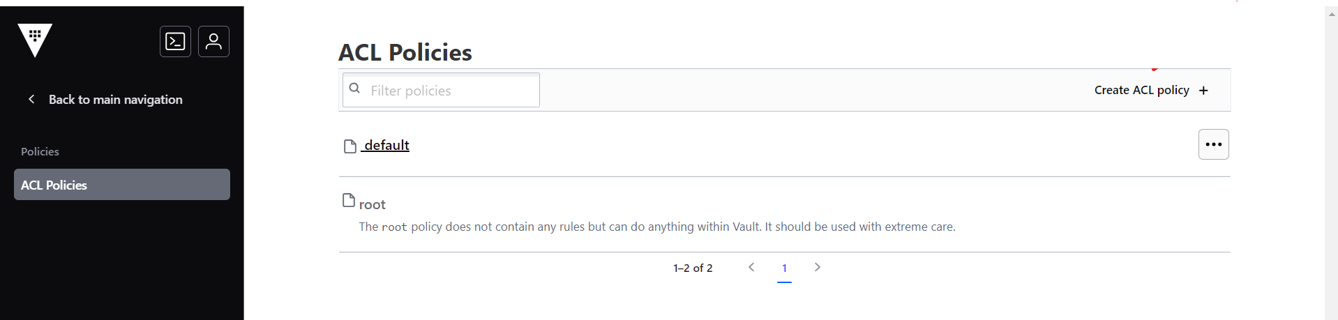

    1. In the Vault UI, click Policies.
    2. In the ACL Policies section, click Create ACL policy.
    3. As a result, the Create ACL Policy section will be displayed. In the Create ACL Policy section, enter policy name and policy as shown below.
      path "CDP_Secrets/data/*"{
      capabilities = ["read"]
    4. Click Create policy to create the policy.
