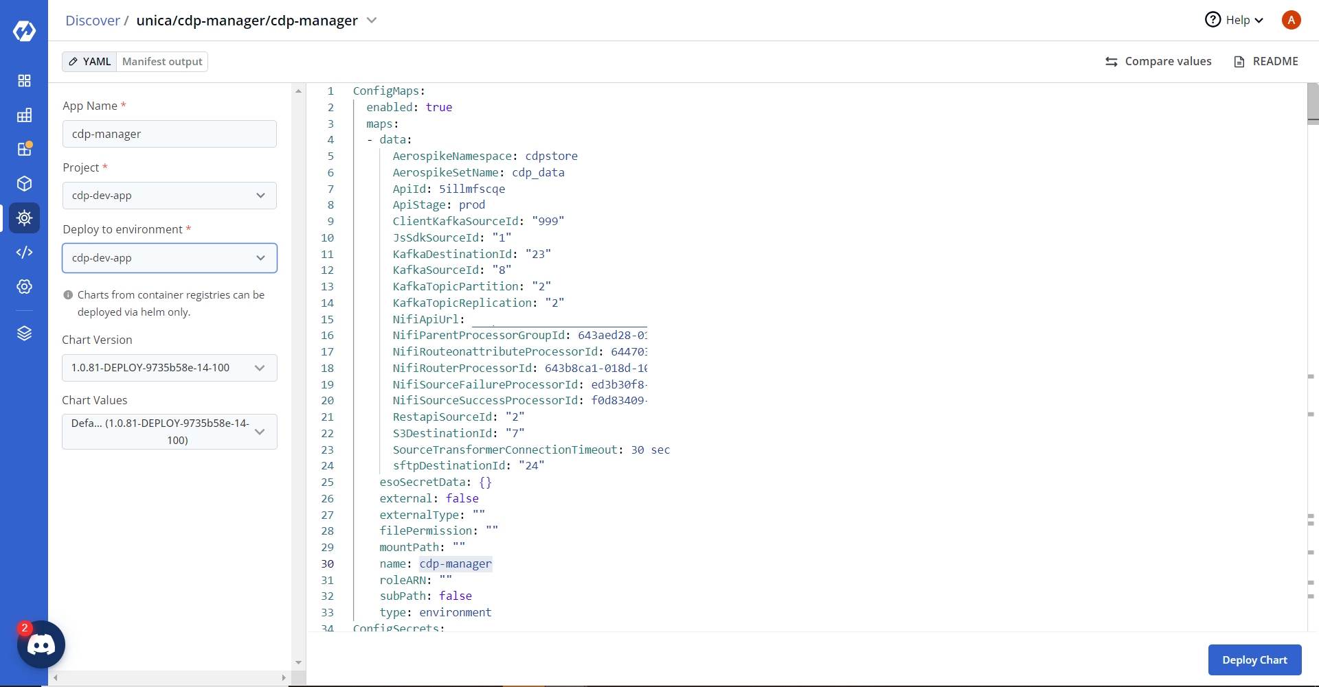

  1. Navigate to the Devtron Chart Store, and select the cdp-manager chart to deploy.
  2. Now, configure and deploy the CDP Manager charts.
  3. In the YAML section, update the ConfigMap using below details and deploy the charts.
    NifiApiUrl: ""
    NifiProtocol: https
    NifiParentProcessorGroupId: <NifiParentProcessorGroupId>
    NifiRouteonattributeProcessorId: <NifiRouteonattributeProcessorId>
    NifiRouterProcessorId: <NifiRouterProcessorId>
    NifiSourceSuccessProcessorId: <NifiSourceFailureProcessorId>
    NifiSourceFailureProcessorId: <NifiSourceSuccessProcessorId>
    KafkaDestinationId: "23"
    sftpDestinationId: "24"
    hclunifiedprofileDestinationId: "3"
    S3DestinationId: "7"
    KafkaSourceId: "8"
    JsSdkSourceId: "1"
    ClientKafkaSourceId: "999"
    RestapiSourceId: "2"
    SourceTransformerConnectionTimeout: 30 sec
    KafkaTopicPartition: "2"
    KafkaTopicReplication: "2"
    AerospikeNamespace: cdpstore
    AerospikeSetName: cdp_data
    ApiId: <APIID>
    ApiStage: <Environment>
    ApiEnabled: "false"
    LOG_LEVEL_ROOT: info
    LOG_LEVEL_APP: info

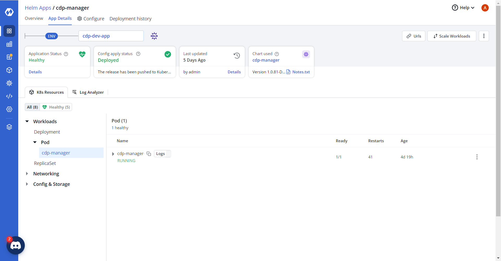

  4. On successful deployment, validate the deployment as shown below.
