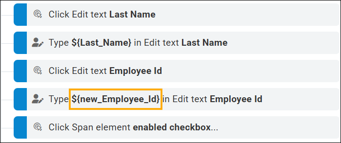

In the recorded test, the Employee Id value was manually entered as 012345. In this task, you will create a test variable to store a new Employee Id 23456 and modify the recorded test step to use this variable instead of the manually entered value. This method helps make the test more flexible and reusable by separating test data from test logic.

  7. Perform the following actions to replace the Employee Id value in the recorded steps:
    1. Locate the recorded step that enters the Employee Id value (currently 012345).
      The step opens in the Details tab.
    2. In the Value field, replace the manually entered Employee Id with the variable. For example, ${new_EmployeeId}.
    3. Close the Details tab.
      The Employee Id step is modified to use a ${new_EmployeeId} value, as shown in the image.
      Recorded_test_steps
  8. Click Save to save the modified step.
You have now added the variable to the recorded step.
