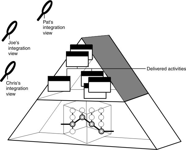

The integration stream
Projects always include a single integration stream, which is the project's main shared work area. In a multiple-stream project, many integration views can be attached to the project integration stream.
The project integration stream records the project baselines and you can use it to access to all versions of the project shared elements. It collects all the work that all team members deliver from their development streams.
In a single-stream project, there are no development streams, so many development views are attached to the integration stream. When you check in versions from your view, you modify the configuration of the integration stream. The latest versions in the stream are available to all project members.
