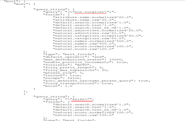

The Query service can generate an Elastic query with the hyphen as shown below. There is a separate definition block for hyphenated keyword and those keywords will be searched against all the natural fields and query fields from the search profile.
