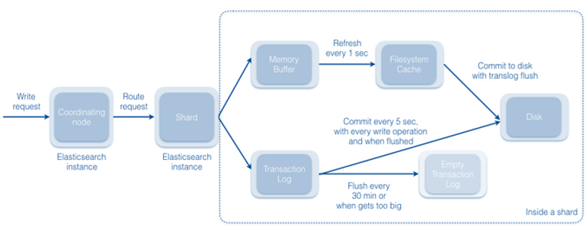

Elastic uses the same zero-master clusering approach as NiFi. The coordinating node receives write requests and allocates routing requests to other cluster instances (shards). By default each shard refreshes its filesystem cache once per second and commits every five seconds. The shard keeps a transaction log and flushes the log every thirty minutes.

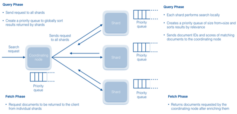

In the query phase of the search process, the coordinating node takes incoming searches and sends them to all the shards. Each shard performs its own search, locally. The shard prioritizes the results and returns information about the top fifty documents to the coordinating node. In the fetch phase the coordinating node determines the top ten documents from each shard's list, and requests that each shard send it those documents.
The query phase will usually take significantly longer than the fetch phase, because during Query the shards have to match the search to a potentially long list of documents, and determine a score for each. In contrast, the fetch can complete quickly because the coordinating server requests a subset of the documents using direct addresses.
