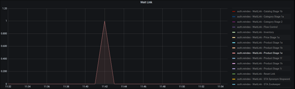

In the NiFi ingest connectors, WaitLink process groups are added between process groups to ensure that the previous stage is completed before the next stage is started. This way, subsequent stages will not use data that is currently being worked on in an unfinished process. In addition, this reduces the occurrence of different processes running at the same time, which can cause extreme spikes in resource requests for CPU, network, memory or disk IO.
The time that is spent on WaitLink can be used to estimate the full time that is used for a stage, and identify stages with the highest time and/or resource usage within the build. Since not all of the process groups have WaitLink, the Queued Items graph provides more details for the time taken for processing within each process group.

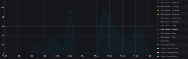

The useful charts to look at within Queued Items are the Bulk Service - <XXXX> charts. These process groups send the processed data (index documents) to Elastic from NiFi. The most important one is Bulk Service – Product. Since the curve starts from the beginning to the end of the ingest pipeline, we can use the timestamp in Wait Link to get the related stages.
For example, the following two graphs show that the biggest number of queued items is at the Product Stage 1e. This observation means the retrieving data group and processing data group can handle the task quickly, and send lots of data to the Bulk service group for transferring.
In this example, the duration with 100 queued items is short and therefore is not a problem. If a process group takes a longer time, with a larger number of queued items, it would be a possible bottleneck in the pipeline.
