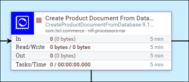

Each group has an influence on the index building process's speed and efficiency. The retrieving data group, for example, would be in control of the flow file size (bucket size) and query execution frequency (scroll page size). You can optimise the payload and retrieval cost from the database, as the chunk of data NiFi processes as a unit, by altering these variables. The size of the flow file affects Elastic upload performance. Complicated and large structures can take longer time for Elastic to parse, resulting in poor scalability.
The processing data group controls the amount of work NiFi can do. For example, you can regulate how many flow files may be processed concurrently by controlling the processor's thread count. This increases the processing speed of a typical processor, potentially improving flow file pileup in front of the processor. The NLP processor, for example, is a typical processor that benefits significantly from additional threads. You can control how many connections to Elastic you make concurrently using the more specialised bulk update type processor, allowing you to import more data to Elastic.

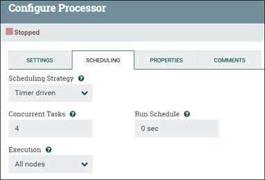

Processor thread count (Concurrent Tasks)
The default processor runs a single thread at a time, processing one flow file at a time. If concurrent processing is desired, the number of concurrent tasks that it can do can be adjusted. Set the number of threads for the process group by changing the processor Concurrent Tasks value (under Processor configuration or SCHEDULING tab).
Throughput can be improved if a CPU is able to multitask by increasing the number of threads it employs. The transformation processor (as in NLP) and the Bulk update processor are two such examples (sends data to Elastic). This update does not help every processor. Most processors come with an default configuration that takes this variable into account and does not need to be altered. When performance testing reveals a bottleneck in front of the processors, the default configuration may benefit from further tuning.
When the processor can process flow files at the same rate as they come, the Concurrent Tasks value is ideal, preventing large pileups of flow files in the processor's wait queue. Because such a balance may not always be feasible, the best setup focuses on reducing the flow file pileup in the waiting queue.
